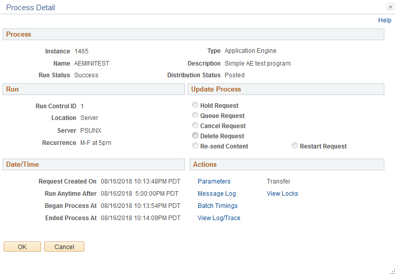

To access the Process Detail page, click the Details link on the Process List page.
Image: Process Detail page
This example illustrates the fields and controls on the Process Detail page.
Process Detail page
Use the Process Detail page to view details, such as request parameters, message logs, and any recovery instances that have been run. Many of the items on this page are display-only. However, you can use some controls to manipulate the program run.
Note: You must click OK to confirm the Update Process request on the Process Detail page.
Process
This display-only group box contains general descriptive information to help you identify the process request, including the run and distribution states.
Run
Field or Control
Definition
Run Control ID and Location
Displays the run control ID and the run location.
Server
Displays the name of the server used, if the process runs on the server.
Note: When the process is in queue status, the name of the requested server is appears.
Recurrence
Displays the recurrence name if this process has a recurring schedule.
Current Step
For Application Engine Process Type only. The Step this Application Engine process is currently executing appears in PROGNAME.SECTION.Step format.
Update Process
The actions that are available in this group box depend on your user authorizations and the current status of the request. This group box is available only if your user ID is authorized to update the selected request.
The option that you select depends on the current run status of the process request. For instance, you cannot cancel a job that has already completed, and you cannot hold a request that is currently processing. The valid actions based on the current status of each process request appear in the following table:
Current Status
Valid Actions
Blocked
Hold, Cancel
Cancelled
Delete
Error
Delete
Hold
Delete, Cancel, Restart
Initiated
Cancel
No Success
Delete
Pending
Hold, Cancel
Processing
Cancel
Queued
Hold, Cancel
Restart
Hold, Cancel
Success
Delete
Warning
Delete
Note: The action Resend Content is available when the Distribution Status for a process is Not Posted.
Date/Time
Field or Control
Definition
Request Created On
Displays the date and time at which the request appeared in the Process Request table (PSPRCSRQST). This is the same as the Start Request field on the Recurrence Definition page.
Run Anytime After
Indicates the date and time at which the user selected File, Run in a PeopleSoft application.
Began Process At
Displays the actual date and time at which the process was selected and initiated.
For server-based requests, a large gap may exist between the Request Created On and Began Process At values because of PeopleSoft Process Scheduler Server Agent sleep time and other server processing activity.
Ended Process At
Indicates the date and time at which the selected process status updated to Success.
Note: If the request fails at initiation, the begin and end times do not appear.
Actions
This group box contains links to other pages, including Parameters, Message Log, Batch Timings, Transfer, and Temp Tables, and View Log/Trace. These pages provide additional details about the process.
Additional information about these actions is provided in the following Viewing Process Detail Actions section of this topic.

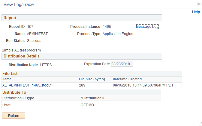

Viewing Log and Trace Files
Click the View Log/Trace link on the Process Detail page to access the View Log/Trace page.
Image: View Log/Trace page
This example illustrates the fields and controls on the View Log/Trace page.
View Log and Trace link
The View Log/Trace page enables you to view the output file, message log and trace file in a browser. The View Log/Trace link appears active on the Process Detail page when at least one of the following conditions is met:
  • The output destination for the process request is Web, and the report and log files were successfully posted to the Report Repository by the Distribution Agent.
    The process must have a run status of Success.
    • If the report has not been transferred to the Report Repository, the run status of the process request remains Processing and the View Log/Trace link is not active.
    • If the status of the request remains Processing, check the message log for messages from the Distribution Agent indicating that problems occurred while transferring files to the Report Repository.
  • The process request ran from a PeopleSoft Process Scheduler Server Agent that was set up using the Server Definition page with a distribution node.
    You must have also selected to transfer log files to the Report Repository when you set up the preferences on this page.
