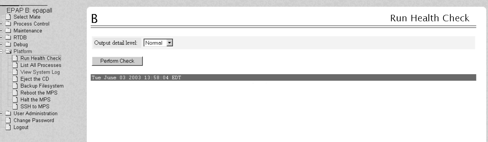

  4. When the GUI shows you are logged into the EPAP about which you want system health information, select Platform > Run Health Check as shown in the following window.
    Figure 3-11 Run Health Check
  5. On the Run Health Check window, use the pull-down menu to select Normal or Verbose for the Output detail level desired.
  6. Click the Perform Check button to run the system health check on the selected server.

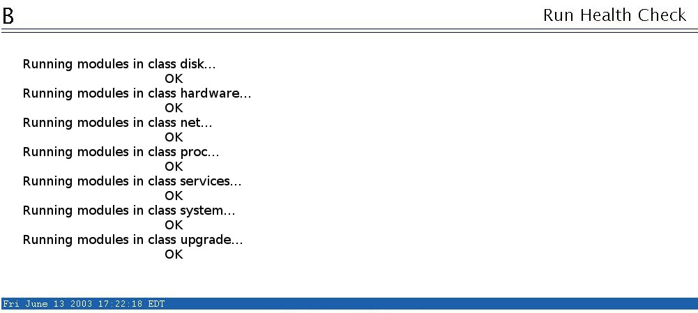

    The system health check output data is displayed. The example shown in Figure 3-12 shows Normal output with errors.
    Figure 3-12 Displaying System Health Check on EPAP GUI
