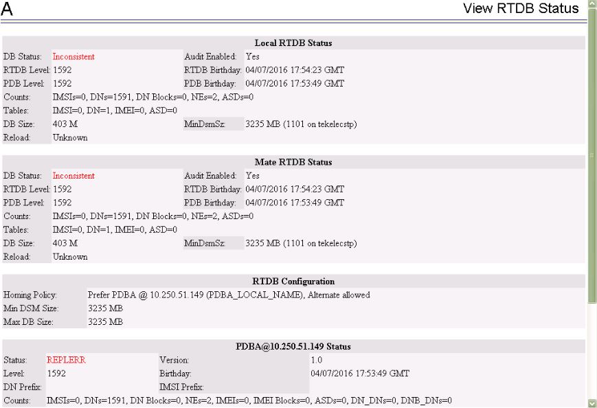

  3. From the menu, select RTDB>View RTDB Status to display status information about the RTDBs.
    Figure 4-3 shows an example of two Inconsistent RTDBs.
    Figure 4-3 Inconsistent RTDB Status
    If one RTDB is inconsistent and the other is coherent in a mated pair setup, proceed to 4. If both RTDBs on an EPAP paired setup are inconsistent, reload from the nearest EPAP site with a coherent RTDB. If all RTDBs are inconsistent, additional steps may be required to reload one RTDB from PDB and backup the new RTDB, then restore the remaining RTDBs.
