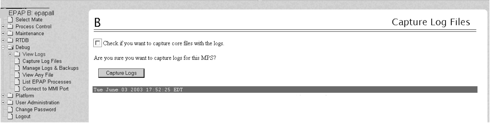

  3. From the menu, select Debug > Capture Log Files.
  4. Deselect (if necessary) the box labeled Check if you want to capture core files with the Logs, as shown in Figure A-11.
    Contact My Oracle Support (MOS) for assistance before capturing core files with the log files.
    Figure A-11 Capture Logs File Screen

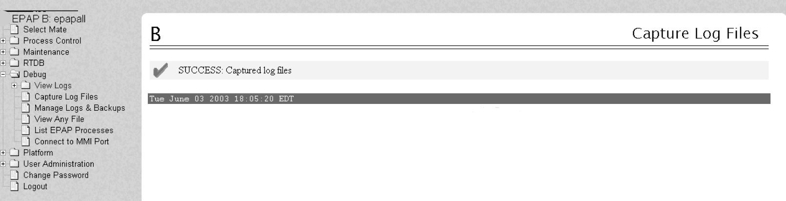

  5. Click the Capture Logs button to capture the log files.
    After completion, verify the following response:
    Figure A-12 Capture Logs Success

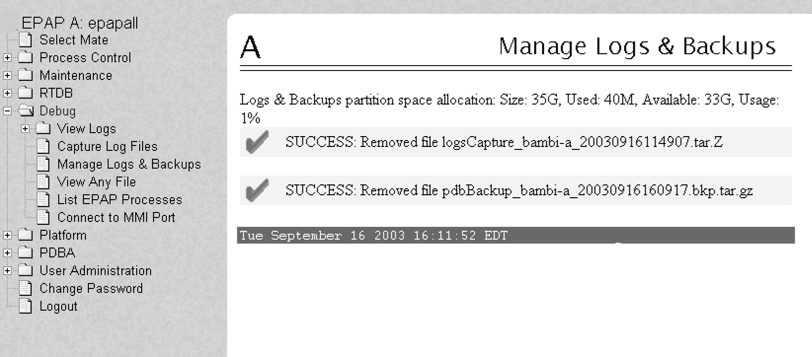

  7. When My Oracle Support (MOS) has finished analyzing the logs files, delete them from the server by selecting Debug > Manage Logs Files and Backups to open the Manage Logs and Backups Screen.
  8. Click the check boxes for the files you want to delete and then click the Delete Selected File(s) button.
    An example is shown in Figure A-13.
    Figure A-13 Deleting Captured Log Files
    When the log files have been deleted, the GUI displays confirmation, as shown in Figure A-14.
    Figure A-14 Delete Log Files Success
