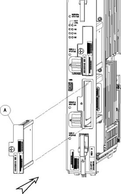

Procedure - Replace Drive Module Assembly
Figure 5-10 Drive Module Replacement

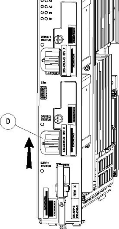

When drive module locking switch (D) is transitioned from unlocked to locked, the LED will flash red to indicate the drive is locked and in process of coming online (see Figure 5-11).
Figure 5-11 Drive Module Locked
