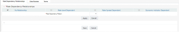

To define a new Maturity Mix Rule, follow these steps:
4.     Select Rate Dependency.
a.     Select the Rate Dependency Relationships tab and enter de-tails as shown in the following table.
Figure 2:   Rate Dependency Relationship Tab of the Maturity Mix Rule
This illustration shows the Rate Dependency Relationship tab of the Maturity Mix window that allows you to select the rate dependency pattern for Ma-turity Mix rule. You must enter the parameter details and click Apply. See the following table for parameter details.
Description of Rate Dependency Relationship Tab of the Maturity Mix Rule as follows
Table 1:  Fields of Rate Dependency Relationship Tab to Create a New Maturity Mix Rule
Fields
Description
There are four Rate Dependency options to select:
·        No Relationship
·        Rate-Level Dependent
·        Rate-Spread Dependent
·        Economic-Indicator Dependent
If any Rate Dependency option other than No Relationship, is selected, the Rate Dependency Pattern drop-down list becomes active. The list of available patterns is limited to those which apply to the selected Rate Dependency Relationship Type.
b.     Click Apply.

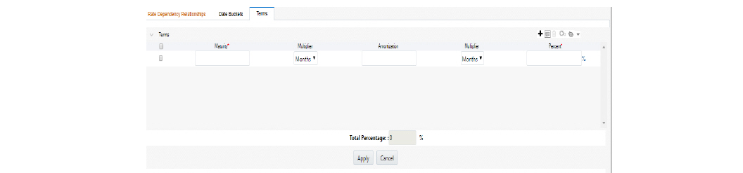

6.     Enter Maturity Mix Assumption details.
a.     Select the Terms tab.
This tab allows you to define the Maturity Term details. You can assign one or more Maturity Terms within the details page, but the sum of the percentage weights must be equal to 100%.
b.     Enter Attribute details as shown in the following table:
Figure 4:   Terms Tab of Maturity Mix Rule Details page
Description of Terms Tab of the Maturity Mix Rule as follows
Table 3: Form Fields of Terms Tab to Create a New Maturity Mix Rule
Fields
Description
Maturity
Defines the Maturity Term.
Multiplier
Maturity multiplier (that is, days, months, years).
Amortization
The Amortization Term will default to the maturity term. The Amortization Term should always be greater than or equal to the maturity term.
Multiplier
Amortization multiplier (that is, days, months, years).
Percent
The percentage of new business at the specified term and maturity for the associated date bucket.
For each Date Bucket defined, the maturity terms must be specified.
c.     Click Apply.
