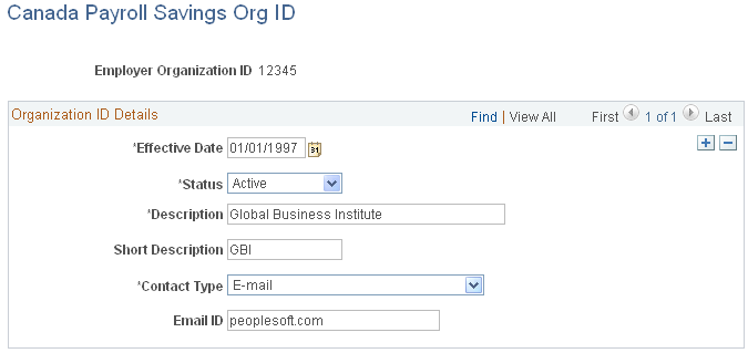

(CAN) Use the Canada Payroll Savings Org ID (Canada Payroll Savings organization ID) page (CPS_ORG_ID_PNL) to specify details about a participating organization.
Image: Canada Payroll Savings Org ID page
This example illustrates the fields and controls on the Canada Payroll Savings Organization ID page.
The information on this page is required to uniquely identify each employer, ensure the secure processing of the employees' contributions, and provide contact information for communications from the Bank of Canada (for example, to confirm file receipt and report the successful completion of batch processing).
Enter the employer organization ID in the entry dialog box. The Bank of Canada assigns this unique, five-digit identification number to participating employers and organizations.
Field or Control
Definition
Contact Type
Specify how you require file transmission confirmations from the Bank of Canada: E-mail, Fax Number, or None.

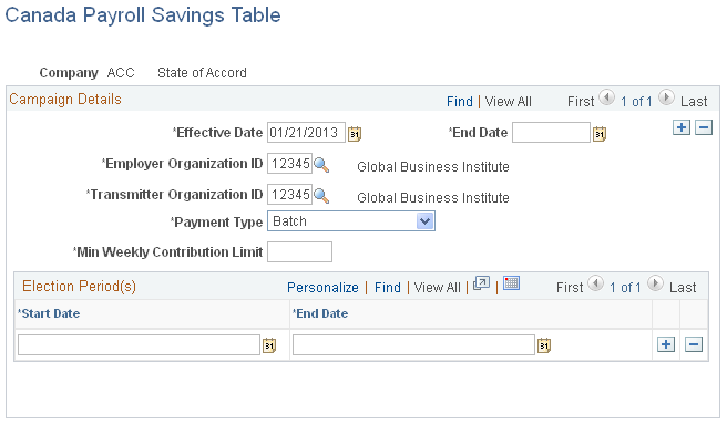

(CAN) Use the Canada Payroll Savings Table page (CPS_CAMPAIGN_DATA) to specify the parameters required to create the electronic data report file for transmission to the Bank of Canada for each campaign.
Image: Canada Payroll Savings Table page
This example illustrates the fields and controls on the Canada Payroll Savings Table page.
Campaign Details
Field or Control
Definition
Effective Date
Enter the date on which the payroll savings contribution period begins for each annual campaign.
End Date
Enter the date on which the payroll savings contribution period ends for each annual campaign.
Employer Organization ID
The ID selected here will identify the company with employees who participate in the plan, as indicated on the plan application forms. This ID will be used by the bank to update their system with purchase information. If you select Batch in the Payment Type field, the company specified here will be responsible for forwarding the contributions to the bank on behalf of their employees.
Transmitter Organization ID
The ID selected here will identify the company that processes the transmission file and transmits the file to the bank, for one or more companies. If you select Transmission in the Payment Type field, the company specified here will be responsible for forwarding the contributions to the bank for every employee in all companies included in the transmission file.
Payment Type
Select:
Batch: To send individual cheques for each batch header record or participating company.
Transmission: To send one cheque for the whole transmission.
Note: Multiple company processing − As one transmission file will be created for each pay run ID, multiple companies sharing the same pay run ID will be reported in one transmission file. The same transmitter organization ID and payment type must be specified for every company participating in a single transmission.
Min. Weekly Contribution Limit (minimum weekly contribution limit)
Enter the minimum limit established by the Bank of Canada for employees paid on a weekly pay frequency. The system uses this value to calculate the minimum contribution limits for employees in all other pay frequencies.
Election Period(s)
Field or Control
Definition
Start Date and End Date
Enter start and end dates for the campaign contribution period. These dates represent the earliest and latest dates on which the system accepts payroll savings contribution change information through the Create General Deductions page.
Note: If you permit changes to employee contribution information for the entire campaign contribution period, enter the campaign effective date in the Start Date field and the campaign end date in the End Date field. You can also define multiple election periods for one campaign contribution period.
