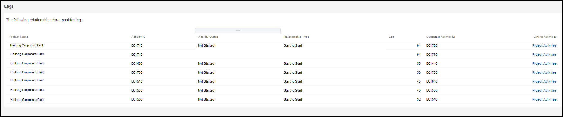

In the above example, the Lags tile was selected in the Assessment Criteria section to display the activities contributing to the delay.
