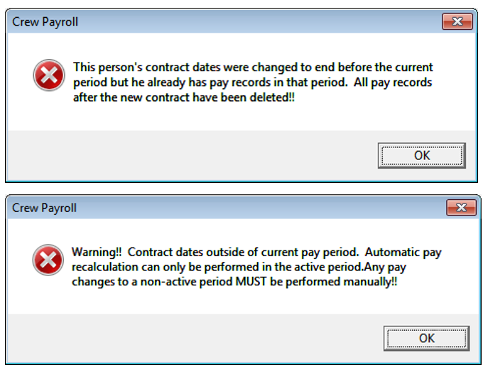

Editing Pay code
Any changes made to the pay codes are immediately stored in the database when the Insert, Update or Delete command buttons are clicked, while changes to the general contract information occur only when you click the Apply or OK buttons.
You will receive a warning message that the pay has to be manually adjusted for the period, when a pay code is removed or the contract dates are changed, so that they are no longer active in the current pay period.
Figure 1-22 Manual Adjustment Error Prompts
Figure 1-23 Contract Pay Code Maintenance
