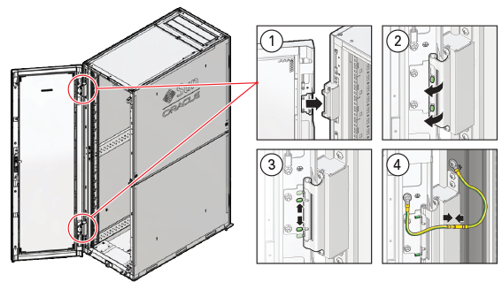

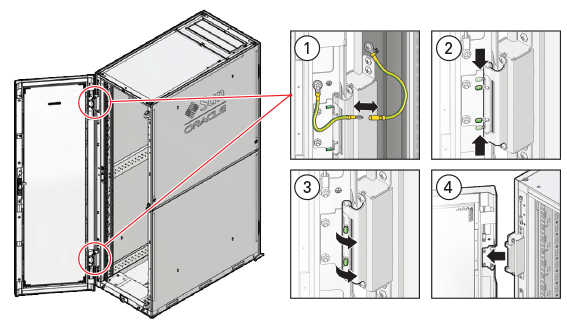

                           Remove the Oracle Private Cloud Appliance front and rear rack doors, as follows: -
                                 Unlock and open the front and rear rack doors.
                                 Detach the top and bottom grounding straps by separating the banana jacks (1).
                                 Unlatch the bottom hinge, then the top hinge. -
                                       Pinch the two studs on the hinge towards the center of the hinge (2).
                                       Rotate the studs away from the door (3) so that they stay in place and the hinge remains unlatched.
                                 Lift the door away from the cabinet (4).
                                 Repeat these steps for the two rear doors.
 These steps are illustrated in Figure 6-1. Caution: The doors are heavy. Have one person hold the door in place while the other operates the hinge latching mechanism. Execute the steps carefully and in the correct order, to avoid damage to the hinges. Figure 6-1 Removing the Rack Doors  Table 6-2 Figure Legend Item Description 1 Detaching the grounding cables. 2 Pinching the hinge studs. 3 Rotating the studs away from the door. 4 Lifting the door away from the cabinet.

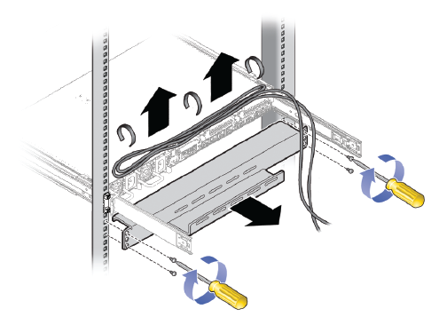

                           Remove the cable tray that holds the pre-installed cables in place at the rear side of the rack. See Figure 6-2 -
                                 Detach the pre-installed cables from the cable tray on the rack unit for the new expansion node.
                                 Use a No. 2 Phillips screwdriver to remove the M6 screws from the cable tray.
                                 Remove the cable tray from the rack. Save cable tray and screws for future use.

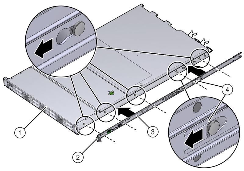

Install Mounting Brackets
Perform the following procedure to install mounting brackets onto the sides of the server.
                           Position a mounting bracket against the chassis so that the slide-rail lock is at the server front, and the five keyhole openings on the mounting bracket are aligned with the five locating pins on the side of the chassis. See Figure 6-3. Figure 6-3 Aligning the Mounting Bracket With the Server Chassis  Table 6-3 Figure Legend Item Description 1 Chassis front 2 Slide-rail lock 3 Mounting bracket 4 Mounting bracket clip
                           With the heads of the five chassis locating pins protruding through the five keyhole openings in the mounting bracket, pull the mounting bracket toward the front of the chassis until the mounting bracket clip locks into place with an audible click.
                           Verify that the rear locating pin has engaged the mounting bracket clip.
                           Repeat these steps to install the remaining mounting bracket on the other side of the server.

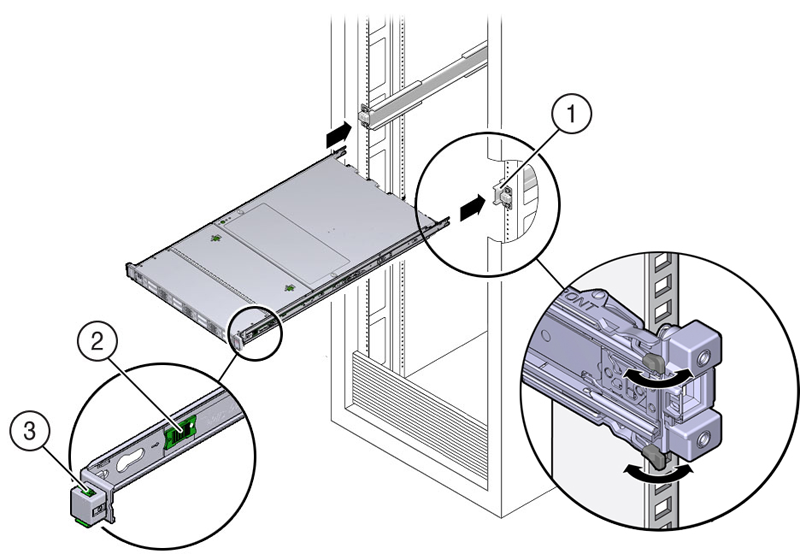

                           Push the slide-rails as far as possible into the slide-rail assemblies in the rack.
                           Position the server so that the rear ends of the mounting brackets are aligned with the slide-rail assemblies that are mounted in the rack. See Figure 6-6.
                           Insert the mounting brackets into the slide-rails, and then push the server into the rack until the mounting brackets encounter the slide-rail stops (approximately 30 cm, or 12 inches). Figure 6-6 Inserting the Server With Mounting Brackets Into the Slide-Rails  Table 6-5 Figure Legend Item Description 1 Inserting mounting bracket into slide-rail 2 Slide-rail release button 3 Slide-rail lock
                           Simultaneously push and hold the green slide-rail release buttons on each mounting bracket while you push the server into the rack. Continue pushing the server into the rack until the slide-rail locks (on the front of the mounting brackets) engage the slide-rail assemblies. See Figure 6-7. You will hear an audible click. Figure 6-7 Sliding the Server Into the Rack

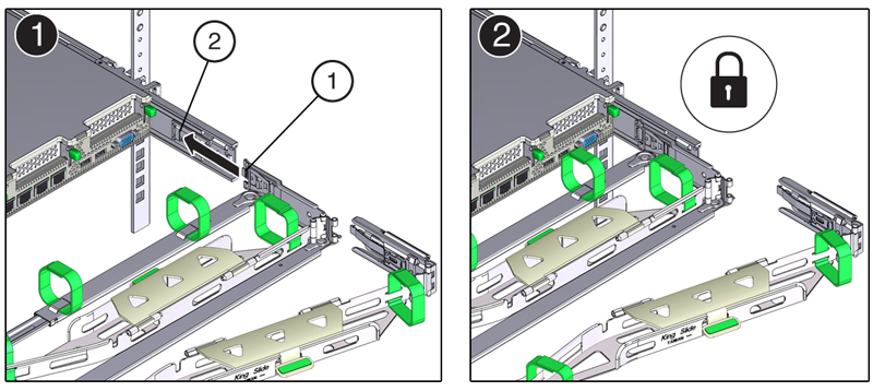

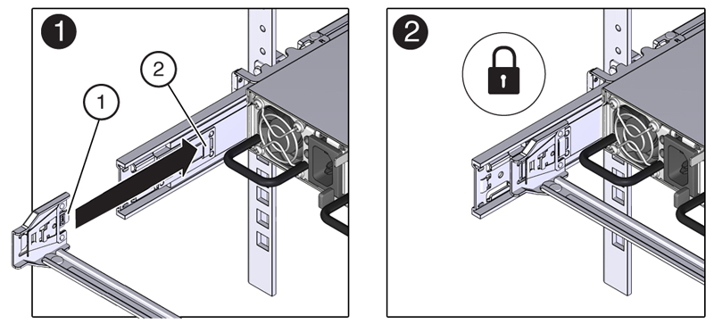

                           Insert the CMA's connector A into the front slot on the left slide-rail until it locks into place with an audible click. See Figure 6-8, frames 1 and 2. The connector A tab (see call-out 1) goes into the slide-rail's front slot (call-out 2). Gently tug on the left side of the front slide bar to verify that connector A is properly seated. Figure 6-8 Installing Connector A Into the Left Slide-Rail  Table 6-6 Figure Legend Item Description 1 Connector A tab 2 Left slide-rail front slot
                           Insert the CMA's connector B into the front slot on the right slide-rail until it locks into place with an audible click. See Figure 6-9, frames 1 and 2. The connector B tab (call-out 1) goes into the slide-rail front slot (call-out 2). Gently tug on the right side of the front slide bar to verify that connector B is properly seated. Figure 6-9 Installing Connector B Into the Right Slide-Rail  Table 6-7 Figure Legend Item Description 1 Connector B tab 2 Right slide-rail front slot
                           To install the CMA's connector C into the right slide-rail, perform the following steps: -
                                 Align connector C with the slide-rail so that the locking spring (call-out 1) is positioned inside (server side) of the right slide-rail. See Figure 6-10, frame 1. Figure 6-10 Installing Connector C Into the Right Slide-Rail  Table 6-8 Figure Legend Item Description 1 Connector C locking spring
                                 Insert connector C into the right side-rail until it locks into place with an audible click (frames 2 and 3).
                                 Gently tug on the right side of the CMA's rear slide bar to verify that connector C is properly seated.
                           To prepare the CMA's connector D for installation, remove the tape that secures the slide-rail latching bracket to connector D and ensure that the latching bracket is properly aligned with connector D. See Figure 6-11, frames 1 and 2. Note: The CMA is shipped with the slide-rail latching bracket taped to connector D. You must remove the tape before you install this connector. Figure 6-11 Aligning the CMA Slide-Rail Latching Bracket With Connector D
                           While holding the slide-rail latching bracket in place, insert connector D and its associated slide-rail latching bracket into the left slide-rail until connector D locks into place with an audible click. See Figure 6-12, frames 1 and 2. Note: When inserting connector D into the slide-rail, the preferred and easier method is to install connector D and the latching bracket as one assembly into the slide-rail. Gently tug on the left side of the CMA's rear slide bar to verify that connector D is properly seated. Figure 6-12 Installing Connector D Into the Left Slide-Rail  Note: The slide-rail latching bracket has a green release tab. This tab is used to release and remove the latching bracket so that you can remove connector D.
                           Gently tug on the four CMA connection points to ensure that the CMA connectors are fully seated before you allow the CMA to hang by its own weight.

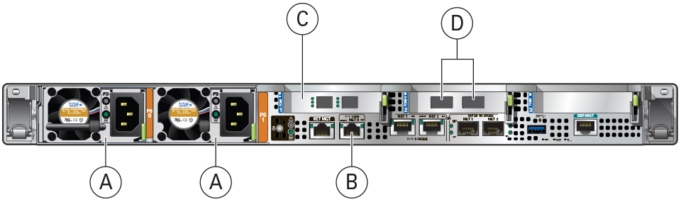

                           Connect the cables to the server, as required. Instructions for connecting server cables are provided in Cable the Server.

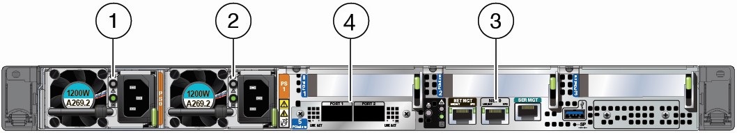

The Oracle Private Cloud Appliance rack is entirely pre-cabled for all components, including future compute nodes. Cable bundles are cable-tied to the correct rack unit for each future server. You should not modify any of the cabling on the already installed components. For detailed cabling information, see Cabling Reference.

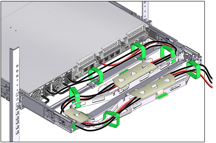

                           Connect the pre-installed power and data cables of the appropriate rack unit to the back of the expansion node. The cables are labeled for your convenience, and should be connected according to the diagram below. Figure 6-14 Oracle Server X8-2 Server Cabling Requirements  Table 6-9 Figure Legend Item Description A Power supplies B NET0 Ethernet port C Optional Fibre Channel HBA Caution: Physical Fibre Channel expansion cards are available as an option for Oracle Server X8-2 or newer compute nodes. The appliance rack does not contain pre-installed Fibre Channel cables. D Internal appliance data network connectors Figure 6-15 Oracle Server X9-2 Server Cabling Requirements  Table 6-10 Figure Legend Item Description 1, 2 Power supplies 3 NET0 Ethernet port 4 Open Compute Project NIC with two x 100 Gbit QSFP ports (PORT 1 and PORT 2)
                           Open the CMA cable covers, route server cables through the CMA's cable troughs, close the cable covers, and secure the cables with the six Velcro straps. See Figure 6-16. -
                                 First through the front-most cable trough.
                                 Then through the small cable trough.
                                 Then through the rear-most cable trough. Note: When securing the cables with the Velcro straps located on the front slide bar, ensure that the Velcro straps do not wrap around the bottom of the slide bar; otherwise, expansion and contraction of the slide bar might be hindered when the server is extended from the rack and returned to the rack. Figure 6-16 CMA With Cables Installed
                           Ensure that the secured cables do no extend above the top or below the bottom of the server to which they are attached; otherwise, the cables might snag on other equipment installed in the rack when the server is extended from the rack or returned to the rack. Note: If necessary, bundle the cables with additional Velcro straps to ensure that they stay clear of other equipment. If you need to install additional Velcro straps, wrap the straps around the cables only, not around any of the CMA components; otherwise, expansion and contraction of the CMA slide bars might be hindered when the server is extended from the rack and returned to the rack.

                           Reconnect all grounding straps on all doors (4).
                           Close the doors. Optionally, lock the doors.
Caution:
Figure 6-17 Installing the Rack Doors
Table 6-11 Figure Legend
| Item | Description |
| 1 | Lifting the door into place. |
| 2 | Rotating the hinge studs away from the center. |
| 3 | Pins on the latching mechanism snap into place. |
| 4 | Attaching the grounding cables. |
