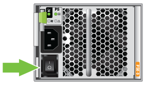

                           Make sure that the circuit breakers located on the rear left and right side power supplies of the Oracle ZFS Storage Appliance ZS7-2 are in the ON (|) position. Figure 5-4 Oracle ZFS Storage Appliance ZS7-2 Circuit Breakers

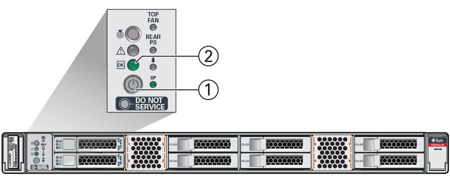

                           Press the Power button located on the front of the first (bottom) management node. See Figure 5-5. The first management node is located in rack unit 5 (U5). The second management node is located in rack unit 6 (U6). It is switched on and configured automatically during the initial power-on sequence. A management nodes take approximately five to ten minutes to power on completely. Once complete, the Power/OK LED illuminates and remains a steady green. Figure 5-5 Oracle Private Cloud Appliance Management Node  Table 5-2 Figure Legend Item Description 1 Power button 2 Power/OK LED
                           After powering on the first management node, wait while the second management node and all compute nodes are powered on and discovered. Note: After power is applied, the LEDs on all compute nodes and storage server heads will start to blink after approximately two minutes. From the rear of the rack, you can see the green LEDs on the power supply units (PSUs) on the compute nodes turn on instantly after power is applied. In addition, from the rear of the rack, you can see the display on the power distribution units (PDUs) illuminate once power is available. The management nodes will verify all components within the system. The management nodes ensure that the correct networking switches and storage devices are installed in the system, and search for compute nodes to add to the compute fabric. Once compute nodes are located, the management software automatically installs the proper drivers and the Oracle VM Server version on each compute node. Depending on your system configuration, the Oracle Private Cloud Appliance power-on process should take approximately five to ten minutes before the system becomes available for initialization, and up to several hours for the entire configuration to be ready. When initialization is completed, use the Oracle Private Cloud Appliance Dashboard web interface to configure initial system settings (for example: network properties and passwords). For instructions on connecting to the Oracle Private Cloud Appliance and accessing the Dashboard UI, see Connect the Appliance to the Network.

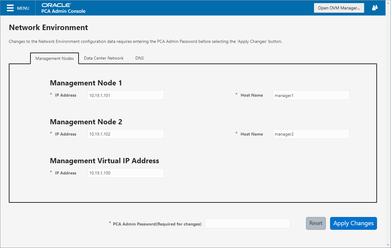

                                 In the Management Nodes tab, enter the IP addresses and host names for both management nodes. Note: During the initial configuration of the Oracle Private Cloud Appliance, you change the predefined configuration IP address to the reserved virtual IP address in your data center network. For details, see General Network Configuration. Figure 5-6 Management Nodes Tab

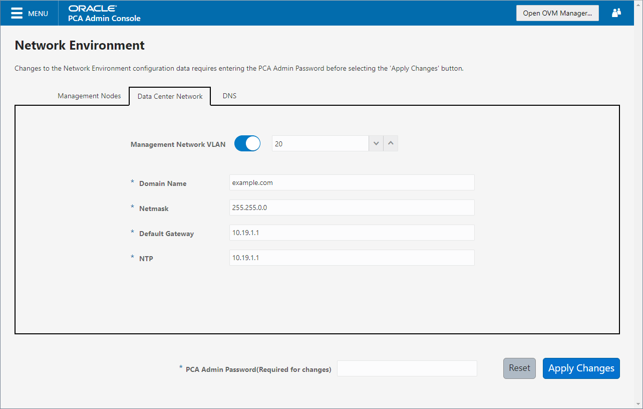

                                 In the Data Center Network tab, enter the domain name, netmask, default gateway and NTP server of the network to which the appliance must be connected. If this network is a VLAN, set the slider to active and enter the VLAN ID in the field next to it. Figure 5-7 Data Center Network Tab

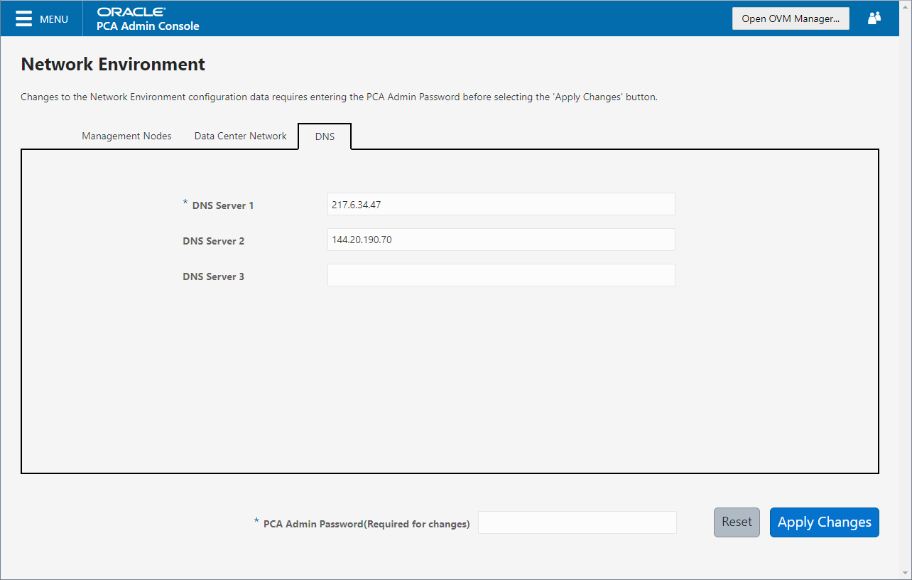

                                 In the DNS tab, enter at least one and up to three name servers for the network to which the appliance must be connected. Figure 5-8 DNS Tab
