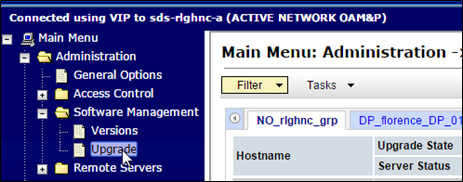

  1. Access the primary SDS NOAM GUI, use the VIP address to access the primary SDS NOAM GUI as described in Access the OAM GUI Using the VIP (NOAM/SOAM).

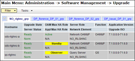

  2. In the Primary SDS NOAM VIP, verify status and application version. Expand Administration select Software Management click Upgrade. Select the Server Group tab for the server(s) to be upgraded.
    Figure 13-1 Upgrade
    Upgrade
  3. Verify the Upgrade Status displays as Ready for the server(s) to be upgraded. Verify the Application Version for the server(s) is the source software release version.

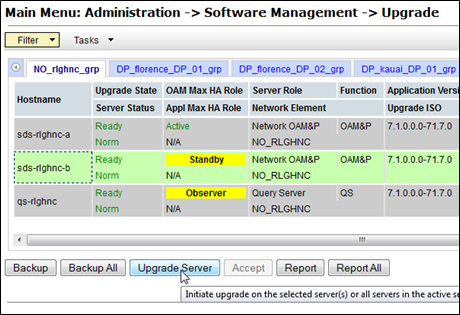

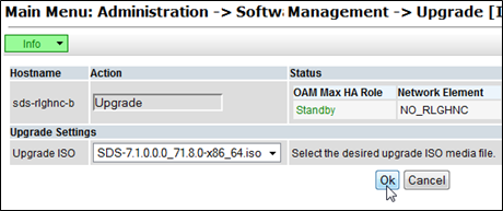

  5. Execute this step for single server (or multi-selected) upgrade only. In the Primary SDS NOAM VIP, upgrade server(s). Press and hold the Ctrl key to select multiple servers that need to be upgraded. Click Upgrade Server.
    Figure 13-3 Upgrade Server
    Upgrade Server
  6. Select the Upgrade ISO file to use for the upgrade. Click OK.
    Figure 13-4 OK
    OK

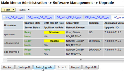

  7. Execute this step for Server Group Auto Upgrade only. Do not use the Auto Upgrade option when upgrading the primary SDS NOAM server group. In the Primary SDS NOAM VIP, upgrade servers. Click Auto Upgrade. Do not select any servers with this option.
    Figure 13-5 Auto Upgrade
    Auto Upgrade

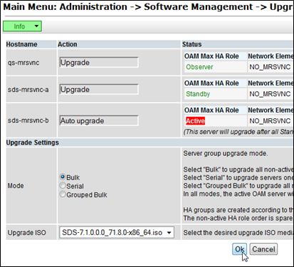

  8. Select the Bulk option. Select the Upgrade ISO file to use for the upgrade. Click OK.
    Figure 13-6 Upgrade ISO
    Upgrade ISO
    All non-active servers are upgraded first (for example, standby, query, so on).
    During the server upgrade, multiple alarms are expected and can be safely ignored. These include but are not limited to Event IDs: 10009, 10073, 10075, 31101, 31102, 31106, 31107, 31109, 31114, 31225, 31282 and 31283. These alarms may display until all the NOAM and DR-NOAM servers upgrade has been completed.
    If Alarm 10009 persists after the upgrade, reboot the server once using the sudo init 6 command on the effected server.

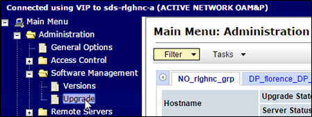

  13. Access the primary SDS NOAM GUI, use the VIP address to access the primary SDS NOAM GUI as described in Access the OAM GUI Using the VIP (NOAM/SOAM).
  14. In the Primary SDS NOAM VIP, monitor status expand Administration select Software Management click Upgrade.

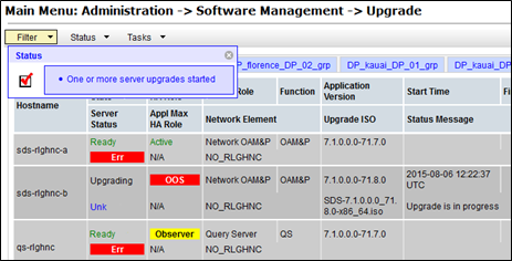

  15. Monitor the Upgrade State and the Status Message for the servers being upgraded.
    Figure 13-9 Upgrade State
    Upgrade State
    As the upgrade executes, the following states can be observed:
    Table 13-1 Status Message
    Sequence Upgrade State Status Message
    1 Pending Pending upgrade
    2 Preparing Upgrade task started
    3 Validating Validating upgrade ISO image
    4 Upgrading Upgrade is in progress
    5 Rebooting Warn: failed to get TPD task state, server could be rebooting
    6 Not Ready Success: Upgraded server to new ISO
    7 Accept of Reject Success: Server upgrade is complete
    Some states may transition faster than the screen refresh rate and appear to skip.
