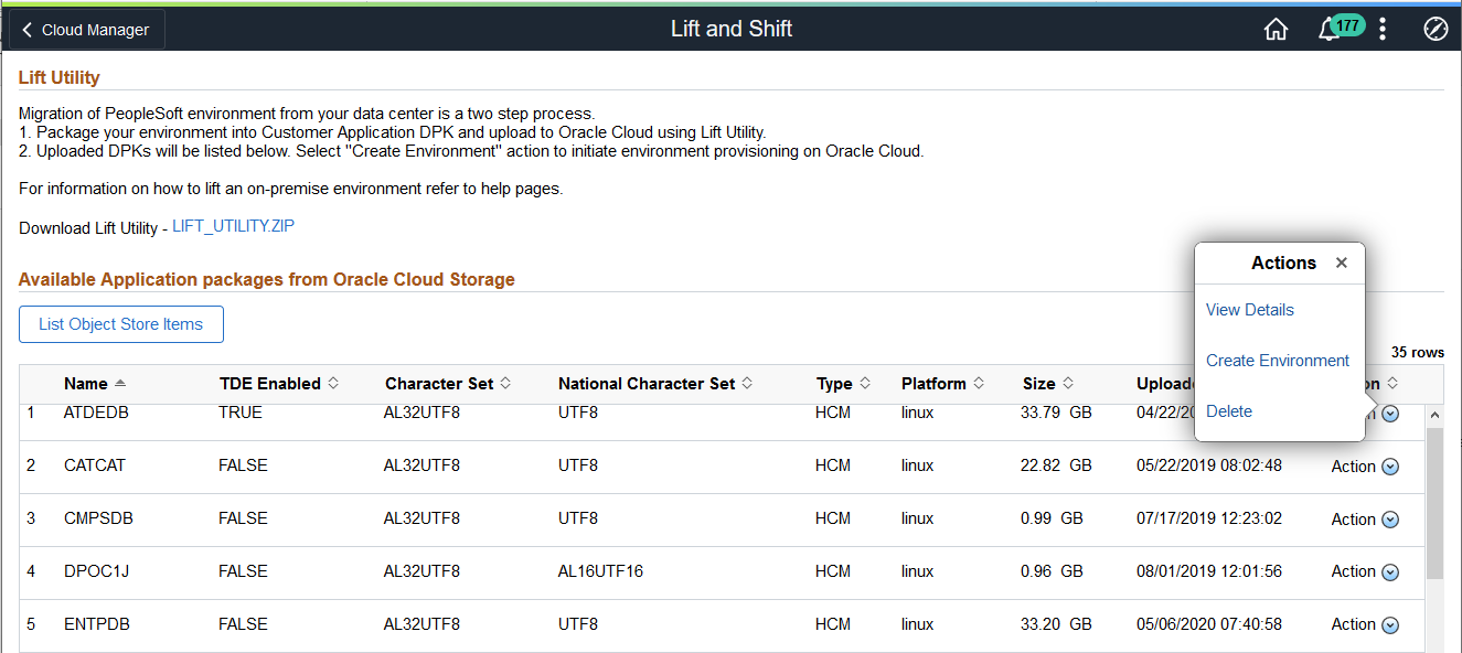

Once an environment is lifted, it will be available on the Lift and Shift page. Click the List Object Store Items button to view all items.
This example illustrates the fields and controls on the Lift and Shift page. You can find definitions for the fields and controls later on this page.
Lift and Shift page
For description of this page see Lift and Shift Page
Lift and Shift actions:
Field or Control
Description

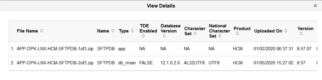

View Details
Click to verify the lift details. The type of the DB zip file (2of3.zip or 2of2.zip file) will be db_rman.
Create Environment
Click to Shift the environment.
See Lift and Shift – Create Environment Wizard.
Delete
Click to delete.
This example illustrates the fields and controls on the View Details page, showing the type as db_rman for the database zip file.
View Details

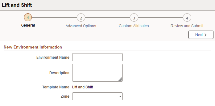

Environment Name
Enter the name of the environment which you want to create.
Note: Length of environment name and identity domain name should not exceed 25 characters.
Description
Enter a description for the environment.
Template Name
Displays the default template to be attached with the environment.
Zone
Select the zone on which the environment should be created.

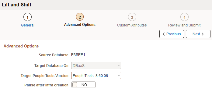

Use the Lift and Shift – Advanced Options page (ECL_LAS_ADV_FL) for defining target database details.
Navigation:
Click step 2 or Next at the top of the Lift and Shift guided process.
This example illustrates the fields and controls on the Lift and Shift – Advanced Options page. You can find definitions for the fields and controls later on this page.
Lift and Shift - Advanced Options page
Field or Control
Description
Target Database On
Select the Target Database On (Compute or DBaaS).
Note: For TDE enabled environments, Target Database On is DBaaS, which cannot be changed.
Target PeopleTools Version
Select the PeopleTools version to be applied on the environment.
Pause after infra creation
Select Yes for the environment provisioning to pause after completion of the Infrastructure task. This provides the user the opportunity to do additional setup, actions, or operations on the newly created environment outside of Cloud Manager before proceeding with the PeopleSoft deployment.
Note: When you are ready to proceed to the PeopleSoft deployment, select Deploy from the related actions on the Environment tile.
Select No (default) to continue provisioning the environment when the infrastructure layer is complete.

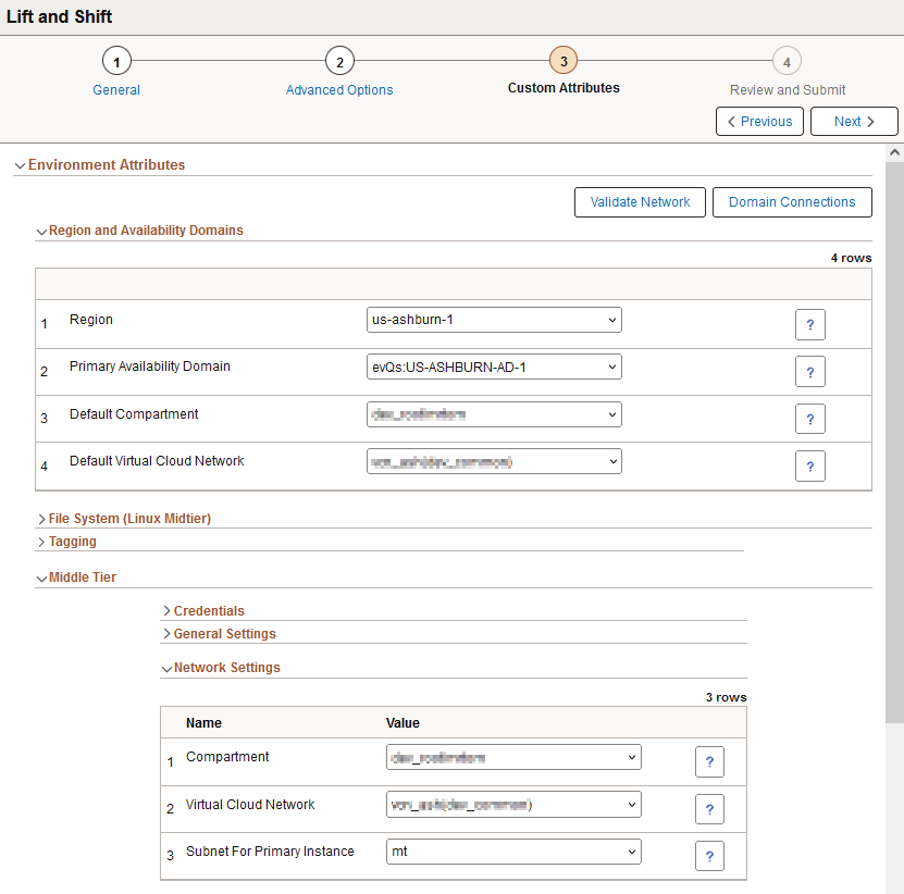

Use Lift and Shift – Custom Attributes page for defining the custom attributes as per the lifted environment.
Navigation:
Click step 3 or Next at the top of the Lift and Shift guided process.
Enter the custom attributes as per the lifted on-premises environment. It is recommended that the custom attribute values entered on this page match the on-premises configuration.
For details on custom attributes, see Managing Environment Attributes.
This example illustrates the fields and controls on the Lift and Shift – Region and Availability Domains and the Middle Tier Network sections.
Lift and Shift - Region and Availability Domains
The values in the Network Settings section default to the compartment and VCN in the Region and Availability Domains section; these values can be changed for each tier.
See Configuring Region and Availability Domains, Configuring Network Settings, and Configuring Domain Connections section in Creating An Environment.

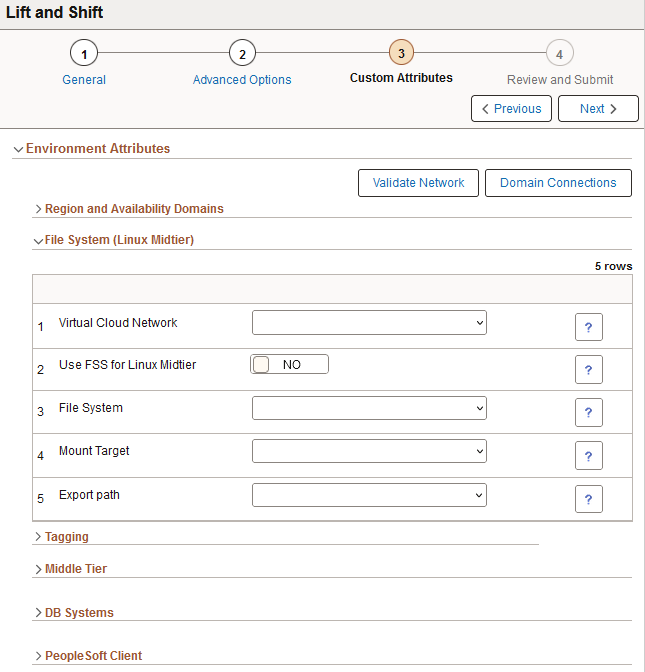

File System (Linux Midtier) Section
This example illustrates the fields and controls on the Lift and Shift – File System (Linux Midtier) section.
Lift and Shift - File System (Linux Midtier) section
See Using Shared File System for Linux Middle Tier using File Storage Service for a description of the fields and controls.

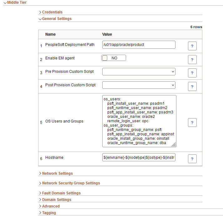

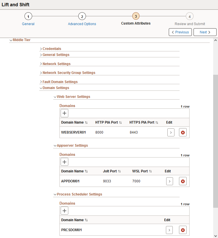

Middle Tier Section
This example illustrates the fields and controls on the Lift and Shift - Middle Tier section.
Lift and Shift - Middle Tier General Settings section
The fields and controls for Middle Tier are described in Configuring Web Server Tier Settings.
This example illustrates the fields and controls on the Lift and Shift – Middle Tier Domain Settings.
Lift and Shift - Middle Tier Domain Settings
See Domain Settings Section in Configuring Full Tier Template Settings for field definitions and controls.

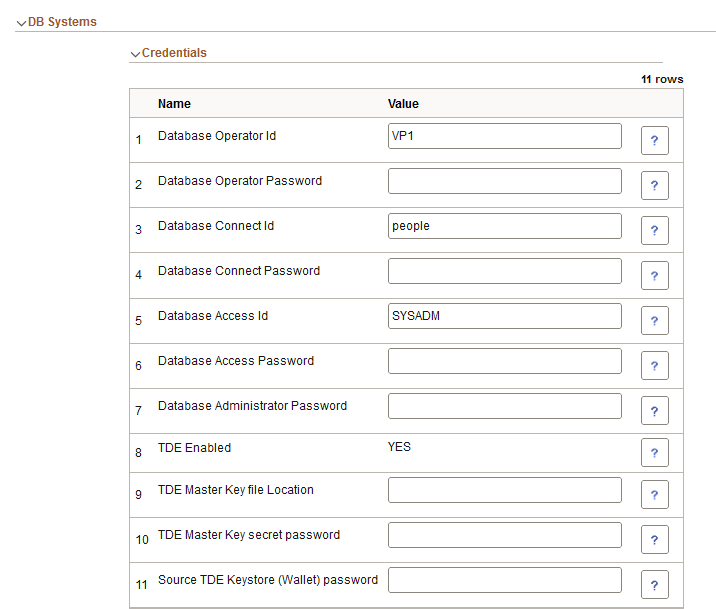

DB Systems Section
The DB Systems section fields change depending upon the database.
The fields and controls for the DB Systems section are described in Configuring DB Systems Settings.

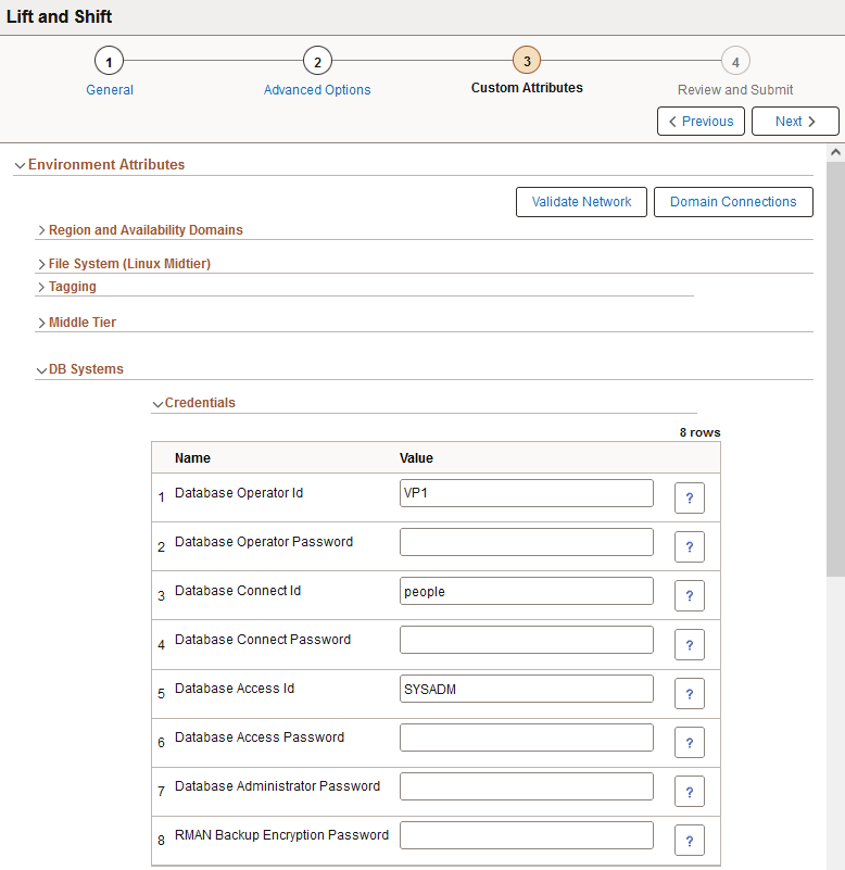

This example illustrates the fields and controls on the Lift and Shift – DB Systems Credentials section for a TDE-enabled database.
Lift and Shift - DB Systems Credentials section
The fields and controls for TDE-enabled databases are described in Shifting TDE Encrypted Database.
This example illustrates the fields and controls on the Lift and Shift – DB Systems Credentials section with RMAN password.
Lift and Shift - DB Systems Credentials sedtion with RMAN password
Note: When creating a new shifted environment of a lifted RMAN backup, you must provide a different CDB name than the CDB name of the source database on which the RMAN lift was performed. The shift will fail if the same CDB name is used.
See also Running Lift Using Hot Backup (RMAN).

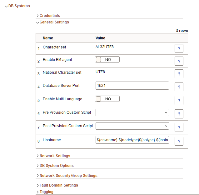

This example illustrates the fields and controls on the Lift and Shift – DB Systems General Settings section.
Lift and Shift - DB Systems General Settings section
See Configuring DB Systems Settings.
Character Set Attributes
The Character Set and National Character Set attributes are configured with the same values as the on-premises database configuration.
The database character sets to be used for the Shift operation are AL32UTF8 and National Character Set AL16UTF16. Possible values of National Character Set when character set is AL32UTF8 are AL16UTF16 and UTF8. There can be multiple possible values of character set such as UTF8 WE8ISO8859P15. If shifting to DBaaS, you need to modify the character sets based on the database selected.
If you are using Cloud Manager to initiate a DBCS Shift; the “DBaaS Charset” and “DBaaS National Charset” configuration (under the Database Tier section) should match with the “Charset” and “National Charset” of the Database environment where the DB Lift operation is performed.
If there is any mismatch in the Charset data, the DBCS shift will fail.
To find the Charset and National Charset information from the lifted environment, run the following SQL commands on the DB (lifted) environment.
select VALUE from nls_database_parameters where parameter='NLS_CHARACTERSET';
select VALUE from nls_database_parameters where parameter='NLS_NCHAR_CHARACTERSET';

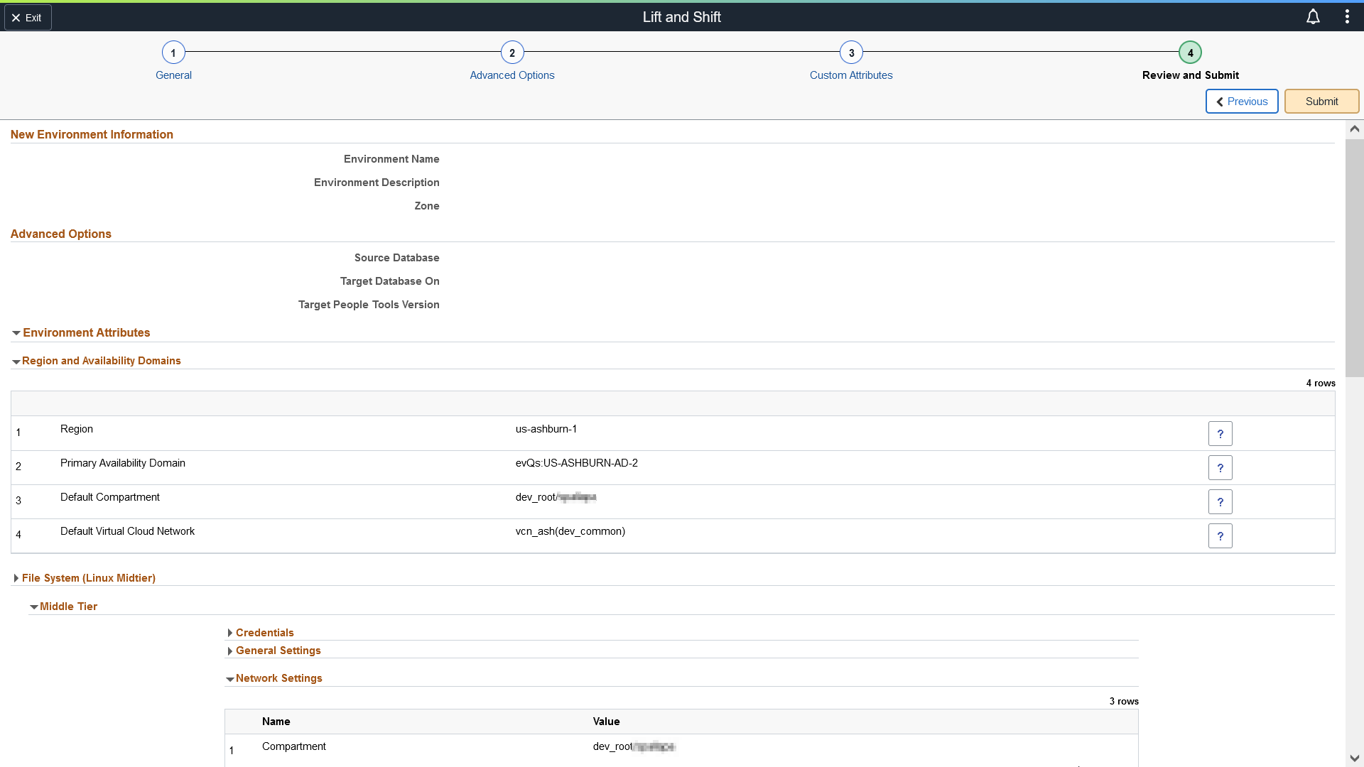

Use the Lift and Shift – Review and Submit page (ECL_LAS_CUSTATR_FL) to review and submit the entered environment details.
Navigation:
Click step 4 or Next at the top of the Lift and Shift guided process.
This example illustrates the fields and controls on the Lift and Shift – Review and Submit page.
Lift and Shift - Review and Submit page
Review the details that were entered for the environment.
Click the Submit button to initiate the creation of a lifted environment in Oracle Cloud based on the details provided.
Once the environment is ready, you will be able to view it under the Environments tile. For details, see Environments Tile
