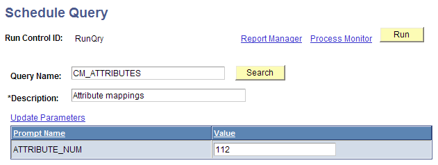

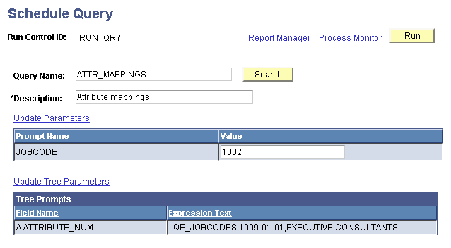

A process request enables you to submit a job or process to run. The Schedule Query page submits a process request and brings up the Process Request page, which enables you to specify such variables as where to run the process and in what format to generate the output based on a run control ID.
This example illustrates the fields and controls on the Schedule Query page.
To submit a process request:
Select
Search for and select an existing run control ID, or select the Add New Value tab to enter a new ID.
Select the query for which you want to schedule and update any prompt parameters.
Optionally, select an option in the Asian Font field.
The Asian Font field is available if the output format is set to PDF with Asian fonts.
If the output format is set to PDF, you are able to run queries to PDF outputs with all Western European fonts, Korean font, Japanese font, Traditional Chinese font, and Simplified Chinese font. Alternatively, use BI Publisher to run queries to PDF outputs with Eastern European fonts, Thai fonts, Russian fonts, and so on; or change the output to another format.
Use the Update Parameters link to select or change the value that is required for each available prompt. When values have been selected, they appear in the Prompt Name and Value fields.
Note: If the query does not have any prompt, the Update Parameters link does not appear.
If you have one or more Asian languages installed, select the language that you want from the Asian Font drop-down list. This drop-down list appears only if you have one or more Asian languages installed.
You are unable to open or schedule a query that has been disabled.
Click the Save button to save changes and remain on the Schedule Query page.
Click the Run button to submit the query process request and display the Process Scheduler Request page.

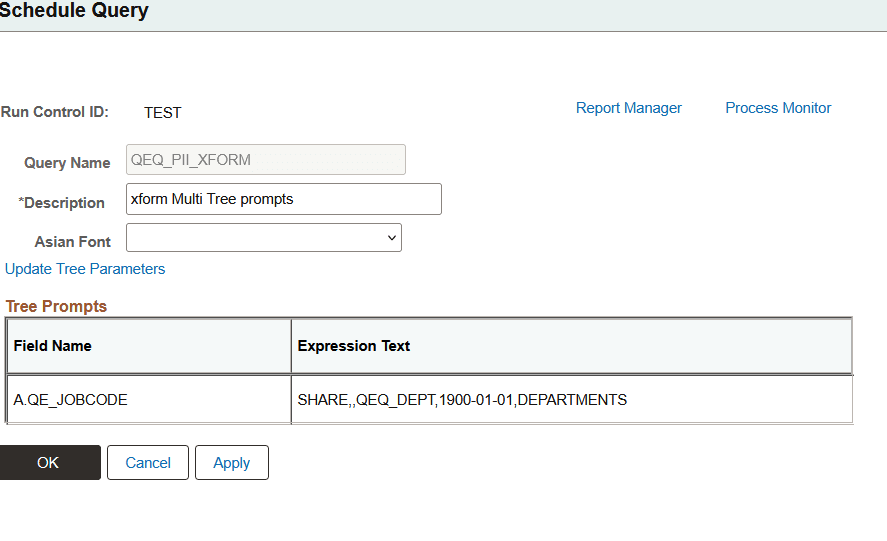

Schedule Query with Tree Prompt
You can schedule queries that have tree prompts using the Schedule Query component or using the Schedule links in the Query Manager and Query Viewer. While scheduling these queries, you are prompted for selecting the tree for the specified field and its node list. After the successful selection of values for the tree prompts, other prompts are available for your input. These queries can either be saved and used in the future or can be scheduled and run immediately by clicking the Run button.
This example illustrates the fields and controls on the Schedule Query page with query that has In Tree prompts. Definitions for the fields and controls appear following the example.
Field or Control |
Description |
Update Tree Parameters |
The Update Tree Parameters link is available if you are running queries that have tree prompts. Click this link to access the Select a Tree page and the Select Tree Node page, where you can select a tree and its node list. |
Tree Prompts |
The Tree Prompts section displays the field names and expression texts, which will be used in forming the SQL before running the query. |

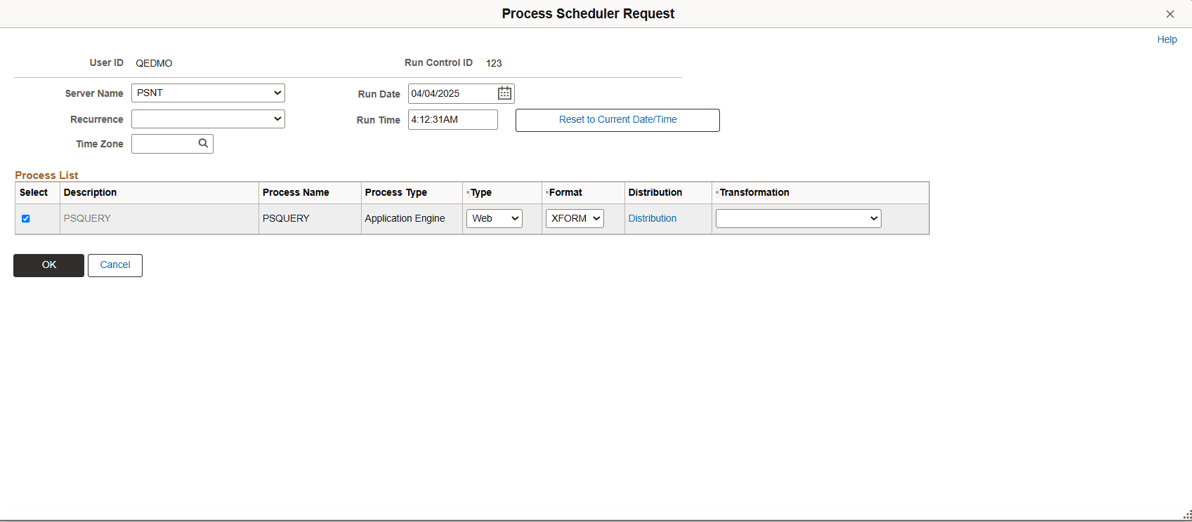

To generate the query results with transformation and distribute that resulting data, you schedule the query process to run using the Process Scheduler Request page and select XFORM as the output format.

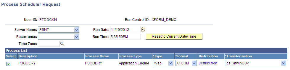

The following example shows the fields and controls on the Process Scheduler Request page when you generate the query results with transformation.

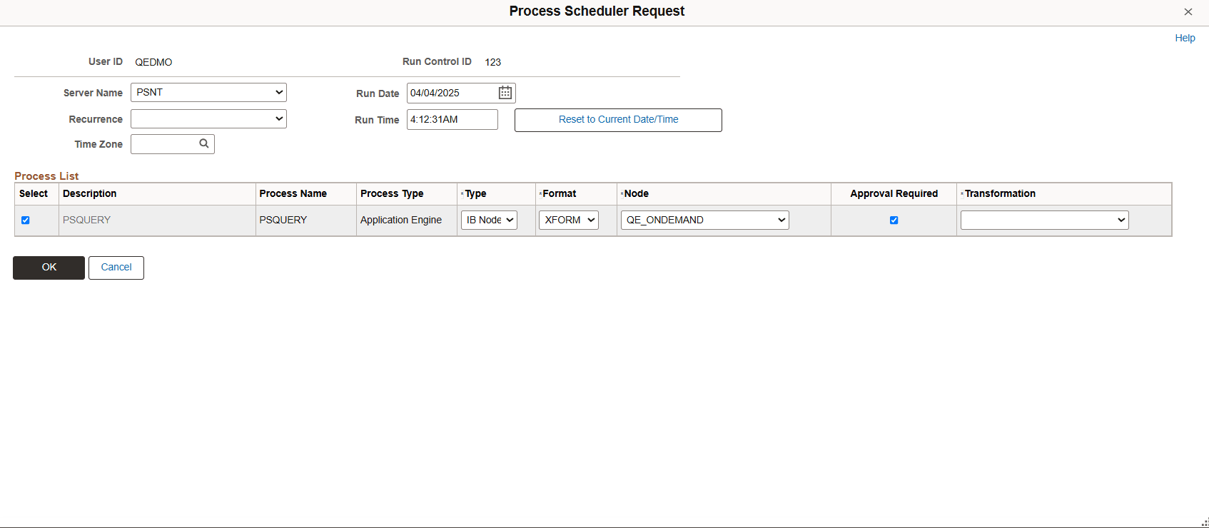

To generate the query results with transformation and distribute that resulting data to an external IB node using the Integration Broker framework, you schedule the query process to run using the Process Scheduler Request page, set the output type to IB Node, and set the output format to XFORM. The page also includes the Approval Required option that enables you to review and approve the transformed output before distributing it.
The following example shows the fields and controls on the Process Scheduler Request page when you generate the query results with transformation and distribute that resulting data to an external IB node using the Integration Broker framework. Definitions for the fields and controls follow the example.
Field or Control |
Description |
Type |
The available options are:
Format |
The available options are HTM, PDF, TXT, XFORM, XLS, XML, and XMLP. Note: If the output type is set to Feed, the only available format is ATOM and the Transformation drop-down list is not available. ScheduledQuery-CSVUnicodeEncoding setting applies only when OutputUnicode property of query class is set to True and scheduled query is set to ‘TXT’ format. It is not a required setting. If it is not set, the CSV output encoding will be UCS2 with BOM. See PSTools Section If the output type is set to IB Node:
Node |
This option is available when the Type column is set to IB Node. Select an IB node from the list of the external IB nodes, which were enabled to receive the transformation output with the routing added to receive the delivered Query Transform Server Operation. Note: To enable an IB Node to receive the query and connected query transformed outputs, you must add a routing for Service Operation PRCS_OUTPUT_IB_OPER. This routing enables the node to be an output destination for the transformed outputs. |
Approval Required |
This option is available when the Type column is set to IB Node. Select to request that the transformed output file be reviewed and approved before you distribute its output data to external destinations. If the Approval Required option is selected, then at report runtime:
If the Approval Required option is not selected, then at report runtime:
Transformation |
This option is available when the Format column is set to XFORM. This option is required for generating customized output. Select a transformation option from the list of valid XSLTs that were previously defined for the selected query. The selected transformation will determine the XSLT to be applied to the query XML data. |

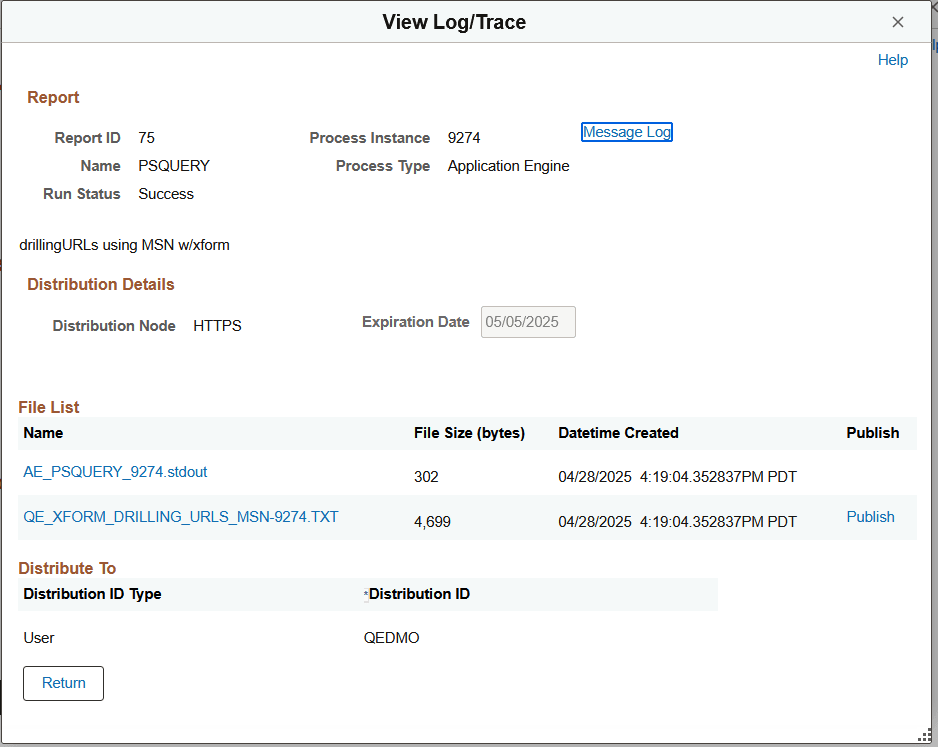

To review and publish the transformed output files:
Access the Process Monitor page.
Click the Details link to access the Process Detail page.
Click the View Log/Trace link to access the View Log/Trace page.
If the process has the run status of Success and the distribution status of Pending, then the Publish link appears next to the request output.
This example shows the View Log/Trace page with a list of the output files and the Publish link.
Optionally, review the output file by clicking the Name link in the file List section.
Click the Publish link to send the output to the request Integration Broker node, which is defined in the Process Scheduler Request page.

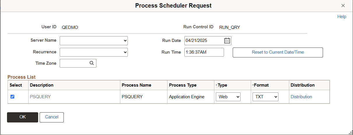

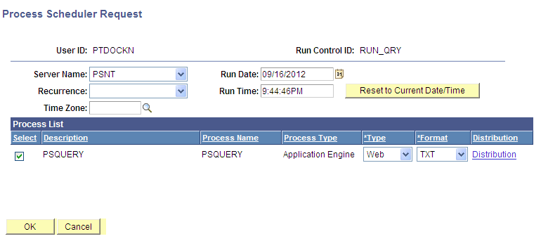

The Process Scheduler Request page enables you to set the server, run date and time, how often the process runs (the recurrence of the process), output type, and format.
This example illustrates the fields and controls on the Process Scheduler Request page. Definitions for the fields and controls appear following the example.

To select a process request:
Select
Select a run control ID, and click the Run button.
The Process Scheduler Request page appears.
Complete the fields on the Process Scheduler Request page.
Click the OK button to run the query.

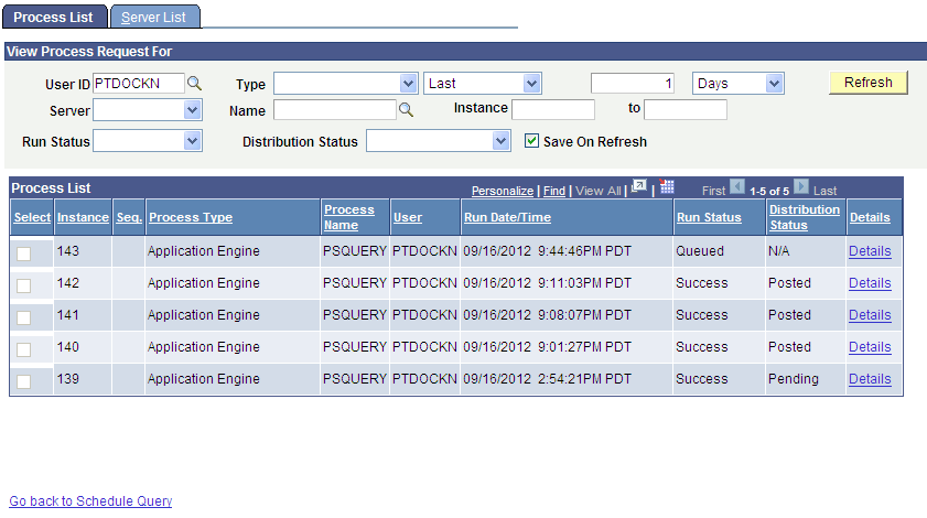

Click the Process Monitor link to view the status of your request.
The Process List page appears. The Run Status field reveals the status of your scheduled or running process.

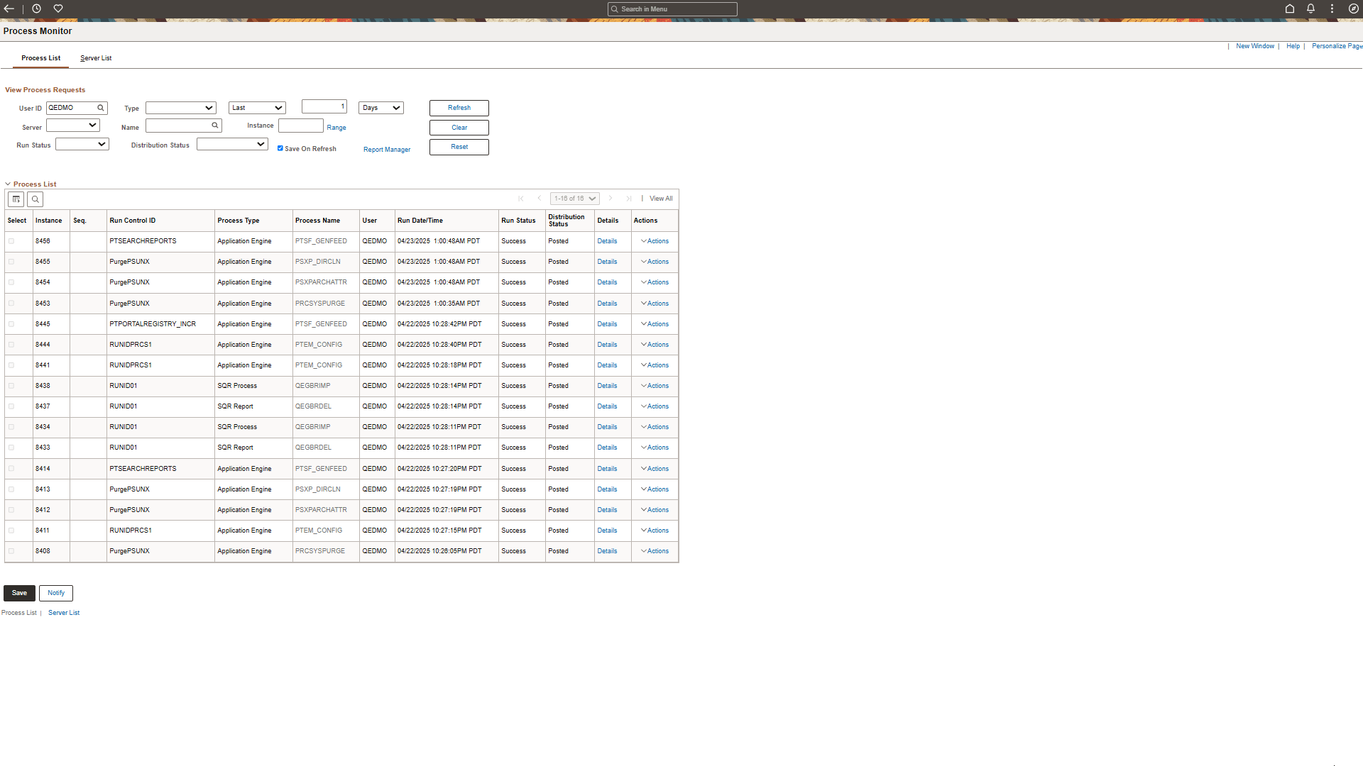

The Process Monitor can be used to view the status of your process requests.
You can access the Process Monitor by clicking the Process Monitor link on the Schedule Query page or by selecting
Process Monitor consists of two pages: the Process List page and the Server List page.
The Process List page enables you to monitor the process requests that you have submitted.
You can select filtering options—for example, process type and run status—to view only selected process requests. And you can click the Details link to view details that are associated with particular process requests.
The Server List page enables you to monitor the PeopleSoft Process Scheduler server agents within your system.
This example illustrates the fields and controls on the Process Monitor - Process List page. Definitions for the fields and controls appear following the example.
Field or Control |
Description |
User ID |
View the processes that were submitted by a particular user ID. Usually, you view by your own user ID. |
Type |
View by a particular process type—for example, Application Engine. |
Last |
Specify an interval of time by which to limit the process requests that appear in the list. Enter a numerical value in the edit box preceding the drop-down list, and then select a unit type from the drop-down list. Values are Days, Hours, and Minutes. |
Refresh |
Click to check the current status of a process. This button refreshes the list. |
Server |
Select to view processes that run on a particular server. |
Name |
View processes by a process name. |
Instance |
Specify a range of instances by which to limit the process requests that appear in the list. To limit the view to a single request, enter the required instance ID in the first text field. |
Run Status |
Select if you want to view processes by a specific status, such as Success or Error. |
Distribution Status |
Displays the distribution status for each individual job and process. Valid statuses are N/A, None, Generated (OS390), Not Posted, Posting, Pending, and Posted. |
Save On Refresh |
Select to save filter criteria changes when you click the Refresh button. |
Instance |
Displays the process instance, that is, the order in which the process appears in the queue. This number is automatically generated. |
Seq (sequence) |
This field is blank; it is not used for query processes. |
User |
The ID of the user who submitted the process. |
Details |
Click to open the Process Detail page. |

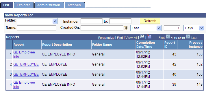

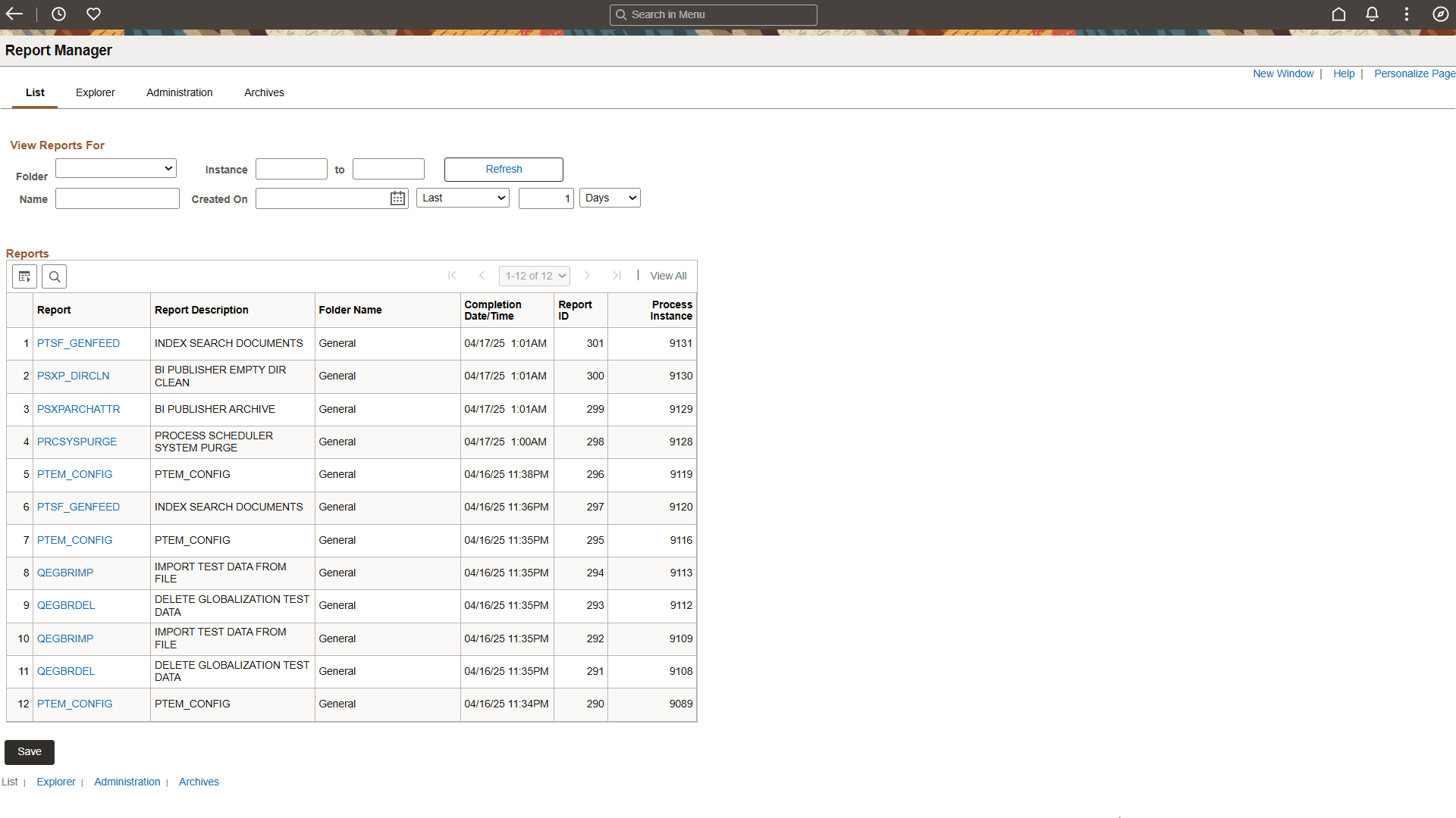

Report Manager is like your own personal in-box of reports and process output. It provides a secure way to view report content, check the posting status of your output, and see content detail messages.
You can view all of your reports by opening your Report List in your browser.
To access the Report Manager, select or click the Report Manager link on the Schedule Query page.
This example illustrates the fields and controls on the Report Manager - List page.
