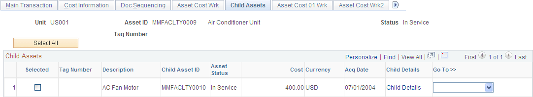

CHILD_ASSETS |
Select child assets to include in the transfer or recategorization that you have initiated against the parent assets. |

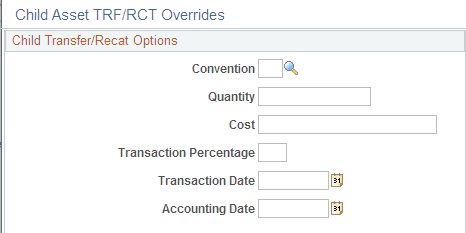

AM_PARCHD_TRF_RCT |
Specify transaction overrides for a specific child asset. You can specify specific convention, quantity, cost, transaction percentage, transaction date and accounting date for the child asset on this page. |
FULL_PART_SEC |
Specify transaction overrides for all child assets at once. |

Select some, none, or all child assets to include in the transaction that you are performing. The Child Assets page appears only when the asset you are transacting against is a parent asset and the transaction type is a transfer. A separate Application Engine process is provided for transferring parent-child assets between business units.
Note: Adjustments to parents do not automatically filter down to the child assets; therefore, the Child Asset page does not appear for adjustments. Instead, add another child asset. A reminder message will appear stating that child assets are associated with the parent asset that you are adjusting.

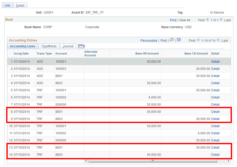

Use the Create Accounting Entries run control page to generate accounting entries from the Federal Fund Transfer accounting entries.
The following is an example of generated Federal fund transfer accounting entries as viewed from the Review Financial Entries page:
Example of generated Federal fund transfer accounting entries

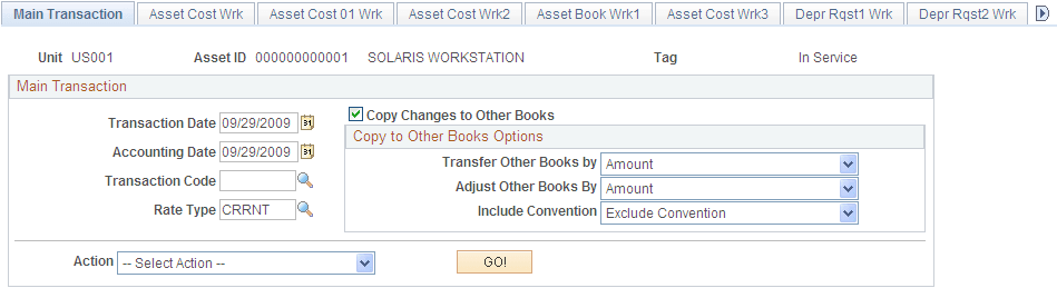

Use the Main Transaction page (ASSET_COST_01) to identify the cost/adjust/transfer transaction that you want to perform.
Navigation:
This example illustrates the fields and controls on the Main Transaction page. You can find definitions for the fields and controls later on this page.
Field or Control |
Description |
Transaction Date and Accounting Date |
Displays the current date or the dates that are specified as operator defaults. As a rule, transactions are entered in PeopleSoft Asset Management some time after they have occurred. Any difference between accounting and transaction dates will affect depreciation as well as posting. |
Transaction Code |
(Optional) Select a code to help identify which accounting entry template to use for this transaction. |
Rate Type |
Enter the currency exchange rate type to use for this transaction. |
Copy Changes to Other Books |
Select to copy the changes that you make to other books. |
Transfer Other Books by |
Select to transfer the changes that you make to other books by Amount or Percent. |
Adjust Other Books by |
Select to adjust the other books by Amount or Percent. Select Percent to transfer a percentage of the amount from subsequent books. For example, suppose you have an asset with two books, Corporate and Federal. The cost amount for Corporate is 5000.00 USD and is 4000.00 USD for Federal. If you transfer 2500.00 USD from the Corporate book, select Copy Changes to Other Books, and then specify the Percent option. 2500.00 USD will be transferred from the Corporate book and 2000.00 USD will be transferred from the Federal book. If you select Amount, a transfer of 2500.00 USD from both books will occur. If you have a multicurrency business unit, the Amount option will be overridden by Percent when you transfer or recategorize an asset. Note: If you do not select the Copy Changes to Other Books option, when the book that you are changing is associated with a ledger group that contains multiple ledgers, and the Keep Ledgers In Synccheck box is selected for the ledger group, changes will be copied to other books that associated with the same ledger. |
Include Convention |
The options are to Exclude or Include a depreciation convention. The depreciation convention automatically displays AM (actual month) for all transactions (except for Adjustments, which invokes the convention specifically defined for adjustments.) If you choose to have the convention included, the convention will be copied to all books. If you choose to have the convention excluded, the convention will not be copied to all books. You can override each book separately at the transaction level also. |
Action |
Select the financial transaction to be performed. Select an action and click the GO! button:

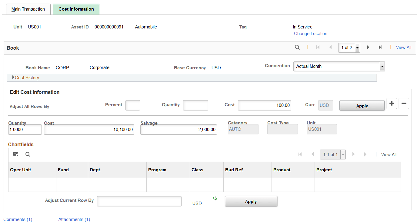

Use the Cost Information page (ASSET_COST_01A) to enter or adjust cost information that is required by the transaction that you initiated from the Main Transaction page.
Navigation:
Click the GO! button on the Main Transaction page.
This example illustrates the fields and controls on the Cost Information page. You can find definitions for the fields and controls later on this page.
The Cost Information page displays different fields and value options depending upon the action that you select before clicking the GO! button: addition, adjustment, recategorization, revaluation, or transfer activities.
Note: If you want to perform multiple transactions, complete one transaction, and then save and reenter the page to begin the next transaction. Doing so preserves the audit trail for each transaction.
Note: Transaction currency appears by default from the asset book base currency. Each line can reflect a different transaction currency, depending on the transaction. Balances are displayed in the base currency after the transaction currency is converted to the base currency.
Field or Control |
Description |

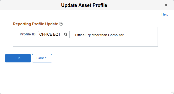

Update Asset Profile |
Click to access the Update Asset Profile Page and synchronize the reporting asset profile with the new asset category when you recategorize an asset. An update to the reporting asset profile ID alone does not change the asset book information or category. Profile updates after asset addition are for reporting purposes only. This field is only visible when you select Recategorize from the Action field on the Main Transaction page. See Updating Asset Reporting Profile After Asset Recategorization |
Change Location |
Click to change the asset's location. |
Convention |
Convention appears by default as Actual Month for all transactions, with the exception of Adjustments, which has its own convention. If you selected the Copy Changes to Other Books check box on the Main Transaction page and selected Exclude in the Include Convention check box, the convention will not be copied to all books. You need to override each book separately. |
Cost History |
Shows cost balance for the selected asset. You cannot update information here, but you can review cost rows and their associated ChartFields for an asset. |
This documentation discusses the remaining fields on the Cost Information Page in the context of the transaction being performed. Some fields are available only for certain transactions.

Cost History
Expand this group box to view cost history information.
The information displayed includes ChartField information, Salvage Value, Category and Cost Type.
Edit Cost Information
Add new cost rows in the Edit Cost Informationgroup box.
Field or Control |
Description |
Cost, Percent, and Quantity |
Enter as necessary, and enter additions and adjustments for any appropriate ChartFields. |

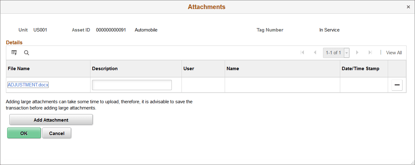

Adding and Viewing Attachments
Click the Attachments link to access the Cost Information - Attachments page (AM_ADD_ATTACH_SEC) and view or add relevant supporting documents to an asset transaction.
This example illustrates the fields and controls on the Cost Information - Attachments page.
Field or Control |
Description |
Add Attachment |
Click this button to attach files as supporting documentation for an asset. Supply a description of the file or files that you attach. |
File Name |
Displays the attached file. Click the file-link to access the file. |
Description |
Displays a description of the file attachment when one was provided by the user. |
User, Name, and Date/Time Stamp |
Displays the user ID, name, and date/time stamp related to the user who added the attachment. |

Use the fields in the Edit Cost Information group box to specify the cost and quantity to be transferred.
Select the Use Profile option to get profile attributes when New Profile ID has been enabled. If it is not enabled, the profile attributes are derived from the "from" or original asset profile. When using the capitalization threshold feature, the Use Profile option establishes which threshold is used for the new asset. If this check box is deselected, the system uses the anchor profile threshold. If the check box is selected, the system uses the threshold defined in the target profile.

Use the Child Assets page (CHILD_ASSETS) to select child assets to include in the transfer or recategorization that you have initiated against the parent assets.
Navigation:
The Child Assets page appears for child assets when you select the Transfer or the Recategorize actions on the Main Transaction page.
This example illustrates the fields and controls on the Child Assets page. You can find definitions for the fields and controls later on this page.
Note: Parent assets that are created on the Parent Asset page (parent-only assets) do not have cost or basic information. They cannot be viewed in the Parent-Child Basic Information component, nor can they be viewed or transacted against in the Asset Cost/Adjust Transfers component; the Asset Retirements component; or the Parent-Child NBV component. If you want to use a parent asset as a reporting umbrella only and access these pages to manipulate child assets in mass, you should create a zero cost parent asset instead of a parent only asset. Also, to transact against parent and child assets at once, parent and child must share the same asset profile.
Field or Control |
Description |
Select All |
Click Select All to include all child assets with the parent in the transaction that you have initiated. To include some child assets, select the Selected check box on the specific rows. |
Include Parent Asset |
Select to include the parent asset in this transaction. |
Advanced Txn Details (advanced transaction details) |
Click this link to access the Parent Asset Adv Txn options page. Specify transaction overrides for all child assets at once. For example, you would use this page to specify that only 50 percent of the cost of all child assets be transferred between departments, while the parent asset is fully transferred. Select to apply as full transaction, actual percentage, or transaction amount. |
Note: Only child assets available for transfer based on the specified accounting date can be selected. The system compares the last accounting dates for the child assets as specified on the Book table with the accounting date of the current transaction to make this determination.
Use the Child Asset TRF/RCT Overrides page (AM_PARCHD_TRF_RCT) to specify transaction overrides for a specific child asset.
Navigation:
Click Child Details on the Asset Cost/Adjust Transfer Child Assets page.
This example illustrates the fields and controls on the Child Asset TRF/RCT Overrides page. You can find definitions for the fields and controls later on this page.
Field or Control |
Description |
Convention |
Select a depreciation convention. |
Quantity or Cost |
Enter the quantity or cost to use in this transaction for the child asset. For example, if you were transferring all costs for the parent from one department to another, but wanted to transfer only 500 USD for the child asset, you would enter 500 in Cost. |
Transaction Percentage |
You can specify a percentage of the child asset's cost to include by entering it in the Transaction Percentage field. |
Enter a transaction date or an accounting date if you want it to differ from the dates that you entered for the parent's transaction. |

Use the Update Asset Profile page (ASSET_PROFILE_SEC) to enter a new asset reporting profile ID when you recategorize an asset.
