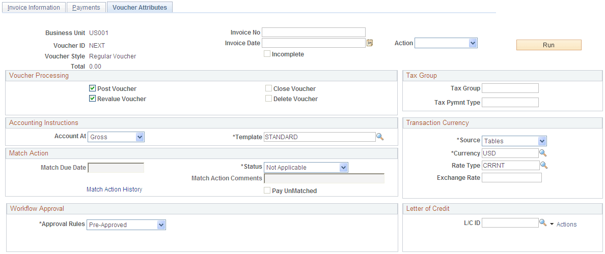

Use the Voucher Attributes page (VCHR_STATUS_IA) to view and, if applicable, override the default transaction currency processing, the match status, the voucher approval setting, voucher processing options, tax group, and accounting instructions.
Where applicable, you can also pay unmatched vouchers and access SBI (Self Billing Invoice), prepayment, and Letter of Credit information on this page.
Navigation:

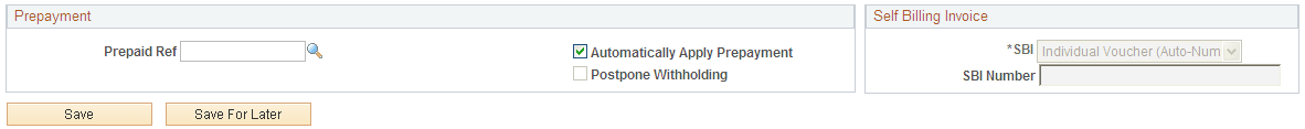

This example illustrates the fields and controls on the Voucher Attributes page, add mode (1 of 2). You can find definitions for the fields and controls later on this page.
This example illustrates the fields and controls on the Voucher Attributes page, add mode (2 of 2). You can find definitions for the fields and controls later on this page.

Prepayment
Enter prepayment information.
Field or Control |
Description |
Prepaid Ref |
Search for the prepaid voucher reference code created for the same supplier. |
