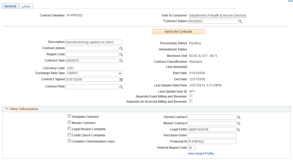

Use the Contract - General page (CA_HDR_PNL) to access contract information and change contract status to Active.
Navigation:
Contract - General page (1 of 2)
This example illustrates the fields and controls on the Contract - General page (1 of 2). You can find definitions for the fields and controls later on this page.

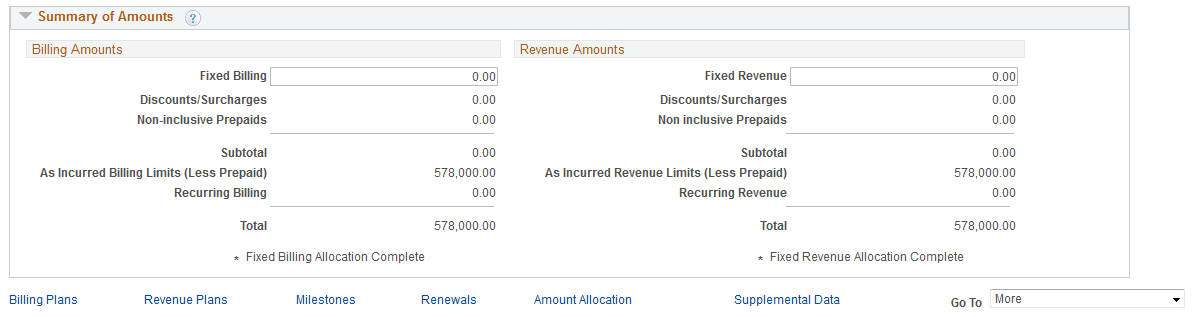

Contract - General page (2 of 2)
This example illustrates the fields and controls on the Contract - General page (2 of 2). You can find definitions for the fields and controls later on this page.
Note: Instructions on using this page appear in the PeopleSoft Contracts documentation.

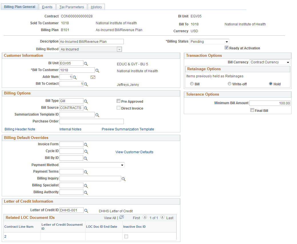

Use the Billing Plan General page (CA_BP_GEN_INFO) to change the billing status to Ready.
Navigation:
Select the Detail tab, and then click the link under the Billing Plan column heading.
This example illustrates the fields and controls on the Billing Plan General page. You can find definitions for the fields and controls later on this page.

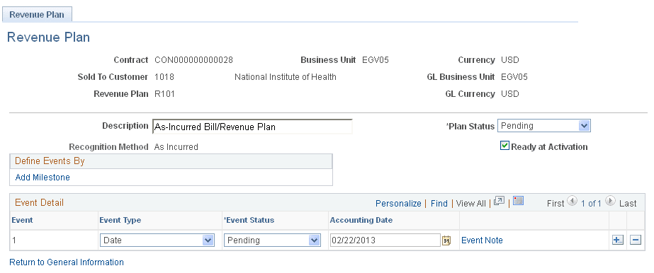

Use the Revenue Plan page (CA_ACCTPLAN) to change the revenue recognition status to Ready.
Navigation:
Select the Detail tab, and then click the link under the Revenue Plan column heading.
This example illustrates the fields and controls on the Revenue Plan page. You can find definitions for the fields and controls later on this page.
Note: Instructions on using the Revenue Plan page appear in the PeopleSoft Contracts documentation.
