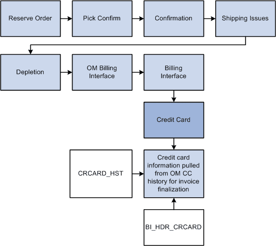

The next four diagrams illustrate the PeopleSoft Order Management credit card process flow:

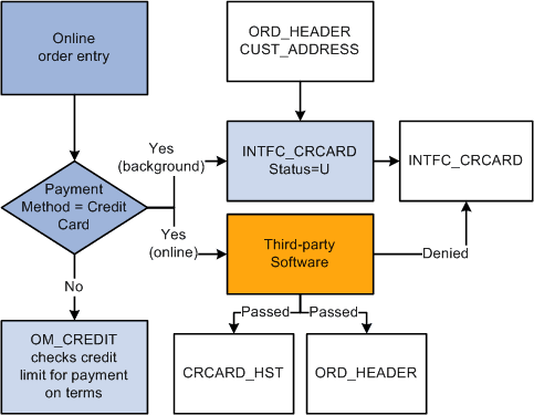

Step 1: Creating credit card charges during online order entry in PeopleSoft Order Management
Step 2: Submitting credit cards for background processing in PeopleSoft Order Management

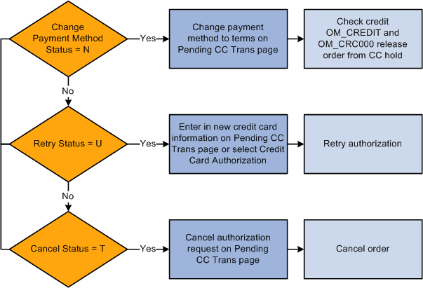

Processing failed credit card authorizations in PeopleSoft Order Management (1 of 2)
Processing failed credit card authorizations in PeopleSoft Order Management (2 of 2)

This section describes how credit card data can be entered for an order and have only an authorization processed to the card.
Enter an order with a payment method of credit card on the Order Entry Form page and click the Credit Card Data button to enter or modify the credit card information.
Authorize the credit card online while entering a sales order or place the order on hold and run these two processes:
Load CC Interface process (OM_CRCARD).
CC Processing (OM_CRC000).
Note: For OM_CRCARD to load the pending credit card data to the interface table and OM_CRC000 to transmit for authorization or approval, a working third-party integration to the credit card application must be installed in the system.
Review failed credit card transactions in the Identify Pending Transactions component.
Use the Pending Credit Card Transactions page (OM_INTFC_CRCARD1 ) to review the status of pending or failed credit card transactions or navigate to additional pages to correct or reset credit card transactions.
You can also reauthorize credit card transactions that were denied during sales order entry if using online authorizations. (Navigation: Order Management, Quotes and Orders, Create Credit Card Trans, Identify Pending Transactions)

Run the OM Billing Interface process (OM_BILL).
After the authorization is successful or you changed the payment terms for the order, the order can be processed through the fulfillment cycle. Then run OM_BILL to pass the information to PeopleSoft Billing for the shipped orders. It populates the Billing Interface tables in PeopleSoft Billing, which the Billing Interface process (BIIF0001) uses to create invoices. If the amount increases, for example if shipping charges are added in PeopleSoft Inventory, Billing will reauthorize the amount when the invoice is finalized. If the authorization reversal feature is enabled, and the amount increases, Billing will issue an authorization reversal transaction to cancel the authorization performed in Order Management and release the money held on the customer's credit card.

Select an option in the Actions group box to intercede in credit card processing:
Field or Control |
Description |
Unprocessed/Retry |
Sets the authorization status to Unproc/Ret. You can reauthorize the same credit card or enter a different credit card number. The CC Processing process picks up the transaction the next time you run the process and resubmits the credit card amount for batch authorization. If using online authorization, you can click the Authorize Credit Card link to reauthorize the failed transaction. |
Change to Terms |
Removes the transaction from credit card processing. You can change the payment method from credit card to payment terms. Once you change the order to payment terms, the system checks the credit limit and Receivables balance before the order is released. |
Cancel Order |
The credit card amount for the order will not be reauthorized. The order must be canceled on the Order Entry Form page. |
