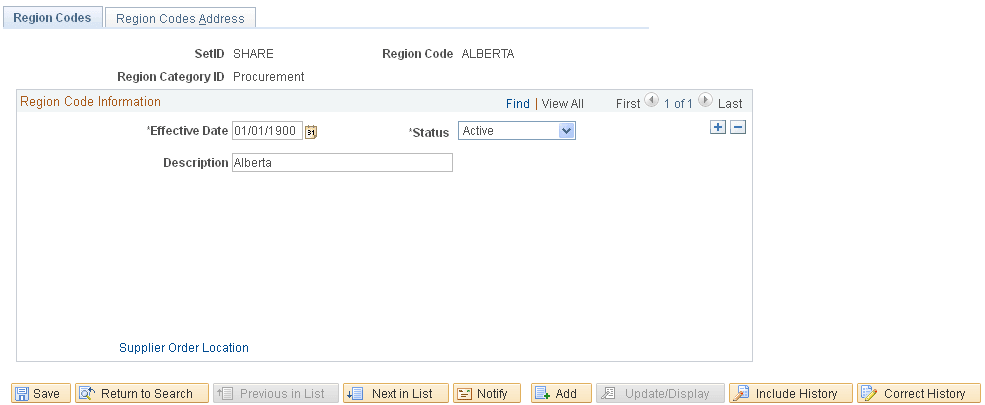

Use the Region Codes page (REGION_CD) to Define Services Procurement region codes.
Navigation:
This example illustrates the fields and controls on the Region Codes page. You can find definitions for the fields and controls later on this page.
After you enter information on the Region Codes page, you can select the Region Codes Address tab to enter related information on the Region Codes Address page.
Only regions with a category of procurement are used in PeopleSoft Services Procurement. Regions added from the link on the Define Services Procurement page are automatically created with a category of procurement.
