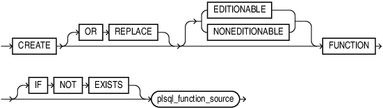

create_function ::=

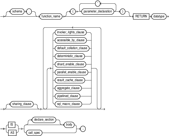

plsql_function_source ::=
( sharing_clause ::=、invoker_rights_clause ::=、accessible_by_clause ::=、default_collation_clause ::=、deterministic_clause ::=、shard_enable_clause ::=、parallel_enable_clause ::=、result_cache_clause ::=、aggregate_clause ::=、pipelined_clause ::=、sql_macro_clause ::=、body ::=、call_spec ::=、datatype ::=、declare_section ::=、parameter_declaration ::= )
