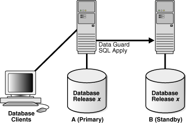

Figure 13-1 shows an Oracle Data Guard configuration before the upgrade begins, with the primary and logical standby databases both running the same Oracle Database software release.
Figure 13-1 Oracle Data Guard Configuration Before Upgrade
During the upgrade process, the Oracle Data Guard configuration operates with mixed database releases at several points in this process. Data protection is not available across releases. During these steps, consider having a second standby database in the Oracle Data Guard configuration to provide data protection.

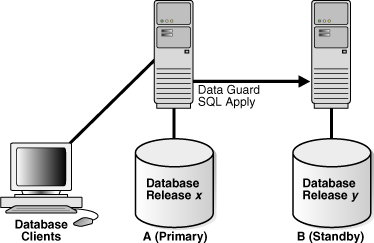

Figure 13-2 shows Database A running release x, and Database B running release y. During the upgrade, redo data accumulates on the primary system.
Figure 13-2 Upgrade the Logical Standby Database Release
Restart SQL Apply and operate with release x on Database A and release y on Database B. To start SQL Apply, issue the following statement on Database B:
SQL> ALTER DATABASE START LOGICAL STANDBY APPLY IMMEDIATE;
The redo data that was accumulating on the primary system is automatically transmitted and applied on the newly upgraded logical standby database. The Oracle Data Guard configuration can run the mixed releases shown in Figure 13-3 for an arbitrary period while you verify that the upgraded Oracle Database software release is running properly in the production environment.

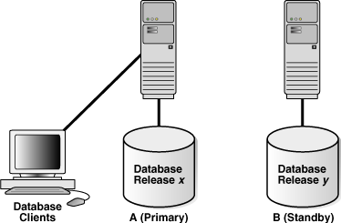

After the switchover, you cannot send redo data from the new primary database (B) that is running the new database software release to the new standby database (A) that is running an older software release. This means the following:
Redo data is accumulating on the new primary database.
The new primary database is unprotected at this time.

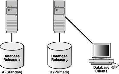

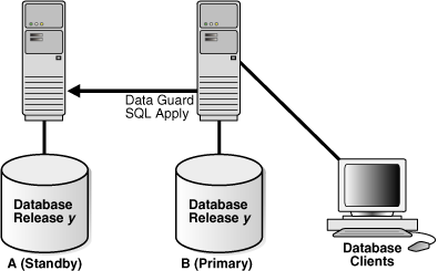

Figure 13-4 shows Database B, the former standby database (running release y), is now the primary database, and Database A, the former primary database (running release x), is now the standby database. The users are connected to Database B.
If Database B can adequately serve as the primary database and your business does not require a logical standby database to support the primary database, then you have completed the rolling upgrade process. Allow users to log in to Database B and begin working there, and discard Database A when it is convenient. Otherwise, continue with Step 8.
Database A is still running release x and cannot apply redo data from Database B until you upgrade it and start SQL Apply.
For more information about upgrading Oracle Database software, see the Oracle Database Upgrade Guide.

Flashback Database A to the guaranteed restore point (perform these steps on Database A).
SQL> SHUTDOWN IMMEDIATE; SQL> STARTUP MOUNT; SQL> FLASHBACK DATABASE TO RESTORE POINT pre_upgrade; SQL> SHUTDOWN IMMEDIATE;
At this point, switch Database A to use the higher version of the Oracle software. You do not run the upgrade scripts, since Database A is turned into a physical standby, and upgraded automatically as it applies the redo data generated by Database B.
Mount Database A, as follows:
SQL> STARTUP MOUNT;
Convert Database A to a physical standby.
SQL> ALTER DATABASE CONVERT TO PHYSICAL STANDBY; SQL> SHUTDOWN IMMEDIATE;
Start managed recovery on Database A.
Database A is upgraded automatically as it applies the redo data generated by Database B. Managed recovery waits until the new incarnation branch from the primary is registered before it starts applying redo.
SQL> STARTUP MOUNT; SQL> ALTER DATABASE RECOVER MANAGED STANDBY DATABASE - > DISCONNECT FROM SESSION;
When Redo Apply restarts, it waits for a new incarnation from the current primary database (Database B) to be registered.
At this point, Database B is your primary database and Database A is your physical standby, both running the higher version of the Oracle software. To make Database A the primary database, follow the steps described in "Performing a Switchover to a Physical Standby Database".
To preserve disk space, drop the existing guaranteed restore point created in Database A:
SQL> DROP RESTORE POINT PRE_UPGRADE;
