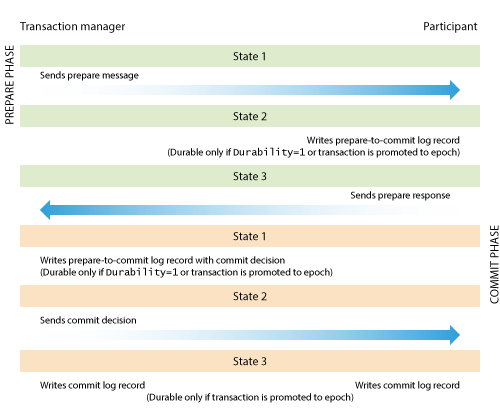

As previously mentioned, distributed transactions follow a two-phase commit protocol. TimesTen Scaleout implements the two-phase commit protocol as follows:
An application establishes a connection to a database. Every connection is associated with a specific element of the database, which becomes the transaction manager for all distributed transactions initiated from that connection.
The application executes one or more SQL statements. The transaction manager sends the statements to all the participants for execution. Based on the returned results of the execution of the SQL statement, the transaction manager identifies and updates the status of the participants.
The application issues a commit.
The transaction manager sends a prepare message to all participants. The message includes the identity of the transaction manager and all the participants.
Each participant, once it receives the prepare message, performs either of these actions:
If the participant is a write participant, it writes a prepare-to-commit log record that stores information to subsequently either commit or rollback the transaction. The participant also locks the modified rows to prevent read operations.
If the participant is a read participant, it identifies the transaction as read-only.
The participant sends a prepare response to the transaction manager with its vote for the commit decision:
A write participant only votes 'Yes' if it was able to write the prepare-to-commit log record.
IfDurability is set to 1, the participant writes a durable prepare-to-commit log record.A read participant always votes 'Yes' and commits the transaction without waiting for the commit decision. In this case, the commit operation consists on releasing all locks and temporary resources related to the transaction.
Once the transaction manager receives the prepare response from at least one element in every replica set participating in the transaction, it writes a prepare-to-commit log record that includes the commit decision. The transaction manager bases the commit decision on the scenarios described in Table 6-2.
Table 6-2 Scenarios for commit decision
| Scenarios | Decision |
 All write participants send a 'Yes' vote in their prepare response and within them there is at least one element for each participating replica set. (Failed participants do not affect the commit decision once they are identified as failed as long as its replica sends a response.)  |
 Commit  |
 Any write participant sends a 'No' vote in their prepare response.  |
 Roll back  |
The transaction manager sends a message to all write participants with the commit decision.
All write participants, including the transaction manager, commit or rollback the transaction based on the commit decision.
Figure 6-1 shows the two-phase commit protocol as implemented for distributed transactions in TimesTen Scaleout.
