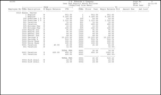

Reviewing Year-End Rollover Reports
After you process the year-end rollovers without updating history tables, review the rollover reports to verify that the balances are appropriate to roll over. If necessary, make any changes to PDBA history and process your rollovers without updating history tables again.
When your rollover reports contain the correct balances, process the year-end rollovers in update mode. Review the rollover report to verify that the correct rollover information is in the history tables.
When beginning balance hours or monetary amounts are negative, the rollover creates the Year-End Rollover report with the message that the rollover amount is negative.
Example: Year-End Payroll Month Rollover Report
