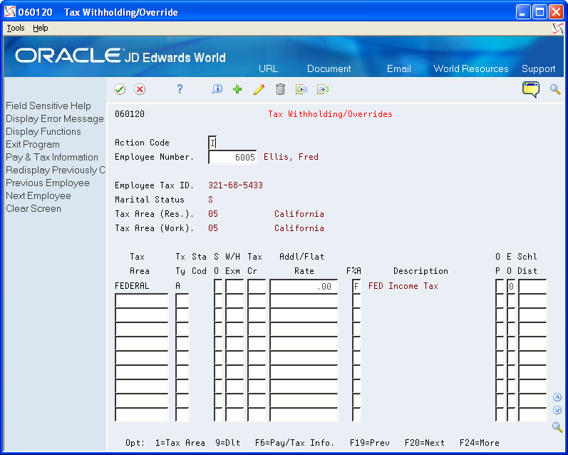

Setting up a Statutory Employee
Miscellaneous information that the government requires on the W-2 form includes the category for employees that are a statutory employee. A statutory employee is not subject to federal income tax withholding, but is subject to Social Security and Medicare tax.
To set up a statutory employee
Navigation
From Employee Information (G0711), choose Tax Withholding/Overrides
  1. On Tax Withholding/Overrides, locate the employee.
    This image is described in the surrounding text.
  2. Enter 0 (zero) in the following field:
    • Addl/Flat Rate (Additional Withholding)
  3. Enter F in the following field and Click OK:
    • F%A
Field
Explanation
An additional amount to be withheld over and above the calculated withholding. This could also represent a flat withholding amount in situations in which the employee elects to completely bypass the calculated amount. The authority to which each element relates is determined by the tier code of the tax authority. Whether the amount is to be an additional amount or a flat withholding is specified in the employee's master file record.
F%A
Based on the value of this field, the corresponding additional/flat amount field has one of the following functions:
% – A percentage to replace the tax rate from the table.
A – An amount to be added to the tax computed from the table.
F – An amount to replace the tax computed from the table.
X – An additional amount added to the standard exemption amount, deducted (exempt) from the annualized gross to determine taxable pay.
Y – An amount to override the standard exemption amount to be subtracted from the annualized gross prior to the tax calculations.

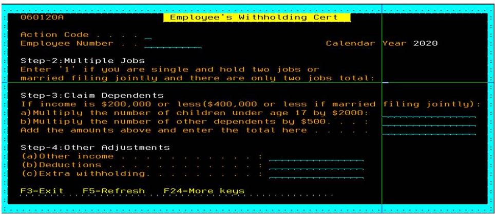

Setting up an Employee W-4 Form (for the year 2020 and later)
The IRS Form W-4, Employee's Withholding Allowance (060120A) is the program that employees use to enter information needed for the IRS W-4 Form.
Employees can enter information in W-4 forms, and review and edit the information if required. The IRS Form W-4 provides a tab each for Name and Address, and also provides the IRS Withholding Calculator. The system saves the values that an employee enters in the W-4 Form.
Updating Employee Details in the W-4 Form
In the Processing Options Revisions page, if the calendar year option for the W-4 form is 2021 or any later year, the system displays the new W-4 (Tax Withholding/Overrides) window.
To update the employee details in the W-4 Form:
  1. On the Tax Withholding/Overrides page, enter a value in the Employee Number field. The system then displays the employee details (Employee Tax ID, Marital Status, Tax Area, and so on).
  2. Enter the Tax rates if required.
  3. Select F5.
  4. The system displays the Employee Withholding Certificate with the following options:
    • Action Code: I Displays employee information.
    • Employee Number: Displays the employee number whose withholding is displayed
    • Calendar Year: Displays the calendar year for the withholding certificate.
    • Multiple Job or Spouse Works:
      Enter a value in this field if the employee holds more than one job or if the employee's spouse files jointly with the employee.
    • Claim Dependents:
      If you have dependents, complete the fields in the Claim Dependents section in the IRS Form W-4.
      a) Multiply the no. of children under age 17 by $2,000: Enter the amount generated by multiplying the number of children under the age of 17 by $2,000.
      b) Multiply the Number of other dependents by $500: Enter the amount generated by multiplying the number of other dependents who are not qualifying children under the age of 17 by $500.
      c) Add the amounts and end the total here: Enter the sum of the above two amounts.
    • Other Adjustments:
      a) Other Income: Enter the income for the year in which withholding is not expected on income.
      b) Deductions: Enter the deductions other than the standard deduction that will not have withholding.
      c) Extra Withholding: Enter the amount to be withheld in addition to the calculated withholding. This value could also be a flat withholding amount if the employee completely bypasses the calculated amount. The authority assigned to each element is determined by the tier code of the tax authority. Whether the amount is to be an additional amount or a flat withholding is specified in the employee's master file record.

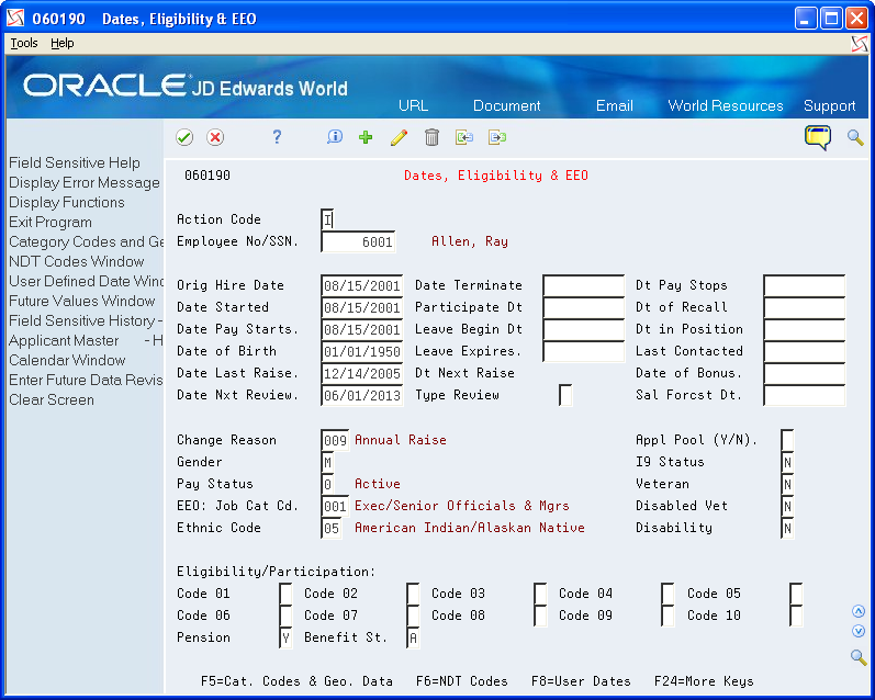

Setting up an Employee Who Is an Active Participant in a Retirement Plan
Miscellaneous information that the government requires on the W-2 form also includes the category for the employee that is an active participant in a retirement plan.
To set up an employee who is an active participant in a retirement plan
Navigation
From Additional Employee Data & Reports (G07111), choose Dates, Eligibility & EEO
  1. On Dates, Eligibility and EEO, locate the employee.
  2. Enter Y in the following field:
    • Pension
Field
Explanation
Pension
A code that specifies whether the employee is eligible to participate in the company's retirement plan. When you process W-2 information for employees, the code that you enter in this field determines whether the system places an X, indicating employee eligibility, in the Retirement plan box of the employee's W-2 form.

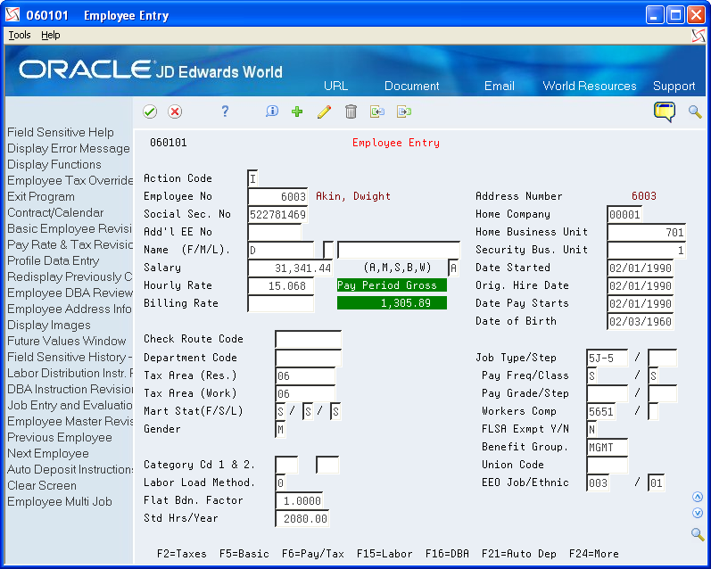

To set up the resident state as the base state
Navigation
From Employee Information (G0711), choose Employee Entry
  1. On Employee Entry, locate the employee.
  2. Enter the code for the employee's resident state in the following field:
    • Tax Area (Res.)

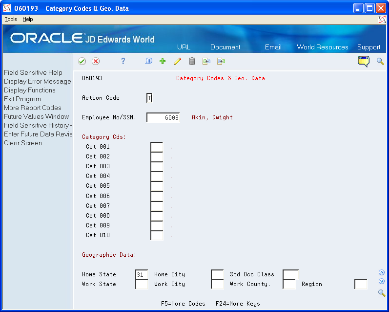

Setting up a State Other Than the Resident State as the Base State
You need to set up a state other than the employee's resident state as the base state when tax laws require you to print federal information on a year-end form for a state other than the employee's resident state.
For example, suppose that an employee works for company 707 in Ohio and New Jersey in 2024, but the employee moves to New York in January of 2024 and continues to work for company 707. You update the employee's master record to show New York as the resident state.
When you process year-end information, you must override the employee's current resident state information because all work for 2022 was in states other than the resident state.
Before You Begin
Add the tax areas to the UDC table for the appropriate states. The tax area code must be the two-digit Postal Code. For example, to specify the tax area for New Jersey, you enter tax area 31 to UDC 07/SC.
Because you must enter the numeric Postal Code for any state that you enter in the Home State field, you might have more than one entry per state in UDC 07/SC. You do not need to complete the second description of UDC 07/SC for any codes that you use to set up a state other than the resident state as the base state.
To set up a state other than the resident state as the base state
Navigation
From Additional Employee Data & Reports (G07111), choose Category Codes & Geo. Data
  1. On Category Codes & Geo. Data, locate the employee.
  2. Complete the following field:
    • Home State
Field
Explanation
Home State
The employee's home state for tax reporting purposes. This code designates the state in which the employee resides.
Note: For W-2 reporting, use the numeric value that is equivalent to the designated state. For example: 06 - Colorado, 05 - California. Otherwise, the system produces undesirable report results. If you leave this field blank, the system uses the value in the Tax Area (Resident) field on Pay and Tax Information as the employee's resident (base) state.

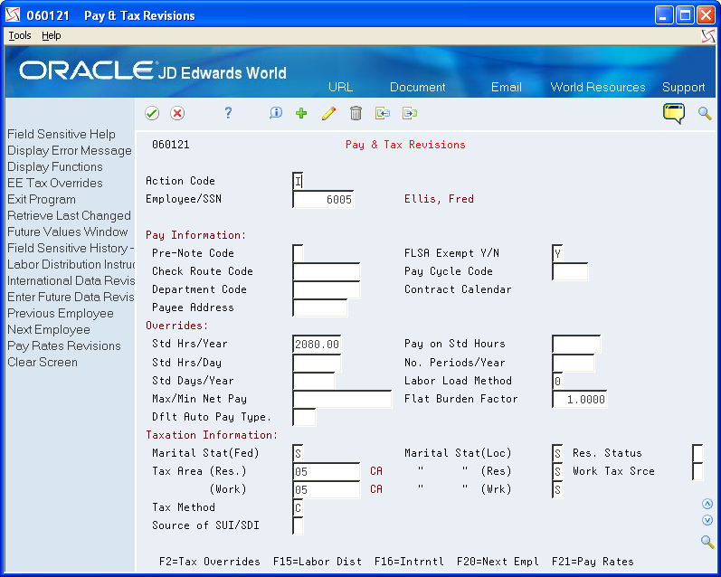

Setting up Employees Who Work in Puerto Rico
If your organization has employees who work in Puerto Rico during the year, you must create 499R-2 forms for tax reporting purposes when you process year-end information. To set up employees who work in Puerto Rico correctly, you must set them up as statutory employees. Additionally, you must assign the proper tax area and tax method. By assigning the correct tax method, the history records the system creates during the payroll process include the appropriate tax history type. The payroll system generates 499R-2 forms for Puerto Rican employees, using the tax history type.
See also:
Navigation
From Additional Employee Data & Reports (G07111), choose Pay & Tax Revisions
  1. On Pay & Tax Revisions, locate the employee.
  2. Enter R in the following field:
    • Tax Method
  3. Enter 72 in the following fields:
    • Tax Area (Res.)
    • Tax Area (Work)
  4. Click OK.
