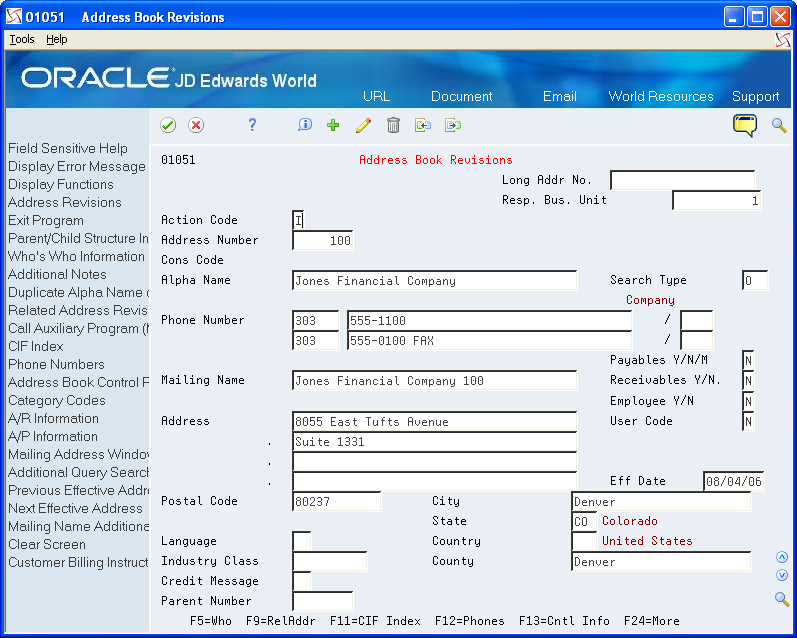

Verifying Company Names and Addresses
To compile the information that you report to state and federal government agencies, the system uses company names and addresses from the Address Book record. Before you build the W-2/1099 workfile, verify that company names and addresses are set up properly for year-end reporting.
The system prints the company name, the first two address lines (for electronic filing) or the last three nonblank address lines (for printed forms), and the city, state, and postal code fields. The system can print a maximum of 30 characters per line on the printed forms and includes a maximum of 22 characters per line in the electronic file. The information that prints on these lines is as follows:
Name
Address
For electronic filing, the first two address lines (up to 22 characters per line)
For forms, the last three nonblank address lines (up to 30 characters per line)
City, state, and postal code
The company address that prints on year-end forms includes the last three nonblank lines of the company's address. The address that the system generates for electronic filing includes the first two lines of a company's address. To ensure that address information is complete on both the printed forms and electronic filing year-end information, JD Edwards World recommends that you enter all of the necessary address information using the format above. If you are not processing electronic filing, you can use up to three lines to enter a street address. However, if you plan to file electronically in the future, you might need to change the address to avoid reporting incomplete information in the electronic file.
Navigation
From Address Book (G01), choose Address Book Revisions
The following illustrates the company address information for year-end purposes:

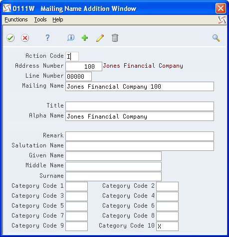

Verifying Railroad Tax Information
For companies that are subject to railroad taxation, verify that the setup of railroad tax information meets tax regulations.
An X in category code 10 on the Mailing Name Addition Window designates companies that are subject to railroad taxation (tier I and tier II). The X displays on the employer record of the electronic file and identifies special taxation requirements to the IRS.
Before You Begin
Add X to UDC 01/WT, if necessary.
To verify railroad tax information
Navigation
On Address Book Revisions, locate the company.
Choose Who's Who Information (F5).
On Who's Who, enter 5 in the following field next to the company name:
Option
On Mailing Name Addition Window, complete the following field and click Change:
Category Code 10
The X must be in the first position of this field.

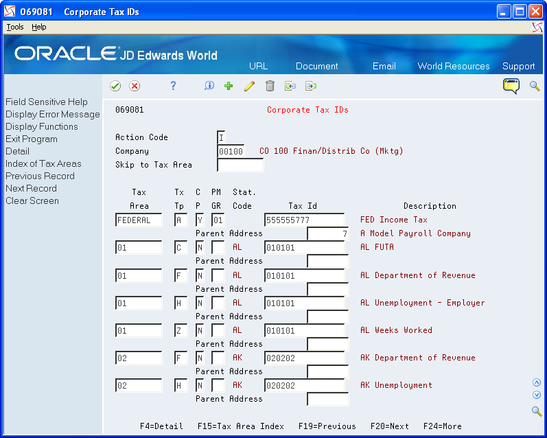

Updating Year-End Information to a Parent Company
If your organization contains several companies that are under one parent company, and all of the child companies have the same corporate tax ID, you can update W-2 information and report it under the parent company. When you update multiple companies under a parent company, an employee who worked in more than one child company receives only one W-2.
You must summarize by the parent company. For example, suppose that the parent company is 00001 and the child company is 00050. You must summarize year-end information for both companies to company 00001. The W-2 forms for employees who work for either company display the name and tax ID of company 00001.
For W-2 reporting purposes, the Federal A corporate tax ID number cannot contain punctuation or spaces. If dashes exist in the Federal A corporate tax ID, remove them. Then correct employee history records that have the erroneous Corporate Tax ID information by following the steps to update payroll history integrity.
Working with PDBA History Integrity about updating employee history information
To update year-end information to a parent company
Navigation
From Taxes & Insurance (G0744), choose Corporate Tax IDs
On Corporate Tax IDs, for the Federal A tax area record of the parent company and all child companies, enter the address number for the parent company in the following field in the detail area:
Parent Address
Click Change.

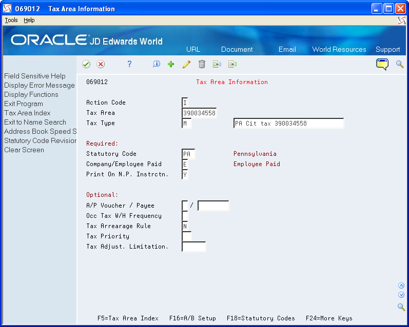

Verifying Tax Area Information
Before you build the workfile, verify that the statutory codes and descriptions for the state and local tax areas are accurate. The system uses this information and prints it in two boxes on the W-2:
State (box 15) displays the statutory code that you assign to the state F tax area. These codes are in UDC 07/SC.
Locality name (box 20) displays the local tax area description. Eight characters appear for standard and two-part laser forms. Fifteen characters appear for four-part laser forms.
Verifying tax area information includes the following tasks:
Verify tax area information for Box 15
Verify tax area information for Box 20
To verify tax area information for Box 15
Navigation
From Taxes & Insurance (G0744), choose Tax Area Information
On Tax Area Information, locate the tax area and tax type.
Review the value in the following field:
Statutory Code
To verify tax area information for Box 20
Navigation
Review the value in the following field, which is next to the Tax Type field, but does not contain a label:
Description

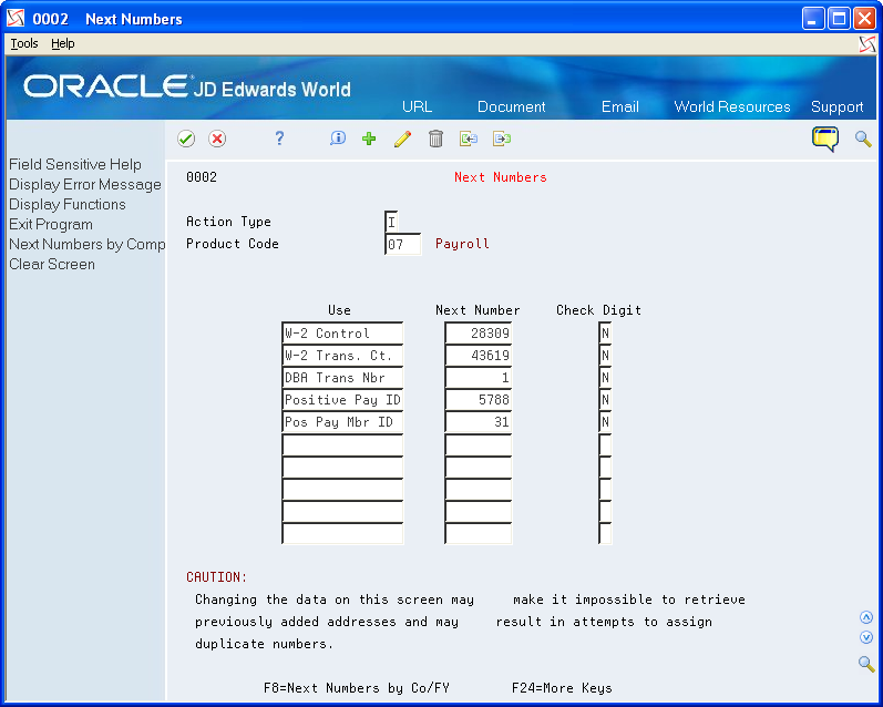

Setting up Next Numbers for W-2 Forms
Setting up next numbers for W-2 forms instructs the system to assign individual control numbers to each W-2. This action creates an audit trail for your W-2 forms. Before you begin year-end processing, verify that next numbers exist for system 07 for the following fields:
W-2 Control
W-2 Transaction Count
To set up next numbers for W-2 forms
Navigation
From General Systems (G00), choose Next Numbers
On Next Numbers, to locate next numbers for a system, complete the following field.
System Code
Review the values in the following fields:
Use
Next Number
Check Digit
