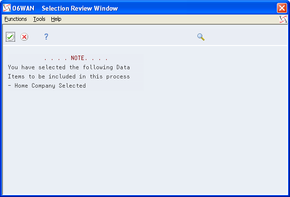

  2. On the second Build W-2/1099 Workfiles screen, choose Submit Job (F6).
    If you choose selection criteria, the system displays the Selection Review Window, which displays the criteria that you chose.
    This image is described in the surrounding text.
  3. Choose Continue Processing.
