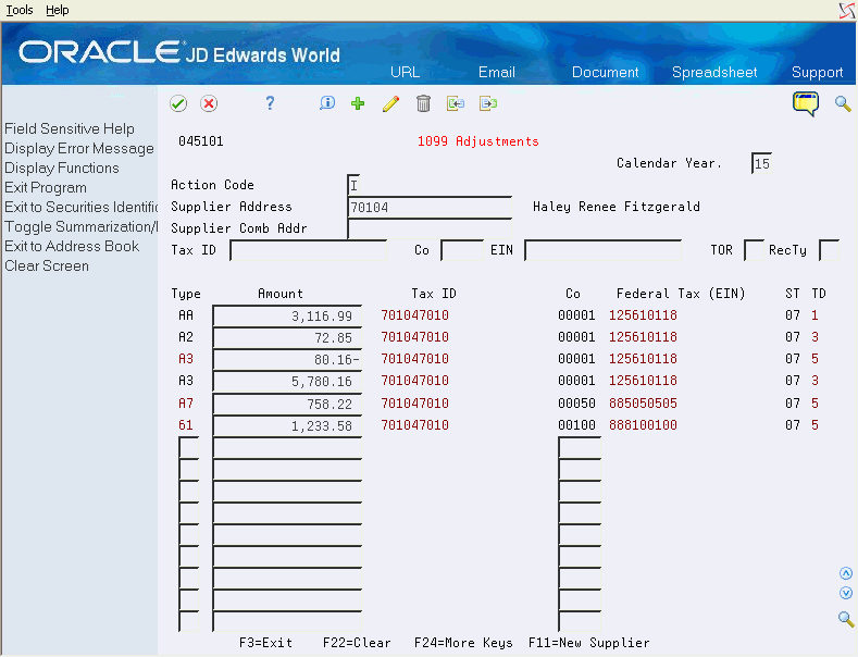

Understanding Detail Information on the 1099 Adjustments Screen
When you access the detail area of the screen, the system displays the information for the combining supplier (SCMB) and company (CCMB). The system retrieves this information from the workfile records, which it updates based on the values of the Alternate/Related Address Combining processing options in 1099 Processing Option Setup program (P04510STUP).
If you do not use the combining feature, the system updates these fields with the address book number of the supplier and company.
If you use the combining feature, you can review the combining address book numbers to ensure they are correct. The Write Media program (P04515) uses the combining address information to locate the company name and address (Payer's box) and supplier name and address (Recipient box) to print on the 1099 form.

Reviewing and Changing Workfile Records
Although the quickest and easiest method to adjust amounts is to change the actual workfile records, doing this does not provide an audit trail. If you change amounts using this method and need to rebuild one or both of the workfiles, run the Preview 1099 Media report first to print the adjustments previously entered so they can be reentered, if necessary.
To review and change workfile records
  1. On 1099 Adjustments, complete one or more of the following fields and click Inquire:
    • Calendar Year
    • Supplier Combining Address
    • Tax ID
    • Company
    • EIN
    • TOR
    • Record Type
    This graphic is described in the surrounding text.
  2. Locate the record that you want to change.
  3. Change the value in the Amount field and click Change.
Field
Explanation
Tax ID
The tax ID of the supplier.
EIN
The tax ID of the company.
TOR or Type
The type of return code from UDC 04/TR that indicates the form and box of the 1099 return.
Record Type
A number that identifies the type of record in the workfile:
  • Leave this field blank to display all workfile records.
  • Enter 1 to display only those records from the G/L workfile.
  • Enter 3 to display only those records from the A/P workfile.
  • Enter 5 to display only the adjustment records that were added using this program.

To add adjustments without changing workfile amounts
Use this method to retain an audit trail of the adjustments. You can enter the change amount as a separate Type 5 adjustment without changing the original workfile record.
  1. On 1099 Adjustments, locate the record and note the type of return, amount, and company number.
  2. On the first blank detail line, complete the following fields to enter the adjustment information and click Change:
    • Type
    • Amount
    • Company Number
  3. Repeat the previous steps for each additional workfile record that you want to record an adjustment.
To add adjustments for suppliers without workfile records
Use this task to enter information for payments made to suppliers from a third-party system or for which you do not have workfile records. The supplier must have an address book and supplier master record and must be assigned a person corporation code of P or N to add adjustment records.
  1. On 1099 Adjustments, complete the Supplier Number field and click Add.
  2. On the first detail line, complete the following fields to enter the adjustment information and click Add:
    • Type
    • Amount
    • Company Number
  3. Repeat the previous step for each type of return.
To add adjustments for backup withholding
If you use the G/L Method for generating 1099 returns, you must enter adjustments for amounts withheld and paid to the federal government (backup withholding). If you use the A/P Ledger Method, you can either build the workfile for the backup withholding type of return (A4, 14, or 64) or enter the withholding amounts as adjustments.
  1. On 1099 Adjustments, locate the record.
  2. Complete the following fields on the first blank detail line and click Change:
    • Type
    • Amount
    • Company Number

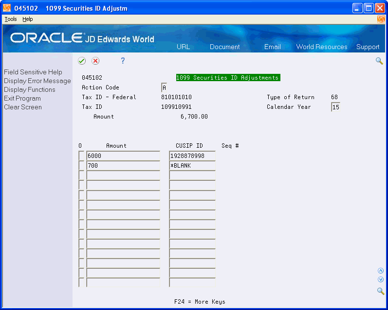

Adding the CUSIP Number for Tax-Exempt Interest
The IRS requires that you include the CUSIP number if you pay your supplier tax-exempt interest on a tax-exempt bond or security during the calendar year. You report this amount in box 8 of the 1099-INT form and the CUSIP number in box 14. The system also includes it on the 1099 facsimile report and in the 1099 transmittal file. If a CUSIP number does not exist for a bond or security you can leave box 14 blank.
You assign the CUSIP numbers using the 1099 Securities ID Adjustments program (P045102), which you access from the 1099 Adjustments program. You might have multiple CUSIP numbers for one TOR 68 amount.
  • The amount that you enter with a CUSIP value must equal the amount of TOR 68 or the system displays an error and does not accept the entry. If only part of the interest has a CUSIP number, you must enter the remaining amount using *BLANK as the CUSIP number so that you can account for the entire tax-exempt amount, as well as complete the task.

The system stores the CUSIP information in the 1099 Securities Identification file (F04510).
See CUSIP Information in Report Year-End Information on 1099s Returnsfor detailed information about how the system prints the CUSIP information on the 1099-INT form.
If you have multiple bond and securities to identify, the amounts that you enter must equal the amount that the system displays in the header portion of the screen or the system displays an error and you cannot complete the task.
To add CUSIP numbers for tax-exempt interest
  1. On 1099 Adjustments, locate the suppliers for whom you process returns for Type 68.
  2. Place your cursor in the Type field that contains the value 68 and choose Exit to Securities Identification (F5).
  3. On 1099 Securities ID Adjustments, enter A in the Action Code field and complete the following fields for each bond and security.
    • Amount

  1. On 1099 Adjustments, locate the supplier.
  2. Locate the individual record you want to delete, clear the Amount field, and click Enter.
  3. Repeat the previous steps for each record that you want to delete.
To delete all records for a supplier
  2. Click Delete.
    The system displays a warning that it is going to delete all of the records that display.
  3. Click Enter.
  2. Locate the record with the amount for the incorrect box and enter 0.00.
  3. On the first blank detail line, complete the following fields and click Add.
    • Type
    • Amount
    • Company Number
