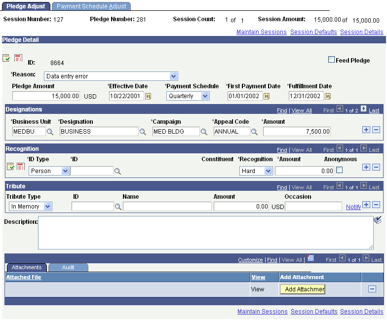

Entering a Pledge Adjustment Transaction
Access the Pledge Adjust page (Contributor Relations, and then Session Management, and then Enter Pledges, and then Pledge Adjustment, and then Pledge Adjust).
This example illustrates the fields and controls on the Pledge Adjust page. You can find definitions for the fields and controls later on this page.
Pledge Adjust page
Important:
Adjusted transactions negate the original transaction and create a new transaction record, so enter adjustment amounts just as you would if entering the original transaction.
The original transaction must be posted before you can adjust it.
Field or Control Description
Reason
Select a reason for the adjustment. Reason codes are defined by your institution and describe the reason why an adjustment is made.
Make any necessary changes to the fields on this page.
You can click the links at the bottom of this page to access related pages.
Recognition
In this group box, you can enter soft-dollar pledges and soft credit-only pledges.
Click the View link to open the attachment in a new window. Click the Add Attachment button to upload a new attachment from within the component.
