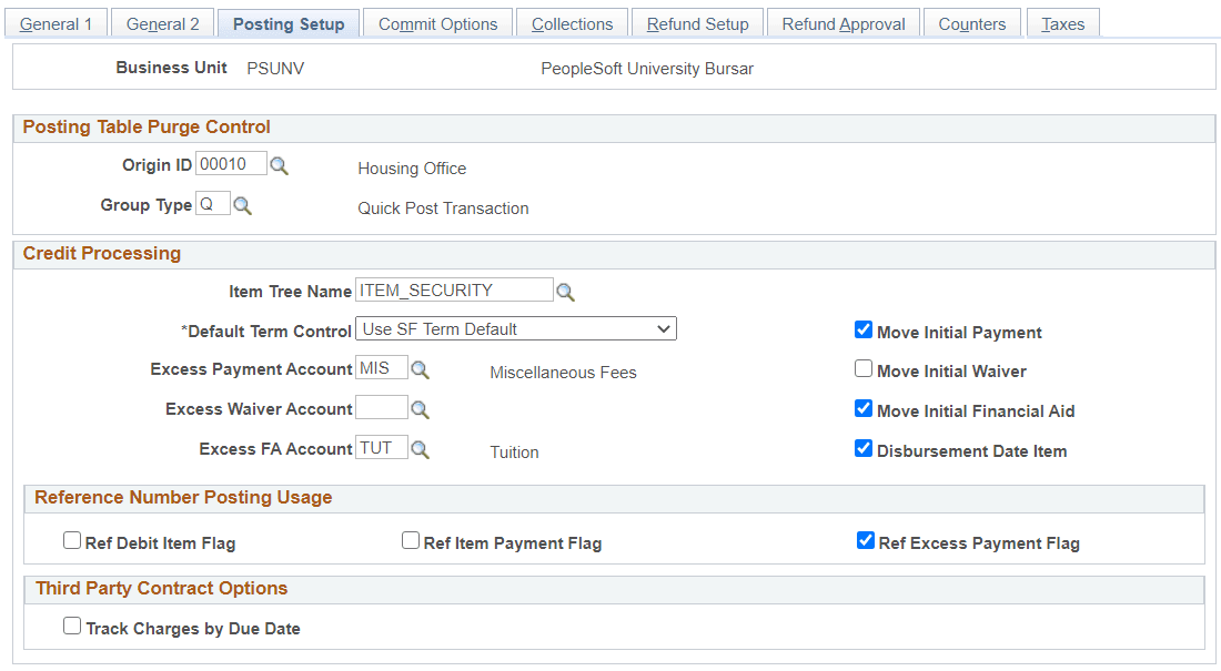

Defining Posting Parameters
Access the Posting Setup page (Set Up SACR, and then Product Related, and then Student Financials, and then SF Business Unit, and then Posting Setup).
This example illustrates the fields and controls on the Posting Setup page. You can find definitions for the fields and controls later on this page.
Posting Setup page
QUICK_POST_TBL Purge Control
Student Post (Quick Post) and Corp Post transactions are recorded in the Quick Post table. These entries can be consolidated into posting groups using the Purge QUICK_POST_TBL process. The options in this group box create entries in the Group Control record that enable you to easily track Student Post transactions.
Field or Control Description
Origin ID
Select the origin ID that you want the system to use when consolidating transactions into posting groups.
Group Type
Select the group type that you want the system to use when consolidating transactions into posting groups.
Credit Processing
Set the conditions that you want the system to use when credits (payments) are posted on an account.
Item Tree Name
Select the name of the item type tree that contains all of the item types that you use for transactions. This tree also controls item type security.
Default Term Control
Select how you want to determine the term that the system uses as the default if a charge or payment is entered without specifying a term:
  • Latest Enrollment Term: Select if you want the default term to be based on the maximum term from STDNT_CAR_TERM where the eligible to enroll check box is on. If that does not return a term, then the default term is based on the term value defined in the SF Term Default setup.
  • Most Current Enrollment Term: Select if you want the default term based on the term from STDNT_CAR_TERM with a begin date of less than equal to the current date. If that does not return a term, then the default term is based on the term from STDNT_CAR_TERM where the end date is greater than or equal to the current date. If this does not return a term, then the default term is based on the term value defined in the SF Term Default setup.
  • Use SF Term Default: Select if you want the default term to be based on the term value that you defined in SF Term Default setup.
Note: Values for this field are delivered with your system as translate values. Do not modify these values in any way. Any modifications to these values require a substantial programming effort.
Warning! Your selection of a default term control can affect how payments are processed. When either of the enrollment term selections are used, the actual term value may vary from student to student. The actual term value used becomes the value of the current term for payment processing.
Move Initial Payment
Select to move all payments in excess of charges to the account specified for excess payments. If the option is not selected, excess payments show as a credit balance on the charge account.
Excess Payment Account
Select a default account that you want to use for payments that are received in excess of charges.
Move Initial Waiver
Select this check box only if you need to move all waivers posted through Student or Group Post that are in excess of charges to the account specified for excess waivers.
Using the tuition calculation process for waivers should never create a waiver with a credit balance. Oracle recommends that you don’t select this option when waivers are calculated and posted using the tuition calculation process. To post unique and discretionary waivers, see Assigning Student Waivers.
Excess Waiver Account
Select a default account that you want to use for waivers that are posted to an account in advance of charges. This feature can also be used as an option for waivers that are posted in excess of charges.
Warning! Oracle doesn’t recommend using this option. Waivers should rarely, if ever, be applied to students’ accounts by any means other than the tuition calculation process. Waivers posted using the Student Post or Group Post processes may not be adjusted properly and may not be applied according to the payment applier rules. For example, a waiver that exceeds student charges is a stipend and it may be considered taxable income by the governing tax authority. Tuition calculation is a self-correcting process; it ensures that no more than 100% is ever waived. If you use Student or Group Post, you’re removing this protective measure. When a waiver is posted in excess of charges, it doesn’t appear in box 1 on the US tax form 1098–T or the Canadian tax form T2202.
For information about posting discretionary waivers that don’t fit your standard waiver setup or criteria, see Assigning Student Waivers. Use that feature instead of Student Post or Group Post.
Move Initial Financial Aid
Select to move all financial aid payments in excess of eligible charges to the account specified for excess financial aid. If this option is not selected, excess financial aid payments show as a credit balance on the charge account.
Excess FA Account (excess financial aid account)
Select a default account that you want to use for financial aid that is posted to an account in excess of eligible charges.
Disbursement Date Item
Select to display each disbursement of a financial aid award in a single term of the same Item Type as a separate line item on a student's account. This setting is applicable only to Item Types with a Classification of Financial Aid.
Warning! If you don't select this option, Financial Aid disbursements won't correctly reverse disbursements when multiple disbursements exist within a term if adjustments are made to the award.
Note: Student Financial Planning Integration
This setting must be selected to ensure SFP Disbursements have a 1:1 relationship with CS PAYMENT_ID_NBR.
To ensure the 1:1 relationship, all of the following must be true:
  • Enable SFP Interface is selected at Campus Community, and then Student Fin Planning Interface, and then SFP Installation Setup.
  • Disbursement Date Item (this setting) is enabled.
  • GROUP_LINE.DISBURSEMENT_DATE is populated.
  • GROUP_LINE.REF1_DESCR is populated.
Warning! Don't change this setting after you begin posting Financial Aid awards.
Reference Number Posting Usage
This group box provides additional options for the posting of debits and payments.
Ref Debit Item Flag (reference debit item flag)
Select to have the option of associating a reference number with charge items. For example, you could use a parking ticket number as a reference on a parking fine charge. Each charge item with a reference number is displayed separately on the Charge Detail page.
Ref Item Payment Flag (reference item payment flag)
Select to have the option of associating a payment with a particular charge by using the reference number. For example, if you use a parking ticket number as a reference number on a parking fine charge, you can use that same ticket number to tie the payment to the specific charge.
Note: The Ref Debit Item Flag check box must be selected for you to use the Ref Item Payment Flag option.
Ref Excess Payment Flag (reference excess payment flag)
Select this option to have payments made in excess of a particular charge applied to other charges with the same reference ID.
Note: The Move Initial Payment check box must be selected for you to use the Ref Excess Payment Flag.
Third Party Contract Options
This group box provides an additional option for Third Party Contract functionality.
Track Charges by Due Date
Select this check box if you want to be able to track the student's due and billing date in the Third Party Contract process. The check box is cleared by default.
See Setting Up Third-Party Contracts.
