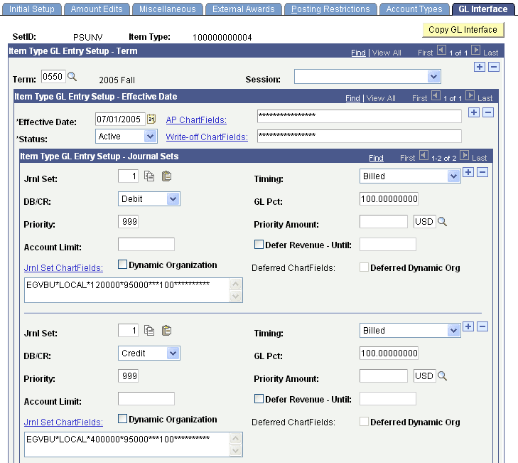

General Ledger Interface
GL_INTERFACE
Set Up SACR, and then Product Related, and then Student Financials, and then Item Types, and then Item Types, and then GL Interface
Map item types to general ledger accounts.

AP ChartFields
SSF_CF_WRKGRID_SEC
Click the Jrnl Set ChartFields link on the GL Interface page.
Define item type GL interface parameters for AP distribution.
Write-off ChartFields
SSF_CF_WRKGRID_SEC
Click the Write-off ChartFields link on the Item Interface page.
Define item type GL interface parameters for write-offs.
Journal Set ChartFields
SSF_CF_WRKGRID_SEC
Define item type GL interface parameters for a journal set.
Deferred ChartFields
SSF_CF_WRKGRID_SEC
Click the Deferred ChartFields link on the GL Interface page.
Define item type GL interface parameters for a deferred revenue account.

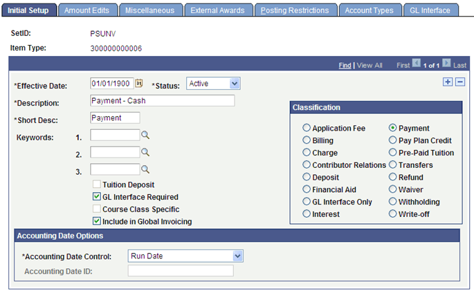

Defining Basic Item Type Attributes
Access the Initial Setup page (Set Up SACR, and then Product Related, and then Student Financials, and then Item Types, and then Item Types, and then Initial Setup).
This example illustrates the fields and controls on the Initial Setup page. You can find definitions for the fields and controls later on this page.
Initial Setup page
Field or Control Description
Keywords
Select up to three keywords that you want to link to the item type.
Tuition Deposit
Select if the item type is for a tuition deposit. This check box is active only when the Deposit item type classification is selected.
GL Interface Required
If you select this check box, you must complete the GL Interface page of this component to save the item type. You must define both a debit and credit side for the item type, the GL Pct (general ledger percent) must add up to 100 percent for all accounts on each side, and all of the required fields on the GL Interface page must be populated. If you select this check box, the Course Class Specific check box and Accounting Date Options group box also become available.
See Mapping Item Types to General Ledger Accounts.
The Accounting Date Options group box is available only when the GL Interface Required check box is selected.
Accounting Date Control
Select the accounting date of the item type. Transactions in Accounting Line (SF_ACCTG_LN) are stamped with the accounting date.
Values are:
Accounting Date:
Select this value to use the accounting date that is set up on the Accounting Dates page.
When you select Accounting Date here, you must then select a value in the Accounting Date ID field, to associate it with the item type. The date that is used in Accounting Line transactions is the date that is set up for the term or a combination of term and session for that ID on the Accounting Dates page.
Item Effective Date: Select to use the effective date of the transaction (item) as the accounting date.
Maximum (Accounting Dt, Run Dt):
Select this value to use the date that is the greater of these two dates—the accounting date (see the definition of the Accounting Date value) and the run date, which is the GL Interface process date.
Maximum (Term Start Dt, Run Dt): Select to make the system use the more recent of term start date or run date as the accounting date. This option is useful to prevent complications resulting from accounting periods that have already been closed.
Run Date: Select to use the GL Interface process date as the accounting date. This is the default value for this field.
Term Start Date: Select to use the beginning of the term as the accounting date. For example, suppose students at your institution register for fall term courses in the spring, but you want the system to put the tuition income from those registrations into a fall accounting period. By selecting term start date as your accounting date control and specifying the fall term on your tuition transaction, the system posts the charges to the fall period.
Warning! Selecting Term Start Date in the Accounting Date Control field could cause transactions to be backdated into an already closed accounting period. Select this option with caution.
Accounting Date ID
This field is available and required only when the value in the Accounting Date Control field is Accounting Date or Maximum (Accounting Dt, Run Dt).
All IDs that are set up on the Accounting Dates page and have an active status are available values in this field.
Use this field to assign an accounting date ID to an item type to designate the specific date to be used for Accounting Line transactions.
See Setting Up Accounting Dates.
Classification
Select the appropriate classification for this item type. Your choice determines the fields that are available to you on the Miscellaneous Edits page, and indicates to the system whether the item type is a charge or credit entry.
Application Fee
Select if you are defining an item type used for an application fee. Application Fee transactions result in a charge on the student's account.
Billing
Reserved for future use.
Charge
Select if you are defining a charge item type.
Charge transactions result in a charge on the student's account and, depending on your GL setup, may create a receivable.
Contributor Relations
Select if you are defining a contributor relations item type. Typically, the Contributor Relations staff define contributor relations item types.
Deposit
Select if you are defining a deposit item type. If the deposit classification is selected, a Tuition Deposit check box is also activated. If this item type is used for a tuition deposit, both the Deposit classification and the Tuition Deposit check box must be selected.
Deposit and Tuition Deposit transactions result in a credit on the student's account.
Financial Aid
Select if you are defining a financial aid item type.
Financial Aid transactions result in a credit (payment) on the student's account.
Note: Financial Aid item types also require definition in the Financial Aid application.
GL Interface Only
Interest
Select if you are defining an item type for interest charges for payment plans.
Interest transactions result in a charge on the student's account.
Payment
Select if you are defining a payment item type.
Payment transactions result in a credit (payment) on the student's account.
Pay Plan Credit
Pre-Paid Tuition
Transfers
Refund
Select if you are defining an item type used for an overpayment refund.
Refund transactions result in a charge on the student's account.
Waiver
Select if you are defining an item type used for waivers.
Waiver transactions result in a credit (payment) on the student's account.
Withholding
Select if you are defining an item type for tax withholding.
Withholding transactions result in a charge on the student's account.
Write-off
Select if you are defining an item type used for bad debt write-off.
Write-off transactions result in a credit on the student's account.

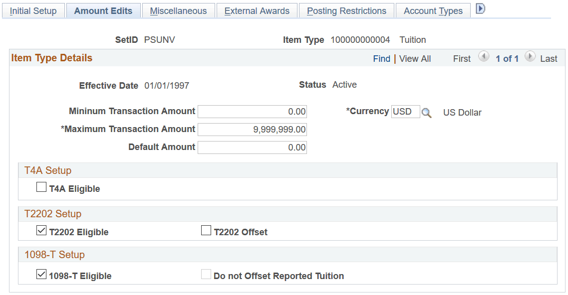

Defining Transaction Amount and Tax Form Parameters for Item Types
Access the Amount Edits page (Set Up SACR, and then Product Related, and then Student Financials, and then Item Types, and then Item Types, and then Amount Edits).
This example illustrates the fields and controls on the Amount Edits page. You can find definitions for the fields and controls later on this page.
Amount Edits page
Minimum Transaction Amount and Maximum Transaction Amount
Select the optional minimum and maximum amounts for each transaction using this item type. The system uses these amounts as edits for group posting.
Currency
This field derives its default value from the base currency that your institution sets. You can override this field, but transactions created through tuition calculation will not use the value you set.
Default Amount
You can enter a default amount for your item types to streamline data entry. This is particularly useful when you are entering a charge or payment for something with a fixed cost (for example, a parking permit). You can override this default amount whenever necessary. The default amount must be greater than or equal to the minimum transaction amount.
T4A Setup
This group box pertains to the form that is required by the Canadian government to report education-related income for Canadian students.
T4A Eligible
Select if this item is reportable education-related income.
T2202 Setup
This group box pertains to the form that is required by the Canadian government to report eligible educational expenses for Canadian students.
T2202 Eligible
Select if this item is an eligible educational expense.
T22202 Offset
Select if this item is to be used to offset eligible educational expenses. For example, waivers may reduce the total fees paid by the student and would, therefore, be considered an offset.
1098-T Setup
This group box pertains to the form that is required by the U.S. government to report eligible educational expenses for U.S. students.
1098-T Eligible
Do not Offset Reported Tuition
This check box is available only for Waiver item types, and disabled for other item type classification. By default, this check box is not selected.
If you select this check box, for the:
  • Amount Billed reporting method, the item type is not included as a reduction to the reported eligible tuition in Box 2.
  • Payments Received reporting method, the item type is included as an increase to the reported eligible tuition in Box 1.
Whether or not you select this check box, if the item type exists in the tree node that is used in the Item Type Group that is attached to the TIN setup table, the item type is included as financial aid in Box 5.
Access the GL Interface page (Set Up SACR, and then Product Related, and then Student Financials, and then Item Types, and then Item Types, and then GL Interface).
This example illustrates the fields and controls on the GL Interface page. You can find definitions for the fields and controls later on this page.
GL (General Ledger) Interface page
If you select the GL Interface Required check box on the Initial Setup page, you must complete this page to save the item type.
Copy GL Interface
Click to copy a GL Interface setup from a previous term.
Note: Although the GL Interface definition is designated for a specific term, it is also effective-dated. Therefore, you need not perform the copy function if no changes are made to your setup.
Item Type GL Entry Setup - Term
Term
Select a term if you have a term-specific general ledger. If you do not enter a term, you must enter 0000 as a placeholder.
Session
Select a session if you want to limit the GL Interface definition to a specific academic session.
Item Type GL Entry Setup - Effective Date
Effective Date and Status
Enter the effective date and the status for the interface.
AP ChartFields
Click to access the AP ChartFields page, where you can enter chart of accounts information to define a liability account—typically a holding account. The link is not available if this is a Contributor Relations item type.
Use this link if you use the PeopleSoft Accounts Payable interface to create refund checks for students, external organizations, or both.
Select a predefined SpeedType definition to populate the ChartFields.
Click the Copy button to copy ChartField values into a temporary variable. Click the Paste button to paste the copied ChartField values from the temporary variable into another ChartField page. Note that if one of the check boxes in the ChartField Edit Options group box on the SF Installation page is selected, then a check mark button appears next to the Copy and Paste buttons. Click the check mark to validate the ChartField combination. This button does not start journal set edits.
Writeoff ChartFields
Click to access the Writeoff ChartFields page, where you can enter chart of accounts information to define an account for write-offs. You must define a unique account for each charge that you want the system to match.
Click the Copy button to copy ChartField values into a temporary variable. Click the Paste button to paste the copied ChartField values from the temporary variable into another ChartField page. Note that one of the check boxes in the ChartField Edit Options group box on the SF Installation page is selected, then a check mark button appears next to the Copy and Paste buttons. Click the check mark to validate the ChartField combination. This button does not start journal set edits.
Item Type GL Entry Setup - Journal Sets
Each GL Interface definition requires at least one debit and one credit entry. Each debit entry and each credit entry can be split into multiple entries for distribution to your general ledger, but you must make sure that each side (debit and credit) totals 100 percent.
Jrnl Set (journal set)
Enter the journal set that is used by your institution. You can use multiple journal sets. This enables you to generate a set of balanced entries into your journals. Using multiple journal sets also enables you to set journals for multiple ledgers, for example, budget or actuals.
Use the copy icon to copy the setup for the row, which can then be pasted to the new or any proceeding row.
Timing
Select the appropriate timing for sending the charge to the general ledger. You can select either Assessment, which sends the charge when it is incurred, Satisfaction, which sends the charge when the offset is posted, or Billed, which sends the charge or waiver when it has been billed.
DB/CR (debit/credit)
Select either Debit or Credit for the DB/CR field. You must set up one debit and one credit for each item type.
Note: For charge classifications, the debit side represents accounts receivable and the credit side represents revenue.
Next to the Jrnl Set field, there are copy and paste icons. Use the copy icon to copy the setup for the row, which can then be pasted to the new, or any proceeding row.
To input all areas for the ChartFields, abbreviated display fields have been added. The number of delimiters displayed is based on the number of ChartFields. The abbreviated display fields are used to view the ChartField set up as a string, add or update the ChartField string. All ChartField edits set up on the SF Installation page are adhered to within the display field.
Splitting a Transaction Between Multiple GL Accounts
