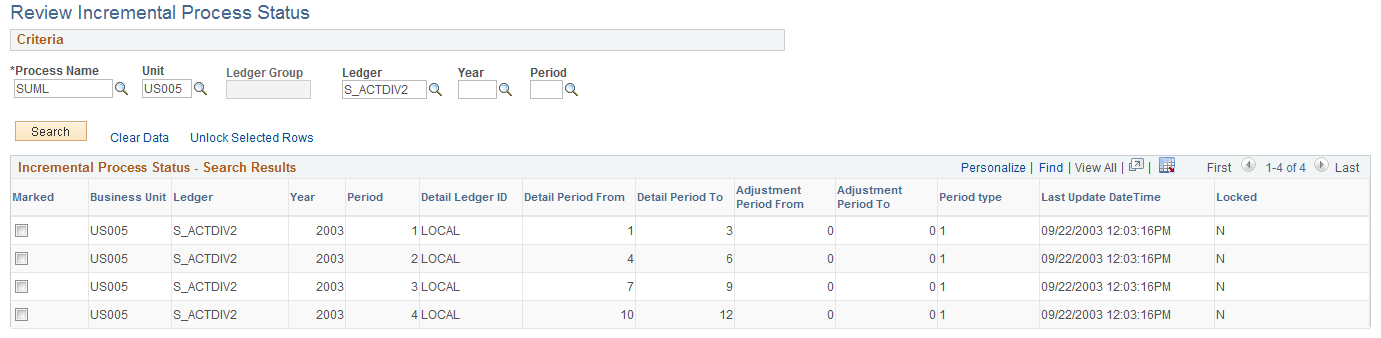

Review Incremental Process Status Page
SLED_STAT_INQ
View the status of an incremental process.

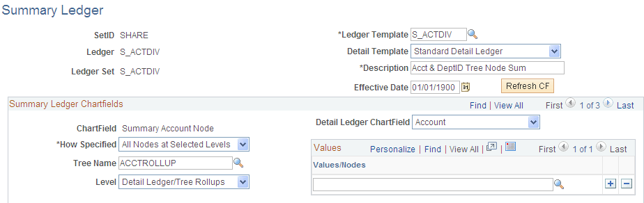

Summary Ledger Page
Use the Summary Ledger page (LEDGER_SUMMARY1) to specify the ledger template that defines the records and fields for the summary ledger and specify the ChartFields to summarize (after defining a summary ledger table that stores the summary balances).
Navigation:
General Ledger, and then Summary Ledgers, and then Define Summary Ledger, and then Summary Ledger
This example illustrates the fields and controls on the Summary Ledger page. You can find definitions for the fields and controls later on this page.
img/summary-ledger-page-pfspf92000.png
Summary ledgers support summarization of ADB (average daily balance) target ledgers. However, summarizing daily ledgers is not supported.
You can define Summary Ledgers across Commitment Control Ledgers using the associated detail template. Incremental updates though are not supported for Summary Ledgers.
Field or Control Description
Ledger Template
Select the summary ledger template.
Detail Template
Select the template that contains the detail ledgers that you are summarizing.
Refresh CF
Click this button to reset the summary ledger ChartFields.
Detail Ledger ChartField
Identify the detail ledger ChartField that you want to summarize.
Note: Be sure to define Currency Code as one of the fields to summarize as well as Statistics Code if you want to summarize statistics.
How Specified
Select from the following values:
All Detail Values: Retain detail ChartField values in that ChartField.
All Nodes at a Level: Summarizes every node at a selected tree level.
Children at a Level: Includes all tree nodes at a given tree level that are children of the specified tree nodes. In this case, you select the parent node names in the Values scroll area.
Detail - Selected Parents: and Selected Tree Nodes: Enter the tree to use (in Tree Name.) You can then select tree nodes (in Values/Nodes) that contain the detail values that you want to include in the summary ledger on the tree. The ledger includes all detail values summarized by that node. If you select a tree that uses levels, the system displays an optional Level edit box, enabling you to limit prompting in this field to selected levels.
Selected Detail Values: Select certain detail values (such as USA and Canada Sales departments, or all P&L accounts) in the Values/Nodes field.
The field length for the summary ledger ChartFields is a critical factor in defining a summary ledger. It is dependent on whether you specify the summary ledger ChartFields by using detail values or tree nodes.

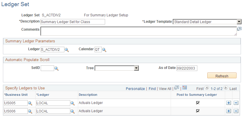

Ledger Set Page
Use the Ledger Set page (LEDGER_SET) to set up the business unit and ledgers for building the summary ledger.
Navigation:
General Ledger, and then Summary Ledgers, and then Associate Summary Ledger to BU
This example illustrates the fields and controls on the Ledger Set for Summary Ledgers - Ledger Set page. You can find definitions for the fields and controls later on this page.
Ledger Template
Select the Detail Ledger template that you identified on the Define Summary Ledger - Definition page with the summary ledger entered in Summary Ledger Parameters. You need only one ledger set for each defined summary ledger.
Select a summary ledger for this ledger set, and select the calendar to associate with this summary ledger. The selected calendar applies to all business units that share this summary ledger definition.
Automatic Populate Scroll
Select a tree value, enter an as-of (effective) date, and click Refresh. The system populates the Specify Ledgers to Use scroll area with the selected tree's business units that are valid as of the effective date and with their associated detail ledgers. You can modify the business unit or detail ledger on each row, and you can delete or add a row.
Select the Post to Summary Ledger check box to update the incremental summary ledger update during the Journal Post process. If you do not select this check box, run the summary ledger incremental process only from the Build Summary Ledger - Request page.
Note: Make sure that you select Enable Incremental Sum Ledgers on the Ledgers For A Unit - Journal Post Options page for the specific business unit and detail ledger.
If you enter an as-of date and click Refresh but do not select a tree value, the Specify Ledgers to Use scroll area displays only one row with one business unit; no detail ledger is selected.
In this case, you can:
  • Select a detail ledger to associate with the business unit.
  • Select a different business unit and ledger.
  • Add or delete data rows.
  • Select or leave blank the Post to Summary Ledgers check box.
The same rules apply as stated for the summary ledger set.
Click Save to associate the selected business units and detail ledgers with this summary ledger set.

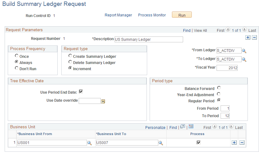

Build Summary Ledger Request Page
Use the Build Summary Ledger Request page (SUMMARY_REQUEST) to either creates a new summary ledger or performs the incremental update process.
Navigation:
General Ledger, and then Summary Ledgers, and then Build Summary Ledger, and then Build Summary Ledger Request
This example illustrates the fields and controls on the Build Summary Ledger Request page. You can find definitions for the fields and controls later on this page.
General Ledger uses the information that you entered on the Define Summary Ledger - Definition page and on the Ledger Set for Summary Ledgers - Ledger Set page to update summary ledger balances. After you define all of your requests, run the background process each time that you want to generate or update a summary ledger. Each time the system processes a summary request, it erases the results of any earlier summary request of the same period.
The Build Summary Ledger Request page enables you to specify one or more business units for summary ledger processing. This facilitates processing and improves performance, whether you process your business units by group or by individual business unit.
Fiscal Year
The year that the detail calendar uses to determine the summarized accounting periods.
Request Type
These options determine what you want the background process to do with the summary ledger.
Create
Select to first delete any existing summary ledger and then create a new summary ledger.
Delete
Select to delete an existing summary ledger.
Increment
Select to update the summary ledgers incrementally with changes made since the summary ledger was last created or updated. The process checks the status table for an appropriate entry in which to apply the increment. If an entry is found, the process performs the increment action and updates the status row. If no row is found, the Create process runs and inserts a status row.
Note: To use the Increment option, select Enable Incremental Sum Ledgers option on the Ledgers For A Unit - Journal Post Options page for the detail ledger group.
Tree Effective Date
These fields determine the use of the effective date.
Use Period End Date
Select to have the system use the version of the tree that is effective as of the end date of each period summarized.
Use Date override
Select any past or future date.
You typically run summary ledgers for a single period as part of your monthly closing, but you can also use this field to select a range of periods. The periods are determined by the summary or detail calendar associated with this ledger. If you select a range of ledgers and not all of the ledgers contain the requested periods, only the valid combinations run. On the message log, the system identifies the successful completion or an error for each combination that you select. For example, suppose that you select a range of ledgers where the first two use a monthly calendar and the third is based on a quarterly calendar. If you select period 6, the first two summary ledgers run successfully, and the system indicates that an error occurred while processing the third ledger because there is no period 6 in a quarterly calendar. Refer to the Ledgers For A Unit page or to the summary ledger set to verify which calendar the system uses for each summary ledger.
Business Unit
Identify the business units or range of business units for which to process the summary ledger.
Business Unit From and Business Unit To
Select a business unit or range of business units for summary ledger processing for a given request.
Process
Select the business units or groups of business units for summary ledger processing. Those business units or range of business units that are not selected will not be processed.
Period Type
You identify the period and whether its period is a balance forward period or a year end adjustment period.
Balance Forward
Select after each annual close to prepare for the new year's processing. General Ledger uses Period 0 to store balance-forward amounts. Summarize the beginning balances loaded during the implementation process so that they are available for summary reporting.
Year-End Adjustment
Select to summarize any adjustments that you entered. You typically summarize the year end adjustments before you run an annual close. If you select this option, you can specify the adjustment periods to include. Adjustment periods are not combined.

  2. On the Ledger Set for Summary Ledgers - Ledger Set page for the appropriate ledger set, select Post to Summary Ledger for any combinations that you want to run through the posting process.
    This option only allows summary ledger incremental updates. Whether the incremental updates actually occur depends on what you select for the Skip Summary Ledger Update option (see step 3).
Use the Review Incremental Process Status page (SLED_STAT_INQ) to view the status of an incremental process.
Navigation:
General Ledger, and then Monitor Background Process, and then Review Incremental Led Status
This example illustrates the fields and controls on the Review Incremental Process Status page.
Use this page to view incremental ledger status and search results for the criteria you select.
Process Name
Select an incremental process to review. Options are: GLCLOSE (Closing), MCURR (Multi-Currency), and SUML (Summary Ledger)
Clear Data
Click this link to clear and archive incremental record data for the selected rows.
Unlock Selected Rows
Click this link to unlock selected rows.
Marked
Select this check box to indicate which rows you want to clear or unlock.
Locked
Displays Y or N to indicate whether the record is locked and being used by an incremental process.
