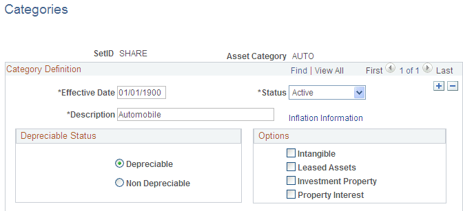

Categories Page
Use the Categories page (CATEGORY_DEFN) to establish asset categories, which classify assets by type for accounting entry purposes.
Typically, these categories reflect how assets are reported on balance sheets. Examples of commonly used asset categories are Furniture and Fixtures, Machinery and Equipment Office Equipment, Leasehold Improvements, and so forth.
Navigation:
Set Up Financials/Supply Chain, and then Product Related, and then Asset Management, and then Financials, and then Define Asset Categories
This example illustrates the fields and controls on the Categories page. You can find definitions for the fields and controls later on this page.
Categories page
Complete the appropriate fields for each asset category. Identify the depreciable status as Depreciable or Non Depreciable.You can optionally associate inflation processing information with the category.
See Setting Up Asset Profiles.
Options
These options drive the accounting entries to display in the accounting entry template. When possible, assign these options at the asset category level to alleviate this identification at the individual asset level. Identification at the category or profile level is also necessary for handling batch transactions where there is no use intervention.
Field or Control Description
Intangible
Select if the asset category applies to intangible assets.
Leased Assets
Select if the asset category applies to leased assets.
Related Lease Category
Select suitable lease category value from the given list. Only if Leased Asset option is selected this field is displayed. It denotes the default asset category assigned to assets upon lease reclassification. This is an optional field.
The default asset category assigned upon lease reclassification can be overridden at the asset level.
Investment Property
Select if the asset category applies to assets that are considered investment property as defined by International Accounting Standards (IAS) 40. This selection can be used in conjunction with the Leased Assets check box if the category applies to leased assets that are also investment property. However, you cannot select the Intangible check box and the Investment Property check box in combination. A warning message appears in the event that you select this invalid combination.
See Defining Investment Property.
Property Interest
Select if the asset category applies to an operating lease that meets the conditions for investment property as defined by IAS 40. Operating leases that fall under this category are not treated as operating leases according to Financial Accounting Standards (FAS) 13, which are normally expensed, but rather as capital leases for accounting purposes (capitalized and amortized over the lease term). The Leased Asset check box must also be selected when selecting this option. A message alert appears upon saving the page if the Property Interest check box is selected without the selection of the Leased Assets check box.

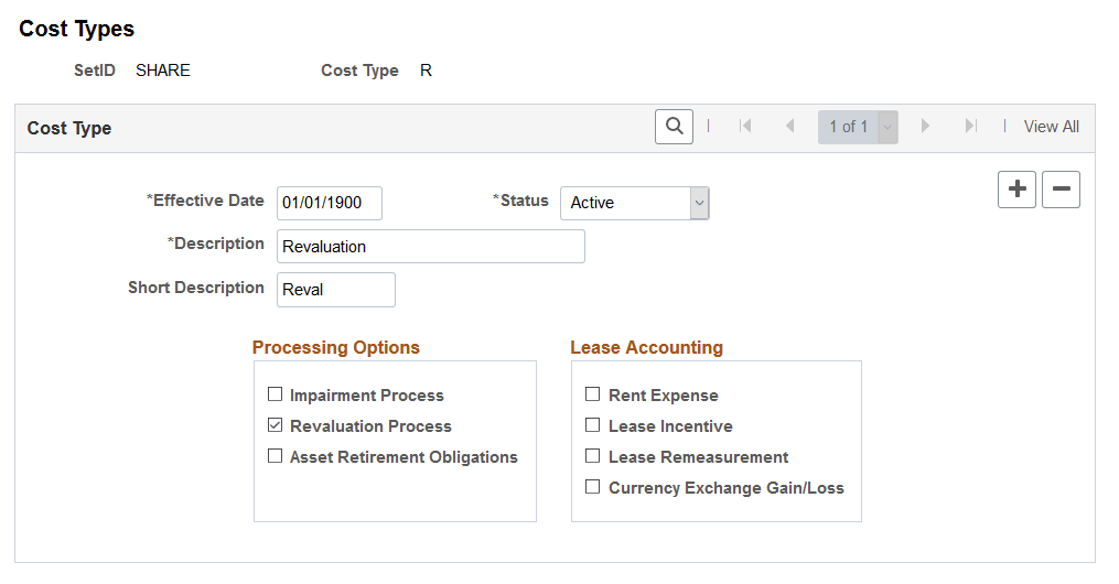

Cost Types Page
Use the Cost Types page (COST_TYPE_DEFN) to define cost types.
Navigation:
Set Up Financials/Supply Chain, and then Product Related, and then Asset Management, and then Financials, and then AM Cost Types, and then Cost Types
This example illustrates the fields and controls on the Cost Types page. You can find definitions for the fields and controls later on this page.
Cost Types Page
Impairment Process
Select to use this cost type for impairment. Selecting this check box displays impairment related accounts at the accounting entry template level. This field is not displayed if impairment options are not selected on the Installation Options - Asset Management page.
Note: This option cannot be selected with the Revaluation Process option for a single cost type.
Revaluation Process
Select to use this cost type for revaluation. Selecting this check box displays revaluation related accounts at the accounting entry template level. This field is not displayed if revaluation options are not selected on the Installation Options - Asset Management page.
Note: This option cannot be selected with the Impairment Process option for a single cost type.
Asset Retirement Obligations
Select to use this cost type for ARO (asset retirement obligation) processing. Selecting this check box displays ARO-related accounts at the accounting entry template level. This field is not displayed if ARO options are not selected on the Installation Options - Asset Management page.
Note: This option cannot be selected with the Impairment Process option or the Revaluation Process option for a single cost type.
Rent Expense
Select to use this cost type for rent expense.
Lease Incentive
Select to use this cost type for lease incentive.
Lease Remeasurement
Select to use this cost type for lease remeasurement.
Currency Exchange Gain/Loss
Select to use this cost type for currency exchange gains and losses.
When selecting a cost type for processing, you should update the accounting entry templates because new accounting entries need to be set up for these transactions.

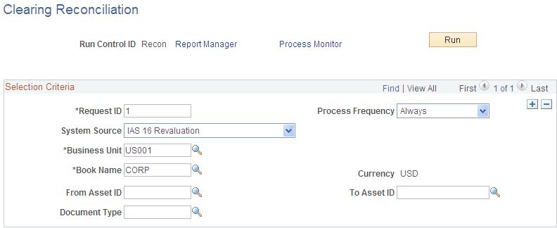

Clearing Reconciliation Page
When an asset is deemed trackable by the capitalization threshold process, the asset ID is generated but in fact no accounting activities take place. Additionally, when assets are added through feeder sources, it is likely to debit the Fixed Account and credit a Clearing account that was previously debited at the source accounting. The Clearing Reconciliation process provides a way to balance out (credit) the clearing account that was previously debited at the source product accounting and debit the expense account. This is not applicable to the trackable assets that are entered directly into Asset Management with no clearing account at all. In this instance, the expense account is most likely debited when the asset is added.
This process checks the non capital cost lines, determines the expense and clearing accounts from the accounting entry templates and inserts rows into the staging table (DIST_LN) to be loaded as journal entries into general ledger for posting.
Use the Clearing Reconciliation page (AM_CLEREC_RQST) to run the process to reconcile the clearing account that is created by trackable assets from feeder systems against the expense account.
Navigation:
Asset Management, and then Accounting Entries, and then Clearing Reconciliation
This example illustrates the fields and controls on the Clearing Reconciliation page. You can find definitions for the fields and controls later on this page.
This process creates the clearing accounting entries from the non capitalized assets that have the selected system source. For each non capital row that matches the criteria, an entry is generated in the DIST_LN table that credit the clearing account and debit the expense account according to the accounting entry template for the EX distribution type. This distribution type is available for the ADD and ADJ accounting entry templates for those template IDs that have the capitalization threshold enabled.
See PeopleSoft Asset Management: Understanding Accounting Entry Setup.
