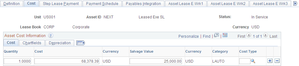

Express Add – Cost Page
ASSET_LEASE_02
Enter cost, ChartField, and depreciation data for a leased asset.
ASSET_LEASE_02
Update cost, ChartField, and depreciation data for a leased asset.

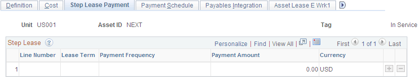

Express Add – Step Lease Payment and Update Lease Information – Step Lease Payment Pages
ASSET_LEASE_05
Enter a step-lease payment schedule.
ASSET_LEASE_05
Update a step-lease payment schedule.

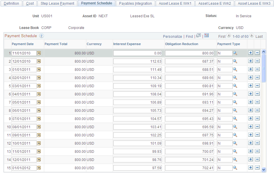

Express Add – Payment Schedule and Update Lease Information – Payment Schedule Pages
ASSET_LEASE_03
Create or view lease payment schedules.
ASSET_LEASE_03
Update lease payment schedules.

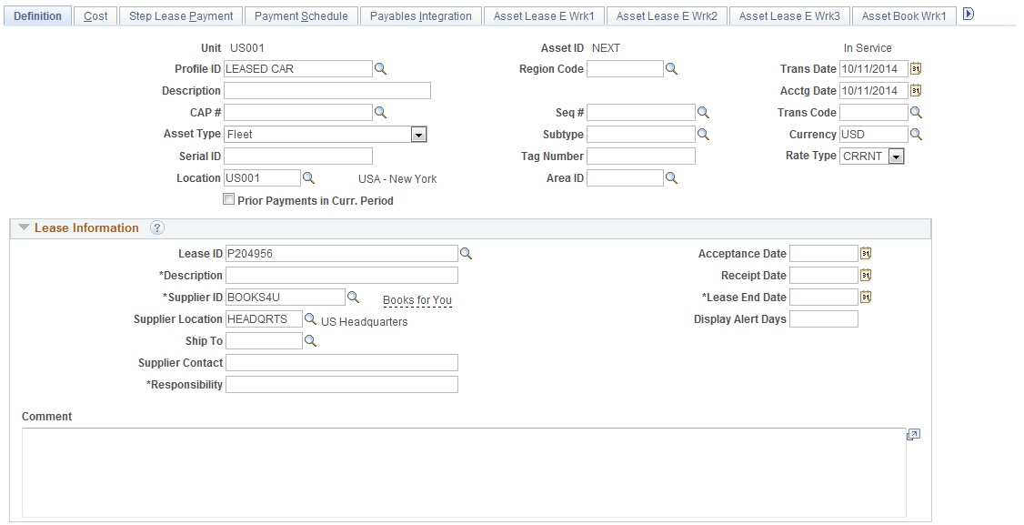

Express Add – Definition and Update Lease Information – Definition Pages
Use the Express Add - Definition page (ASSET_LEASE_01) to create a capital lease or an operating lease.
Navigation:
Asset Management, and then Asset Transactions, and then Leased Assets, and then Lease Express Add
Use the Update Lease Information - Definition page (ASSET_LEASE_01) to update a capital lease or an operating lease.
Navigation:
Asset Management, and then Asset Transactions, and then Leased Assets, and then Update Lease Information
This example illustrates the fields and controls on the Leased Assets - Express Add - Definition page (1 of 2). You can find definitions for the fields and controls later on this page.
Leased Assets - Express Add - Definition Page
This example illustrates the fields and controls on the Leased Assets - Express Add - Definition page (2 of 2). You can find definitions for the fields and controls later on this page.
Leased Assets - Express Add - Definition Page 2
Field or Control Description
Profile ID
Enter an ID if you want to use the default information from an asset profile to define this asset. You must enter a profile ID for a capital lease because all depreciation information is stored in the profile ID. A profile ID is not required for an operating lease.
Region Code
Select a region code from the available options.
Trans Date (transaction date) and Acctg Date (accounting date)
Enter a transaction date and accounting date for the lease. For leases, the payment date is based on the transaction date. For example, if a lease begins in October and you need to start the payments in the same month, enter a transaction date of October 1. The accounting date has no bearing on the payment date.
CAP # (capital acquisition planning number) and Seq # (sequence number)
Select the associated Capital Acquisition Plan number for this leased asset or look up the associated Asset ID Sequence number if one has been assigned.
Trans Code (transaction code)
Select the accounting entry template that is used for transactions relating to this asset.
Asset Type
Select the asset type from the available established values. You must enter Asset Type for operating leases if you do not enter a profile.
Subtype
Select the asset subtype from the available defined values for the selected Asset Type.
Currency
Select the currency for the transactions that are processed with this asset.
Serial ID
Enter the Serial ID that is associated with this asset. Serial IDs track physical inventory, especially for IT assets.
Tag Number
Enter the tag number that is associated with this asset. Tag numbers track physical inventory.
Note: To perform a physical inventory with PeopleSoft Asset Management, your assets must use tag numbers.
Rate Type
The exchange rate that is defined for the default book for the business unit appears by default in this field. You can select a different rate type.
Location
Select the location code from the available values.
Area ID
Select the area ID from the available values.
Asset Operational Information
Click this link to display the Define Asset Operational Information page. The link is visible only after saving the lease component.
Lease Information

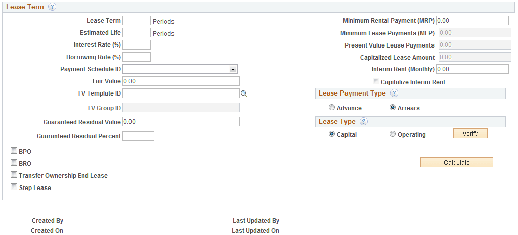

Lease Term
Lease Term
Enter the number of periods in this lease.
Estimated Life
The number of periods that you entered in Lease Term field appears by default. You can change this value.
Interest Rate (%) (interest rate percentage)
Enter the approximate percentage of profit the lessor gains by leasing the asset to you. This number must be an annual interest rate percentage in whole numbers.
Borrowing Rate (%)
Enter the interest rate that you would have incurred at the inception of the lease if you had borrowed the necessary funds to purchase the leased asset. This number must be an annual interest rate percentage in whole numbers.
Payment Schedule ID
If you want the system to define a lease payment schedule, enter a payment schedule ID. Capital leases must have a payment schedule ID. The values that you can select are set up on the Payment Schedule page when you specify the payment frequency and number of periods.
Fair Value
Enter the fair value. The system uses the fair value to verify the lease type. It also records this value on the AM_FMV table to use in the asset revaluation process. The system calculates the capitalized lease amount using the lesser of the Present Value Lease Payments and Fair Value field values.
If the present value of the lease payments is less than the fair value, the capitalized lease amount equals the present value of the minimum lease payment (MLP).
If the fair value is less than the present value of lease payments, the capitalized lease amount equals the fair value.
You might want to change the interest rate so that the net present value equals the fair value.
If you do not enter a fair value, the capitalized lease amount equals the present value of the MLP.
FV Template ID (fair value template ID)
Select a fair value template, which includes the valuation method, level and premise. If left blank, the fair value is created but the additional valuation information is not provided.
See Asset Lifecycle Management Fundamentals: Fair Value Templates Page.
FV Group ID (fair value group ID)
This field is active only when the selected FV Template ID has a valuation premise of In Use. The default value is supplied from the selected FV Template ID; however, you can override it and select another FV Group ID.
See Asset Lifecycle Management Fundamentals: Fair Value Groups Page.
Guar. Residual Value (guaranteed residual value)
Calculates depreciation based on the amount of the residual value of the leased asset that is guaranteed by the lessee to the lessor and considered as part of the minimum lease payments.
Guaranteed Residual Percent
Calculates depreciation based on the percent of the residual value of the leased asset that is guaranteed by the lessee to the lessor and considered as part of the minimum lease payments.
BPO (bargain purchase option)
Select if this lease includes a bargain purchase option, which represents a payment by the lessee to the lessor at the end of the lease term, allowing the lessee to obtain title to the leased property.
BRO (bargain renewal option)
Select if this lease includes a bargain renewal option, which requires a payment if the lease agreement grants the lessee the right to renew or extend the lease. If the agreement specifies that the lease must be renewed or extended, a penalty might be required for failure to renew.
Transfer Ownership end lease
Check if there is an ownership transfer of the asset at the end of the lease period.
Step lease
Select if the lease is a step lease. A step lease features variable payment amounts and/or variable timing over the term of the lease.
Capitalized Lease Amount
Enter the cost. The system uses the following method to calculate lease payments:
Capitalized Lease Amount - Prior Obligation Reduction = Residual Capitalized Lease Amount
Residual Lease Amount × (Annual Implicit Interest Rate / Number of Periods per Year) = Interest Expense per Period
Interest Expense per Payment + Obligation Reduction = MRP
For example, this table illustrates a full payment schedule for a simple capital leased asset with a capitalized amount of 10,500 USD, an interest rate of 7 percent, a monthly payment of 908.53 USD, and 12 periods per year:
Period Residual Capitalized Lease Amount in USD Obligation Reduction Interest Expense Payment in USD
1
10,500.00
847.2800562
61.24994377
908.53
2
9,652.71
852.2225232
56.30747678
908.53
3
8,800.49
857.1938213
51.33617873
908.53
4
7,943.29
862.1941186
46.33588144
908.53
5
7,081.10
867.2235843
41.30641574
908.53
6
6,213.88
872.2823885
36.2476115
908.53
7
5,341.59
877.3707024
31.15929757
908.53
8
4,464.22
882.4886982
26.0413018
Interim Rent (Monthly)
Enter the amount of monthly interim rent for a capital or operating lease. Interim rent is common for quarterly leases. Interim rent starts on the acceptance date and ends on the commencement date of the lease. Once the lease officially begins, the normal rental payment amount is tracked by the lease payment schedule.
PeopleSoft Asset Management prorates the first month of interim rent. You can see interim rent payments on the Express Add - Payment Schedule page (ASSET_LEASE_03).
Select Capitalize Interim Rent if you want to include these interim payments as part of your asset cost.
Note: You must post journal entries for interim rent each month by running the Depreciation Close process (AM_DPCLOSE).
Select this check box to capitalize. When selected, the interim rent is added to the cost of the leased asset.
Calculate
Click to have the system calculate the lease payment schedule.
Before the system can calculate the lease payment schedule, you must have:
  • Defined a payment schedule.
  • Entered (for leases other than step leases) the minimum rental payment on this page or entered cost information on the Express Add - Cost page.
  • For step leases, entered payment information on the Express Add - Step Lease Payment page.
    You can see the results of the calculation on the Express Add - Payment Schedule page.
Lease Payment Type
Select a payment type: Advance or Arrears. You can use either type for both capital leases and operating leases. More details on these two payment types are provided in this table:
Calculation Advance Payment Type Arrears Payment Type
Present Value Factor
Total payment terms for present value factor excludes the term of the advance (or first) payment.
Total payment terms for present value factor equal the total terms of the lease.
Present Value of Minimum Lease Payments
Equals: (Present Value Factor × Periodic Payment Amount) + Advance payment.
Equals: Present Value Factor × Periodic Payment Amount.
Amortization Schedule
Period interest expense equals: Capitalized Amount × the period interest rate.
The Capitalized Amount used for the first period of the payment excludes the advance payment amount.
Advance
Select if an asset is leased with the first payment that is due before the lease begins. For advance payments, the interest expense is not calculated.
If the present value is calculated on a lease with 12 monthly payments of 100.00 USD and an interest rate of seven percent, then the calculated present value factor is 10.6254.
Calculated present value = 100 USD + 10.6254 × 100 = 1,162.54 USD
Arrears
An arrears payment type means that an asset is leased with the payment due at the end of the period. This is the lease payment type by default. If the present value is calculated on a lease with 12 monthly payments of 100.00 USD and an interest rate of seven percent, then the calculated present value factor is 11.5571.
Calculated present value = 11.5571 × 100 = 1,155.71 USD
Lease Type
When you select the lease type, you can verify that you have selected the correct lease type for a country. If you do not select either the Capital or the Operating options, the system selects the lease type for you. The system can verify the lease types for the U.S., Canada, Germany, and Australia. Canada uses the same criteria as the U.S. for classifying capital and operating leases. Germany uses a higher threshold for the lease term (90 percent instead of 75 percent).
You cannot change a lease type from capital to operating or from operating to capital. If you must change the lease type, you must first retire the leased asset and then reenter the lease with the appropriate lease type.
Capital
Select if the lease is a capital lease.
According to FAS13, a capital lease must meet one of the following criteria:
  • There is an ownership transfer at the end of the lease.
  • The lease contains a bargain purchase option (BPO).
  • The lease term is 75 percent or more of the asset life.
    In Germany, the lease term is 90 percent of the leased asset's economic life.
  • The present value of the minimum lease payment is 90 percent or more of the fair value of the asset.
Operating
Select if the lease is an operating lease.
Verify
Click this button to verify if the lease meets the criteria for a capital lease or an operating lease. If the lease type meets the criteria, the system displays a message confirming that the criteria for FAS13 has been met. If you do not select the Capital or Operating option before clicking the Verify button, the system looks at the information that you have entered on this page about the lease, including the country code, and selects the lease type for that country.
Note: This verification test is disabled for leased assets that use an Indian business unit; designation of capital or operating leases is manual for assets in India.
See (IND) Using PeopleSoft Asset Management Options to Meet Indian Requirements.
Use the Express Add - Cost page (ASSET_LEASE_02) to enter cost, ChartField, and depreciation data for a leased asset.
Navigation:
Asset Management, and then Asset Transactions, and then Leased Assets, and then Express Add, and then Cost
Use the Update Lease Information - Cost page (ASSET_LEASE_02) to update cost, ChartField, and depreciation data for a leased asset.
Navigation:
Asset Management, and then Asset Transactions, and then Leased Assets, and then Update Lease Information, and then Cost
This example illustrates the fields and controls on the Cost page. You can find definitions for the fields and controls later on this page.
Cost page
If you did not enter a minimum rental payment (MRP) on the Definition (ASSET_LEASE-01) page, you must complete the cost information on this page.
The system uses the cost information on this page to calculate the lease payment schedule. Use the Cost, Chartfields, and Depreciation tabs to enter more details. Because the ChartFields are effective-dated, you can use them to track transfers.
If you are working with a step lease, you do not have to enter any information on this page.
Use the Express Add - Step Lease Payment page (ASSET_LEASE_05) to enter a step-lease payment schedule.
Navigation:
Asset Management, and then Asset Transactions, and then Leased Assets, and then Express Add, and then Step Lease Payment
Use the Update Lease Information - Step Lease Payment page (ASSET_LEASE_05) to update a step-lease payment schedule.
Navigation:
Asset Management, and then Asset Transactions, and then Leased Assets, and then Update Lease Information, and then Step Lease Payment
This example illustrates the fields and controls on the Step Lease Payment page. You can find definitions for the fields and controls later on this page.
If you checked the Step lease check box on the Definition (ASSET_LEASE-01) page, you can use this page to change payment information.
Enter a line number, enter the lease term (number of periods), select a payment frequency, and enter a payment amount. For example, you could define a step lease that consists of six monthly payments of 400.00 JPY followed by 18 monthly payments of 350 JPY.
If you are defining a skip payment, enter a payment frequency, the number of lease terms, and a payment amount of zero (0.00).
The line numbers must be in sequential order. For example, if you update a lease schedule and need to insert a row between lines 1 and 2, you can use a line number such as 1.2.
After you are done working with this page, you must return to the Definition (ASSET_LEASE-01) page and click the Calculate button to generate the lease payment schedule.
Use the Express Add - Payment Schedule page (ASSET_LEASE_03) to create or view lease payment schedules.
Navigation:
Asset Management, and then Asset Transactions, and then Leased Assets, and then Express Add, and then Payment Schedule
Use the Update Lease Information - Payment Schedule page (ASSET_LEASE_03) to update lease payment schedules.
Navigation:
Asset Management, and then Asset Transactions, and then Leased Assets, and then Update Lease Information, and then Payment Schedule
This example illustrates the fields and controls on the Payment Schedule. You can find definitions for the fields and controls later on this page.
Payment Schedule
The system calculates the payment schedule on this page when you click the Calculate button on the Express Add - Definition page.
You can update the information on this page as needed.
In case of capitalizing the interim rent, payments are noted with a C rather than I next to the payment line. You can change this designation by modifying message number 8015,37, using the PeopleTools Message Catalog.
If you elect to process periodic depreciation accounting entries, the system creates the journal entries that are shown in the following table:
Action Debits Credits
Add
  • AD Accumulated Depreciation
  • FA Leased property under capital leases (capitalized lease amount)
  • DE Depreciation Expense
  • LO Obligations under capital leases
Adjust
Transfer In
Transfer Out
Retire
  • CA Proceeds [Proceeds]
  • LO Obligations under capital leases [Guaranteed Residual]
  • AD Accumulated Depreciation [Current Reserve]
  • LO Obligations under capital leases [Remaining Lease Payments]
  • LG Guaranteed Residual Payable [Guaranteed Residual]
  • FA Leased property under capital leases [Current Cost]
  • GL Gain/Loss on leased property [Remaining Payments + ((Proceeds − Removal Cost) + (Cost − Reserve))
