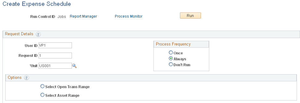

Create Expense Schedule Page
Use the Lease Expense Schedule page (LEASE_SCHED2_RQST) to run the lease expense schedule process.
Navigation:
Asset Management, and then Asset Transactions, and then Leased Assets, and then Create Expense Schedule, and then Create Expense Schedule
This example illustrates the fields and controls on the Create Expense Schedule page. You can find definitions for the fields and controls later on this page.
Field or Control Description
Select Open Trans Range (select open transaction range)
If you select this option, use the From Open Trans and To Open Trans fields to select a range of transaction values.
Select Asset Range
If you select this option, use the From Asset and To Asset fields to select the asset range.
