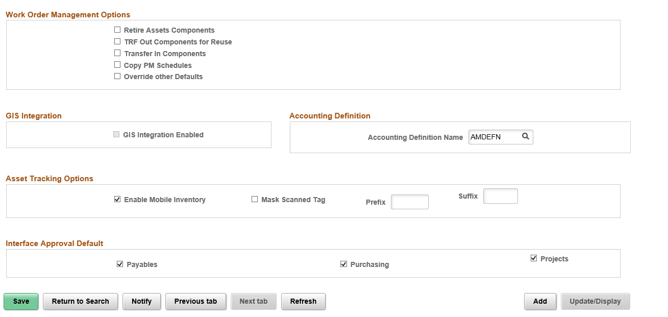

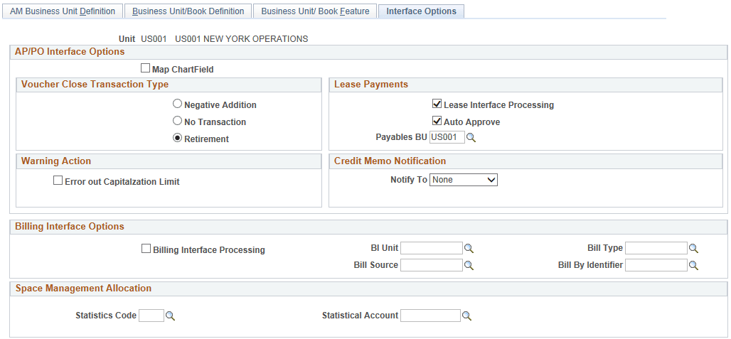

Asset Management Definition - Interface Options Page
Use the Asset Management Definition - Interface Options page (BUS_UNIT_INTFC_OPT) to enable the Asset Management lease payment integration with PeopleSoft Payables for a business unit.
Navigation:
Set Up Financials/Supply Chain, and then Business Unit Related, and then Asset Management, and then Asset Management Definition, and then Interface Options
This example illustrates the fields and controls on the Interface Options page (1 of 2). You can find definitions for the fields and controls later on this page.
Interface Options Page (1 of 2)
This example illustrates the fields and controls on the Interface Options page (2 of 2). You can find definitions for the fields and controls later on this page.
Interface Options Page (2 of 2)
The lease payment integration sends to Payables the information that is stored in the book that is defined as the Lease Book on the AM Business Unit Definition page.
Enable the lease payment integration for the business unit by selecting the Lease Interface Processing check box. Additionally, select whether to auto approve vouchers and enter the default Payables business unit on the Interface Options page.
Enter a value for the Accounting Definition Name field for the selected business unit. This field provides a default value for the Accounting Definition Name field on the:
  • Pending Journal Generator page (AM WorkCenter)
  • Create Accounting Entries page
  • Close Depreciation page
The Accounting Definition Name field is optional for the Create Accounting Entries and Close Depreciation pages, but required for the Pending Journal Generator page in the AM WorkCenter. The Pending by Business Unit grid requires this default value and Journal Generator cannot be run from the page without it.
See Asset Lifecycle Management Fundamentals: Interface Options Page.

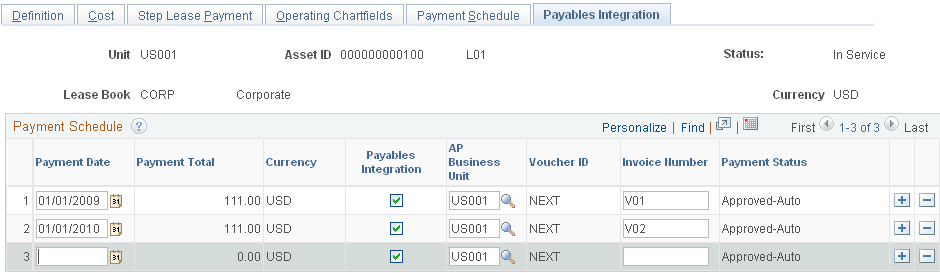

Payables Integration Page
Use the Payables Integration page (ASSET_LEASE_07) to select Payables integration information by asset for each scheduled payment.
Navigation:
Asset Management, and then Asset Transactions, and then Leased Assets, and then Express Add, and then Payables Integration
or
Asset Management, and then Asset Transactions, and then Leased Assets, and then Update Lease Information, and then Payables Integration
This example illustrates the fields and controls on the Payables Integration page. You can find definitions for the fields and controls later on this page.
Field or Control Description
Payment Date
The default payment dates are populated from the Payment Schedule page. You can update the payment dates as needed.
Payment Total
Displays the payment amounts that are established on the Payment Schedule page. This field is not editable.
Select only those lines that you want to forward to Payables for payment. If a line is not selected, then the other fields are not editable. By default, this check box is selected for every line for which the business unit has been enabled for integration with Payables.
AP Business Unit
Displays the default Payables business unit from the business unit level (Interface Options page). You can enter a different business unit (there are some cases where multiple Payables business units pertain to the same AM business unit).
Voucher ID
Displays the PeopleSoft Payables voucher ID once the transaction has been processed by the integration and Payables has created the voucher.
Invoice Number
(Optional) Enter the invoice number to appear in the Payables voucher.
Payment Status
Displays the integration status. Valid values for this field are:
  • Approved-Auto - Initial status when the Auto Approve check box is selected at the business unit level (Interface Options page). Transaction has not yet been processed.
  • Pending Approval - Initial status when the Auto Approve check box is not selected at the business unit level (Interface Options page). Transactions with this status must be approved before processing.
  • Approved - Transaction is approved and ready for integration processing to Payables.
  • Error - Transaction did not process successfully.
  • In Process - Transaction is currently being processed by the integration to Payables.
  • On Hold - Transaction has intentionally been detained from processing to Payables.
  • Processed - Transaction has been successfully processed through the integration to Payables and the voucher has been created.
  • Sent to AP - Transaction has been successfully processed through the integration to Payables.
  • Cancelled - Transaction has been intentionally omitted from processing. This is for tracking purposes since deselecting the Payables Integration check box produces the same outcome.
When a transaction is approved or processed through the integration, the transaction line is no longer editable. All fields are unavailable except the Voucher ID field, which becomes link to the corresponding voucher within PeopleSoft Payables. The voucher information is access through a new window.

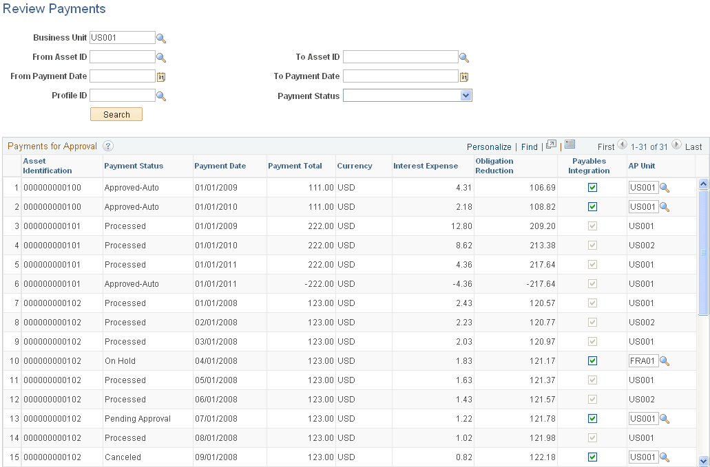

Review Payments Page
Use the Review Payments page (LEASE_INTFC_REVW) to review lease payment information and payment status for scheduled or processed lease payments to Payables.
Navigation:
Asset Management, and then Send/Receive Information, and then Approve Lease Information, and then Review Lease Payments
This example illustrates the fields and controls on the Review Payments page. You can find definitions for the fields and controls later on this page.
Use the Review Payments page to review the integration status of the lease payments, select or deselect to send payments through the Payables Integration process and change the Payables business unit, if needed, for payments that are not yet approved or processed.
Select the desired parameters and click the Search button to retrieve payments for review.
Asset Identification
Displays the asset ID for the lease payment based on the criteria that you provide.
Payment Status
Displays the payment status.
See Payables Integration Page.
Select those lines that you want to forward to Payables for payment. If a line is deselected, then the other fields are not editable. By default, this check box is selected for every line for which the business unit has been enabled for integration with Payables.
AP Unit
Select a different Payables business unit for a transaction, if necessary, and save the page.

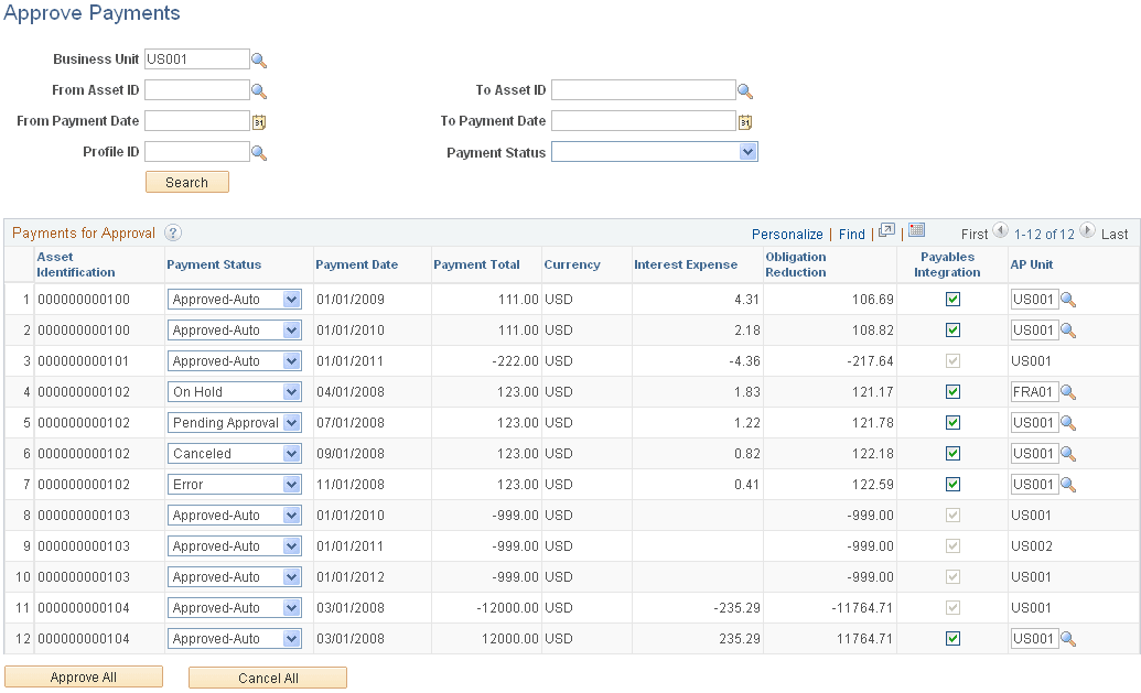

Approve Payments Page
Use the Approve Payments page (LEASE_INTFC_APPR) to review and approve lease payments that are scheduled to interface with Payables (if the pre-approval option is not enabled for the business unit).
Navigation:
Asset Management, and then Send/Receive Information, and then Approve Lease Information, and then Approve Payments
This example illustrates the fields and controls on the Approve Payments page. You can find definitions for the fields and controls later on this page.
Use the Approve Payments page to review, approve, or change the payment status of the lease payments. This page is similar to the Review Payments page except that you can change the payment status on this page.
Select the desired parameters and click the Search button to retrieve payments that are eligible for approval.
Payment Status
Displays the current payment status. Select to approve or change the current payment status of the lease payment.
Override the current payables integration selection. Select lines that you want to forward to Payables for payment. Deselect to keep a transaction from being sent through the integration process. Once deselected, the payment will not show up again in a future search.
AP Unit
Override the Payables business unit for a transaction, if necessary, and save the page.

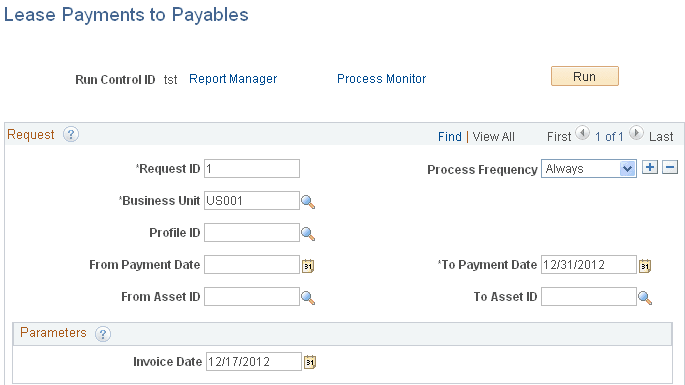

Lease Payments to Payables Page
Use the Lease Payments to Payables page (AMAPLEAPMT_RQST) to run the Lease Payments to Payables (AMAPLEASE) Application Engine process.
Navigation:
Asset Management, and then Send/Receive Information, and then Load Interface, and then Lease Payments to Payables
This example illustrates the fields and controls on the Lease Payments to Payables. You can find definitions for the fields and controls later on this page.
Run the Lease Payments to Payables (AMAPLEASE) Application Engine process. Select the criteria for the lease payments to process for the integration.
This process populates the voucher build integration tables with the necessary information for Payables processing. Payables then continues to process the lease payments from the voucher build staging tables to create the corresponding vouchers. When the vouchers are generated, Payables inserts the voucher ID and line number into the Asset Management records. The lease payment information is reflected in the asset-related fields at the distribution level.
The lease ID is displayed on the Invoice Information page within Payables.
See Integrating Lease Payments with PeopleSoft PayablesPeopleSoft Payables: Entering Invoice Information for Online Vouchers.
To avoid the potential risk of resending these payments to Asset Management as adjustments to existing assets, Payables assigns a unique origin source for vouchers that are created from the lease payment integration with Asset Management.
Business Unit
Select the Asset Management business unit from which to process payments. The default value is the business unit that is specified within user preferences.
Profile ID
(Optional). Select to limit integration processing to a specific profile. Only profiles that are associated with leased assets are available.
Invoice Date
Select the date to be displayed on the Payables voucher. If blank, the system supplies the default system date.

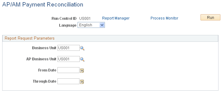

AP/AM Payment Reconciliation Page
Use the AP/AM Payment Reconciliation page (AMAPLEAPMT_RQST) to run the AP/AM Payment Reconciliation report.
Navigation:
Asset Management, and then Financial Reports, and then Leased Assets, and then AP/AM Payment Reconciliation, and then AP/AM Payment Reconciliation
This example illustrates the fields and controls on the AP/AM Payment Reconciliation run control page. You can find definitions for the fields and controls later on this page.
Run the AP/AM Payment Reconciliation (AMAP1001 ) report. The reconciliation process compares information about the lease payments from the Asset Management tables with the voucher information that is stored in the Payables tables. The resulting report includes the Asset Management lease payment schedule with payment statuses along with the corresponding Payables voucher information, such as voucher ID, invoice date, payment amount, voucher status and payment status.
Business Unit
Select the Asset Management business unit for which to process the reconciliation report. You can select from the business units for which the integration is enabled.
AP Business Unit
(Optional). Select the Payables business unit for which to process the reconciliation report information.
From Date and Through Date
(Optional). Select the date range for which to run the reconciliation report.
