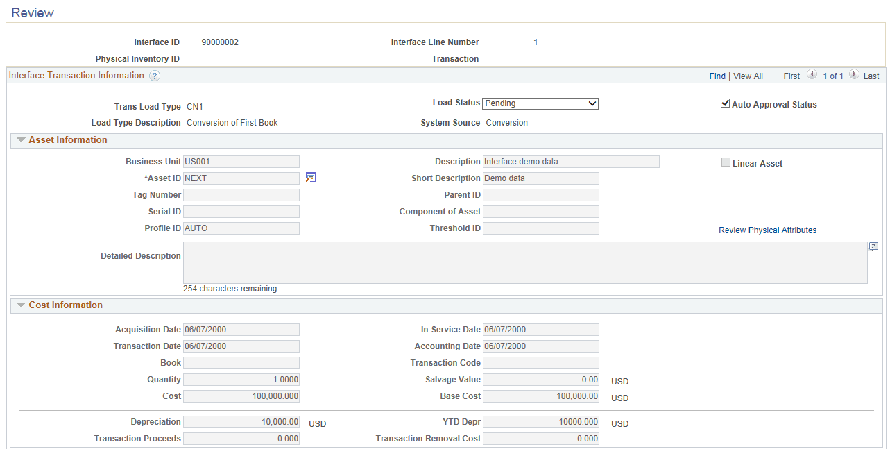

Review Page
Use the Review page (AM_INTFC_TXN_RVW) to view data in the interface tables.
Verify the financial and physical data (which the Transaction Loader process uses when populating Asset Management tables) and change incorrect data.
Navigation:
Asset Management, and then Send/Receive Information, and then Interface Transactions, and then Review Interface Transactions
This example illustrates the fields and controls on the Review Page (1 of 2). You can find definitions for the fields and controls later on this page.

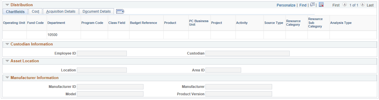

This example illustrates the fields and controls on the Review Page (2 of 2). You can find definitions for the fields and controls later on this page.
If the Load Type has changed because of an Asset Id change, a Warning icon will appear next to the Load Type to let the user know the actions they performed caused a change in the Load Type.
The fields will be available for editing based on the interface type, load status and User Preferences.
