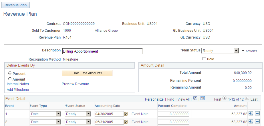

Revenue Plan Page
Use the Revenue Plan page (CA_ACCTPLAN) to define a revenue plan for contract lines in which revenue is managed by PeopleSoft Contracts.
Place revenue plans on hold from this page.
Navigation:
Customer Contracts, and then Schedule and Process Revenue, and then Define Revenue Plan
This example illustrates the fields and controls on the Revenue Plan page. You can find definitions for the fields and controls later on this page.
Revenue Plan page
Field or Control Description
Plan Status
Controls your ability to enter information into, and the processing that occurs against, the revenue plan. The available revenue plan status that you can control are: Pending, Ready, Completed, and Cancelled.
Hold
Select to place this revenue plan on hold. Any revenue recognition activity associated with this plan is not processed. You can view plans that are on hold from the revenue management page; however, you can only initiate and remove a hold on a revenue plan from this page. This option is not available on revenue plans with a Pending status.
If there is a credit hold on a customer in PeopleSoft CRM, then the contract administrator must set the revenue plan to hold to prevent transactions from occurring. If the Hold check box is selected, then the contract administrator must manually release the hold when revenue can again be recognized.
PeopleSoft CRM transactions cannot be processed while the revenue plan is on hold.
For PeopleSoft CRM transactions where PeopleSoft Contracts manages revenue, the revenue method is As-incurred. This page is not available for recurring and on-demand transactions.
See Understanding Revenue Plans.

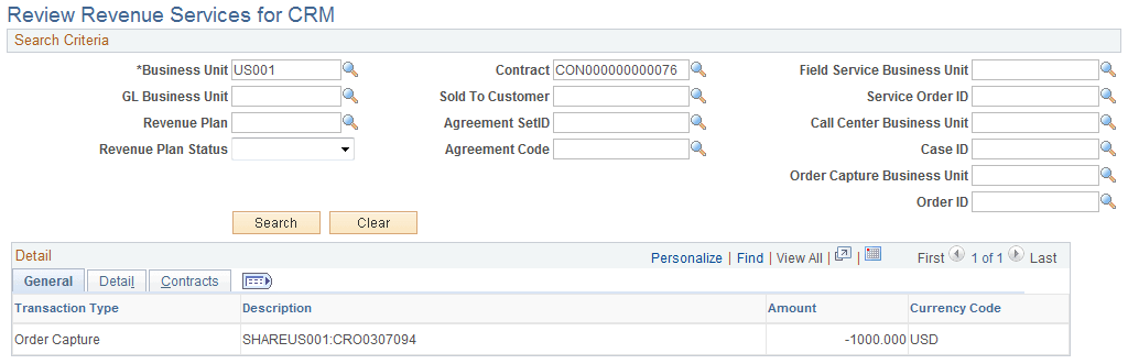

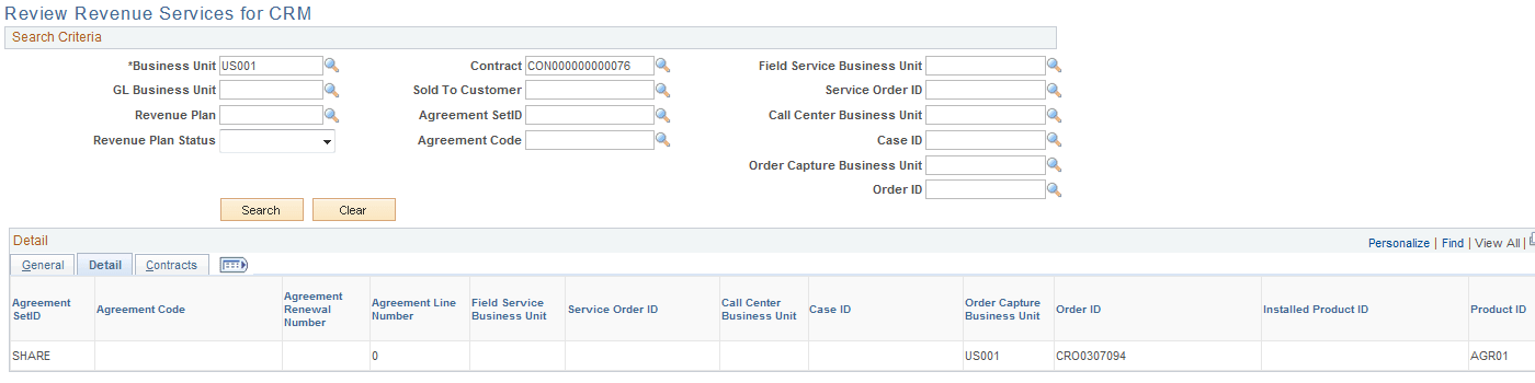

Review Revenue Services for CRM Page
Use the Review Revenue Services for CRM page (CA_AP_MGMT_AI_CRM) to review revenue plans with the As-incurred revenue recognition method for PeopleSoft CRM.
Navigation:
Customer Contracts, and then Review Revenue, and then Review Revenue Services CRM
This example illustrates the fields and controls on the Review Revenue Services for CRM page. You can find definitions for the fields and controls later on this page.
Use the fields in the Search Criteria group box to filter your search results by entering specific values in these fields. If you leave all fields blank, the search returns all revenue plans for all active contracts within your system.
This page is available for PeopleSoft CRM transactions with an As-incurred revenue recognition method. This page is not available for recurring and on-demand transactions.
Review Revenue Services for CRM: General Tab
Transaction Type
Indicates the type of PeopleSoft CRM transaction. Values may include: Agreement, Service Order, Order Capture, and Case.

Review Revenue Services for CRM: Detail Tab
Select the Detail tab.
This example illustrates the fields and controls on the Review Revenue Services for CRM page: Detail tab. You can find definitions for the fields and controls later on this page.

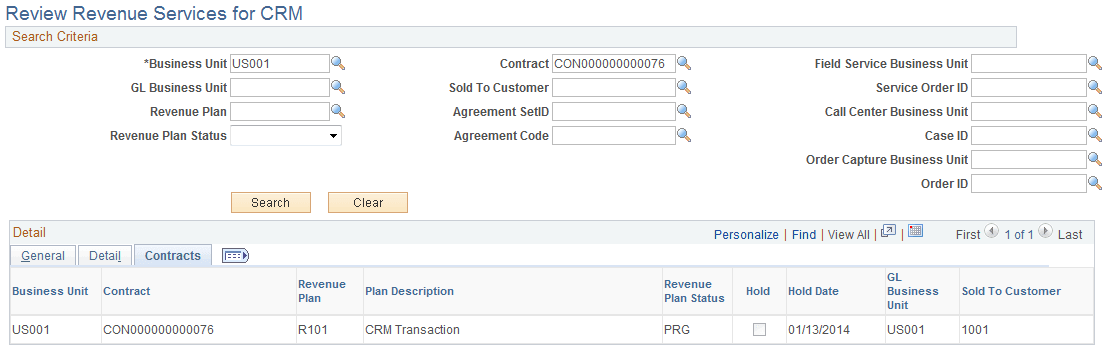

Review Revenue Services for CRM: Contract Tab
Select the Contract tab.
This example illustrates the fields and controls on the Review Revenue Services for CRM page: Contract tab. You can find definitions for the fields and controls later on this page.
Business Unit
Displays the PeopleSoft Contracts business unit associated with the revenue plan.
Contract
Displays the contract associated with the revenue plan.
Revenue Plan
Displays the revenue plan.
Revenue Plan Status
Displays the status of the revenue plan.
Hold
Indicates whether this revenue plan has been placed on hold.
Hold Date
Displays the date that the revenue plan was placed on hold.
GL Business Unit
Displays the PeopleSoft General Ledger business unit associated with this revenue plan.
Sold To Customer
Displays the customer buying the products and services specified on the contract that is associated with this revenue plan.

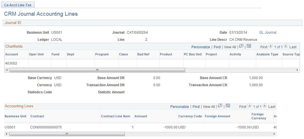

CRM Journal Accounting Lines Page
Use the Ca Acct Line Txn (CRM Journal Accounting Lines) page (CA_ACCT_LINE_TXN) to review PeopleSoft CRM contract line journal entry details for one-time transactions.
Inquire about the accounting entries after you have run the Accounting Rules Engine and your accounting entries have gone through the Journal Generator Update process and have been posted to the general ledger.
Navigation:
Customer Contracts, and then Review Revenue, and then CRM Jrnl Acctg Lines
This example illustrates the fields and controls on the CRM Journal Accounting Lines page (credit entry). You can find definitions for the fields and controls later on this page.
This example illustrates the fields and controls on the CRM Journal Accounting Lines page (debit entry). You can find definitions for the fields and controls later on this page.
Your contract accounting entries must have posted successfully to the GL by the Journal Generator process to view them here.
No data appears on this page for transactions where PeopleSoft Billing Manages revenue. PeopleSoft Billing handles the booking of the revenue for recurring and on-demand transactions.

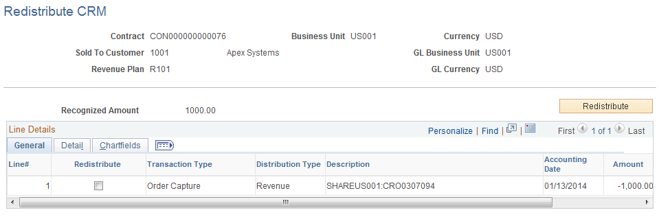

Redistribute CRM Page
Use the Redistribute CRM page (CA_AP_CRM_SUMMARY) to redistribute revenue accounting lines that the system has generated for an as-incurred revenue plan.
The system limits redistribution of revenue to departments only.
Navigation:
Customer Contracts, and then Adjust Revenue and Billing, and then Redistribute CRM
This example illustrates the fields and controls on the Redistribute CRM page. You can find definitions for the fields and controls later on this page.
This page is available for PeopleSoft CRM transactions with an as-incurred revenue recognition method. This page is not available for recurring and on-demand transactions.
Recognized Amount
Amount of revenue that has been recognized to date for this revenue plan. You can redistribute only revenue that has already been recognized.
Redistribute
After you have selected the transactions or entries that you want to redistribute, click this button to initiate the redistribution process.
CRM Redistribution: General Tab
Line# (line number)
Displays the contract line number that you associated with the revenue plan for this transaction. A contract line can have multiple transactions.
Redistribute
Select this check box to redistribute revenue for the row.
Transaction Type
Distribution Type
Each different type of accounting distribution entry is distinguished by distribution type. Examples include revenue, contract liability, contract asset, interunit credit, and interunit debit.
Accounting Date
Displays the accounting date, which reflects the accounting period in which the entries were booked.
Amount
Displays the amount of revenue, in the PeopleSoft General Ledger business unit's base currency that was booked for this row.

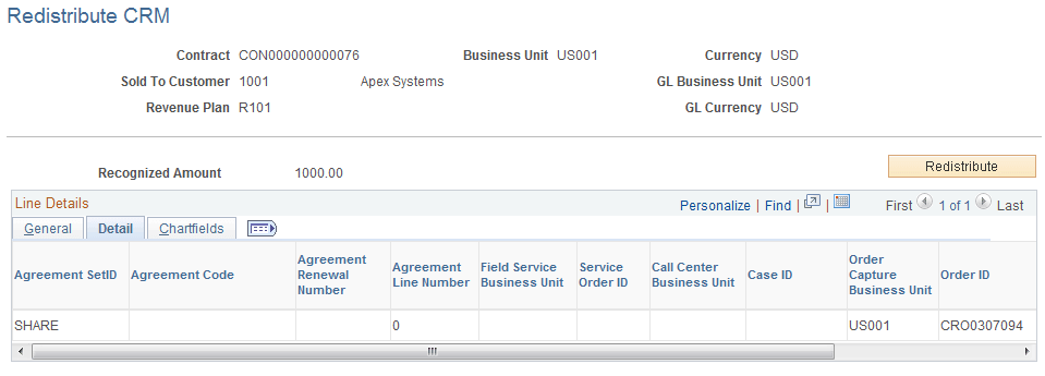

Redistribute CRM: Detail Tab
This example illustrates the fields and controls on the Redistribute CRM: Detail tab. You can find definitions for the fields and controls later on this page.
