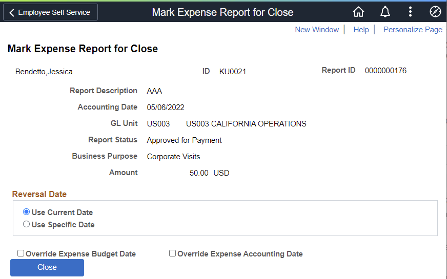

This example illustrates the fields and controls on the Mark Expense Report For Close page
Mark Expense Report for Close

Reversal Date
Field or Control Description
Use Current Date
Select to use the current date on which to reverse the accounting liability entries.
Use Specific Date
Select to enter a specific date. When selected, PeopleSoft Expenses opens a field to enter the day on which to reverse the accounting liability entries.
Override Expense Budget Date
Select to override the expense budget date at the distribution level with the close reversal date. This allows organizations who have closed their prior budget periods to account the budget reversals in the current fiscal period, as opposed to reopening the prior budget period.
This option is only available with Commitment Control is installed and being used for Expenses at the installation level, and the General Ledger business unit is using Commitment Control at the business unit definition level.
Override Expense Accounting Date
Select to override the accounting date at the header level with the close reversal date. This allows organizations who have closed their prior budget periods to account the budget reversals in the current fiscal period, as opposed to reopening the prior budget period.
Close
Click to access the Close Expense Report Page and confirm that you want to close the expense report.
