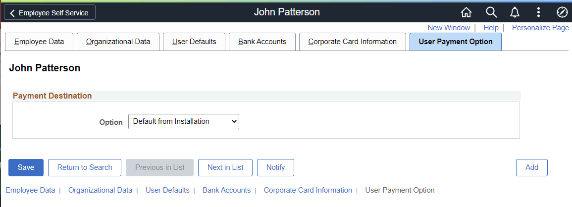

User Payment Option Page
Use the User Payment Option page (EX_USER_PYMNT) to determine the source of expense payments for an employee.
Navigation:
This example illustrates the fields and controls on the User Payment Option page.
| Field or Control | Description |
Option |
Select one of these options, which is used during the Stage Payments process:
The system default is Default from Installation. Note: When you run the Load Employee Data process to update employee data from PeopleSoft Human Capital management, the system automatically defaults this value to Default from Installation. See Integrating With PeopleSoft Human Resources. |
