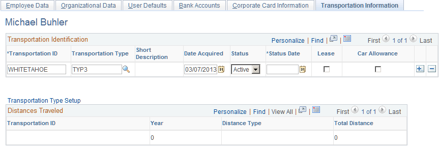

This example illustrates the fields and controls on the Employee Profile - Transportation Information page. You can find definitions for the fields and controls later on this page.
Transportation Identification
Field or Control Description
Transportation ID
Provide a description of the transportation type. After you enter the transportation ID, you may not edit it. If you need to change the name of this field, you can delete the line and re-enter a new one, providing that there are no kilometers or miles associated with it.
Transportation Type
Indicate the transportation category. Your organization defines these, and they can be based on the type of car (such as compact or luxury) or the horsepower (such as 3HP or 4HP).
You may not edit this field after kilometers or miles are accrued for the transportation ID.
Date Acquired
Indicates the date that the employee acquired the vehicle. You may not edit this field after kilometers or miles are accrued for the transportation ID.
Status
Select Active or Inactive.
Status Date
Indicates the date when the employee received a transportation type. PeopleSoft Expenses compares this date to expense report transaction dates to determine the availability of transportation ID's on the drop down list on the report.
Lease
Select to indicate that the car is leased. This is informational only and is designed for the approver and auditor.
Car Allowance
Select to indicate that the employee receives a car allowance. This is informational only, and is designed for the approver and auditor.
Transportation Type Setup
Click to go to the Transportation Type Setup page.
Note: This link is available to employees who use the Travel and Expenses navigation, but it is not available to employees who use the Employee Self-Service navigation.
Add Multiple New Rows
Click the Add multiple new rows icon to add a new transportation identification record. When you click the Save button, PeopleSoft Expenses creates a new line in the Distances Traveled section.
Delete Row
Click the Delete row icon to delete a transportation identification record. When you click the Save button, PeopleSoft Expenses deletes the corresponding line in the Distances Traveled section.
Note: The Delete row button is not available if you have accrued any miles or kilometers for the transportation identification record.
Distances Traveled
Year
Indicates the year for tracking mileage.
Distance Type
Indicates tracking by Miles or Kilometers.
Total Distance
Indicates the total distance that an employee travels in a given calendar year.
