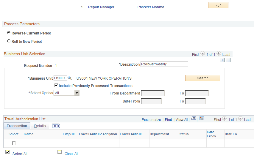

Rollover Travel Authorization Page
Use the Rollover Travel Authorization page (EX_BGTCHK_TAUTH) to select travel authorizations to roll encumbrances over to a new budget period.
Navigation:
Travel and Expenses, and then Manage Accounting, and then Rollover Travel Authorization
This example illustrates the fields and controls on the Rollover Travel Authorization page. You can find definitions for the fields and controls later on this page.
Process Parameters
Field or Control Description
Reverse Current Period
Select to reverse out encumbrances from the prior period.
Roll to New Period
Select to re-encumber funds in a new period. If this option is selected, PeopleSoft Expenses displays the Change Accounting Date To and Change Budget Date To fields.
Business Unit Selection
Description
Enter a description of the defined set of parameters.
Business Unit
Select a valid business unit.
Note: PeopleSoft Expenses lists all general ledger business units, not just the business units enabled for commitment control. This ensures that PeopleSoft Expenses retrieves all eligible travel authorizations, even when the general ledger business unit on the header record is not enabled for commitment control but the business unit on the associated distribution record is enabled.
Search
Click to retrieve transactions based on the criteria specified. If you do not enter any criteria, PeopleSoft Expenses retrieves and displays all eligible transactions.
Include Previously Processed Transactions
Select to include transactions that were previously processed for rollover.
Select Option
Select All to retrieve all eligible travel authorizations. Select Some to select by business unit, department, or date criteria.
From Department and To
Enter a value as criteria to select travel authorizations. The system retrieves all travel authorizations with department numbers that fall within the specified range in the criteria. If you leave these fields blank, the system retrieves all departments.
Select a specific department by entering a department ID in the From Department field and leaving the To field blank.
Note: The system searches on the employee's department ID as of the time you run the process, not the distribution department.
Date From and To
Enter a value as criteria to select travel authorizations. The system retrieves all travel authorizations with dates that fall within the dates specified in the criteria.
Enter a new accounting date to roll travel authorizations to. PeopleSoft Expenses displays this field only if you selected Roll to a New Period and populates the field with the system date by default. The Budget Processor process validates the accounting date against the general ledger open period. If the new fiscal year is not open, the system prevents you from rolling over the travel authorizations to the new period.
Note: PeopleSoft Expenses does not validate the date that you enter other than to ensure that the period is open. If you enter an incorrect date and run the Budget Processor process, you must run the process to reverse the entries.
Select to enable the date field, where you can enter a new budget date. PeopleSoft Expenses displays this field only if you selected Roll to a New Period and populates the budget date field with the accounting date by default. The system applies the budget date that you entered to the distribution lines for all the travel authorizations selected for the business unit. If this option is not selected, the budget date on the distribution record is unchanged.
Travel Authorization List - Transaction Tab
Select
Select individual travel authorizations to process.
Name
Displays the name of the person who requested the travel authorization.
EmplID (employee ID)
Displays the employee ID of the person who requested the travel authorization.
Travel Auth Description (travel authorization description)
Displays the description of the trip for the travel authorization. Click the link to access the travel authorization inquiry page and view information about the travel authorization.
Travel Auth ID (travel authorization ID)
Displays the travel authorization ID number. Click the link to access the travel authorization inquiry page and view information about the travel authorization.
Department
Displays the employee's department ID.
Status
Displays the current status of the travel authorization.
Date From and Date To
Displays the beginning and ending dates of the trip.
Travel Authorization List - Details Tab
Amount
Displays the total estimated cost of the trip, excluding any denied line amounts.
