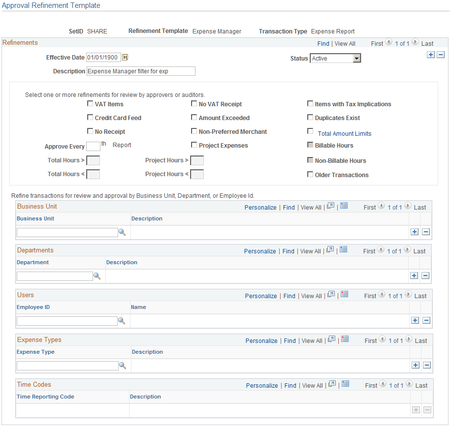

Approval Refinement Template Page
Use the Approval Refinement Template page (EX_REFINE_TMPL) to add or modify refinement templates that define, for a transaction type, the approval refinements used to filter transactions for approval.
Navigation:
  • Set Up Financials/Supply Chain, and then Product Related, and then Expenses, and then Management, and then Approval Setup, and then Refinement Template
  • Travel and Expenses, and then Travel and Exp Admin Center, and then Manage Approvals, and then Refinement Template
This example illustrates the fields and controls on the Approval Refinement Template page.
