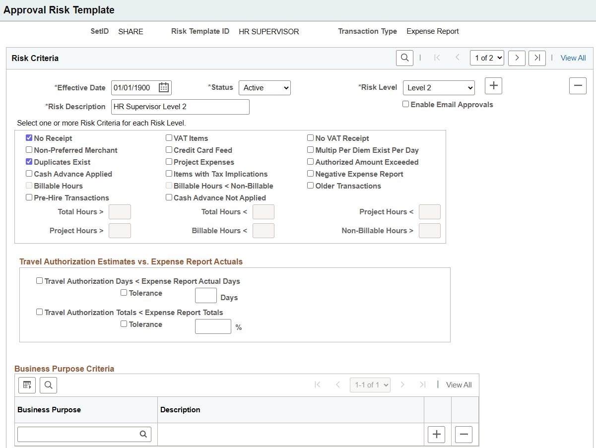

Use the Approval Risk Template page (EX_RISK_TMPL) to set up risk templates.
Navigation:
  • Set Up Financials/Supply Chain, and then Product Related, and then Expenses, and then Management, and then Approval Setup, and then Define Risk Template Details
  • Travel and Expenses, and then Travel and Exp Admin Center, and then Manage Approvals, and then Risk Template
This example illustrates the fields and controls on the Approval Risk Template page (1 of 3). You can find definitions for the fields and controls later on this page.
Approval Risk Template (1 of 3)

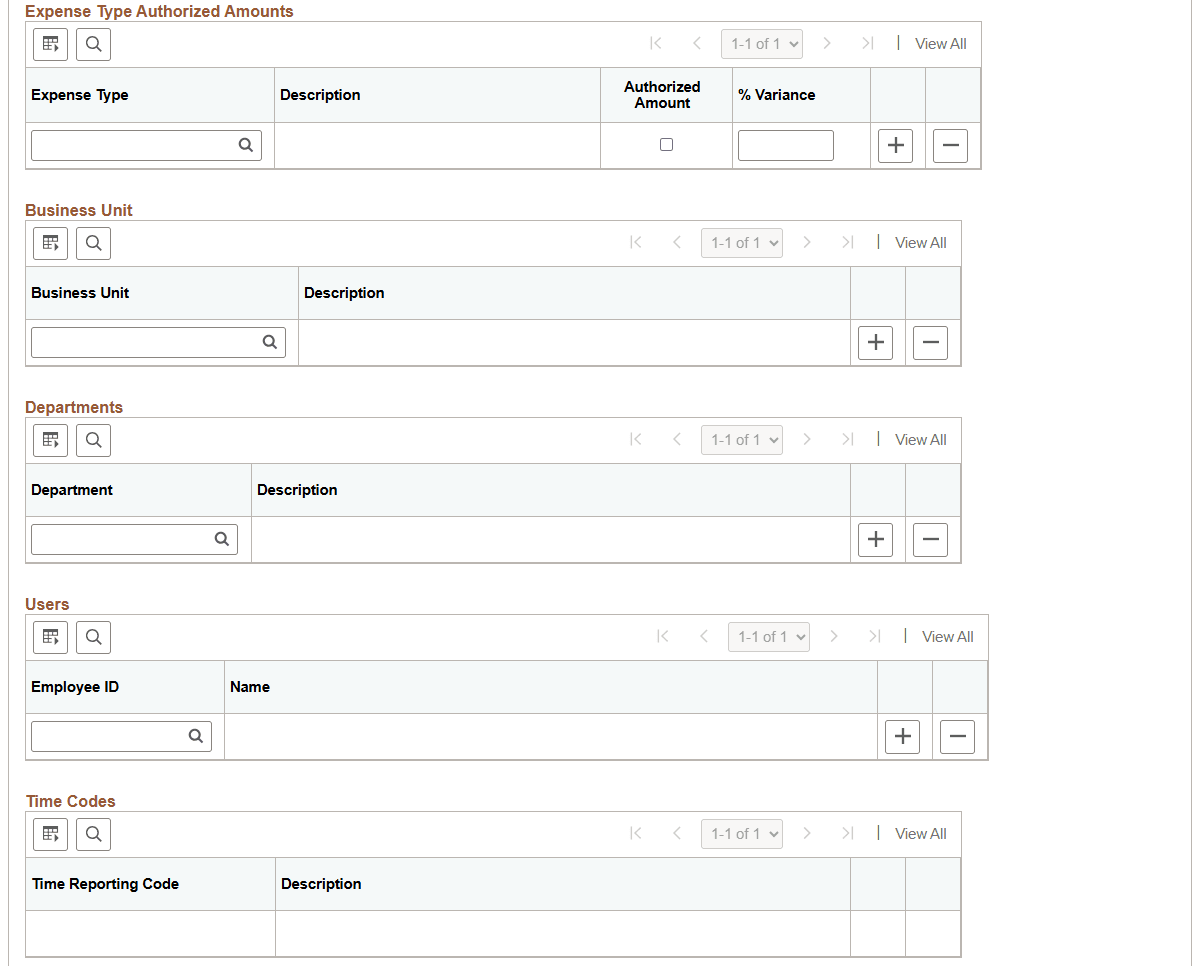

This example illustrates the fields and controls on the Approval Risk Template page (2 of 3). You can find definitions for the fields and controls later on this page.
Approval Risk Template (2 of 3)

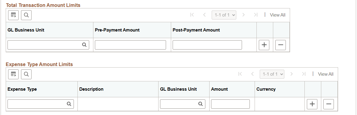

This example illustrates the fields and controls on the Approval Risk Template page (3 of 3). You can find definitions for the fields and controls later on this page.
Approval Risk Template (3 of 3)
Use this page to define up to five levels of risk for the transaction type. Risk criteria represent exceptions to company policy that can be assigned to expense transactions. When risk criteria is defined and met for more than two levels, the highest level is shown to the approver. At least one risk criteria must be defined for each risk level. You can also enable e-mail approvals for expense transactions that contain risk.
The transaction type determines the fields that are available on the page.
Risk Criteria
Field or Control Description
Risk Level
Select the level of risk for the template. Options include Level 1 through Level 5, which indicate the severity of the risk. Level 1 indicates low risk and level 5 indicates high risk.
Enable Email approvals
Select to indicate that expense approvals are routed to the approver through an e-mail, if the risk criteria is met. The e-mail includes the transaction details and approval options. Deselect to indicate that expense approvals are routed to the approver through an e-mail notification. The e-mail notification informs the approver that there is a transaction that needs to be reviewed, and provides a link to the Expenses system to approve the transaction.
Note: If this option is selected and the risk criteria is not met, then an e-mail notification is sent, regardless of this option.
No Receipt
Select to indicate risk when the employee has not provided a receipt for an expense that normally requires one.
Receipt required rule is setup in Expenses Definition – Business Unit 1 page by defining the Minimum Receipt Amount, or setup in Expenses Definition – Receipts Required page. Only when the transaction is required to provide a receipt, and employee does not provide one, the transaction is flagged as risk.
If the transaction is not required to provide a receipt according to the setup, then it will not be flagged as risk.
VAT Items
Select to indicate risk when expense reports contain expenses that have value added tax.
No VAT Receipt
Select to indicate risk when the employee has not provided a receipt for VAT expenses that requires one.
Non-Preferred Merchant
Select to indicate risk when expenses reports contain an expense item that was purchased from a merchant who is not defined as a preferred merchant for that expense type.
Credit Card Feed
Select to indicate risk when expense reports contain an expense item that originated from a credit card transaction.
Multip Per Diem Exist Per Day (multiple per diem exists per day
Select to indicate risk when expense transactions contain more than one per diem expense type for one day.
Duplicates Exist
Select to indicate risk when an expense item appears more than once in the same expense report, or where the item appears in another expense report for the same employee ID.
When employees submit expense reports, the system automatically detects duplicates by checking each line. A program extracts the expense type, transaction date, amount, and currency code fields, then looks for an expense line within the same expense report that has identical values as the extracted line. If the system finds an identical expense line, it flags the line. The program also searches for the same line in all expense reports for the employee and adds a comment to indicate that a duplicate exists.
Some duplicates are legitimate; for example, if your organization pays moving expenses for an employee and a spouse, there may be two airline tickets to the same destination on the same day for the same amount. You can still submit an expense report when it has acceptable duplicates.
Note: When the expense type has an edit type of per diem, only the expense type and the transaction date is considered when checking for duplicates.
Project Expenses
Select to indicate risk when expense reports or travel authorizations contain expense transaction lines that are charged to a project.
Authorized Amount Exceeded
Select to indicate risk when expense transactions contain an expense item that is more than the authorized expense amount or the per diem amount.
When this check box is selected in risk template, expense report that more than the defined location amount or group location limit will be indicated with risk
Cash Advance Applied
Select to indicate risk when expense reports have a cash advance that has been applied.
Items with Tax Implications
Select to indicate risk when an expense report includes reimbursements for which an employee can be taxed.
Negative Expense Report
Select to indicate risk when expense reports have a negative amount.
Billable Hours
Select to indicate risk when time reports or time adjustments contain billable hours.
Billable Hours < Non-Billable Hours (billable hours are less than non-billable hours)
Select to indicate risk when billable hours are less than non-billable hours for time reports or time adjustments.
Older Transactions
Select to indicate risk when an expense date is entered that is greater than the date specified in the Disallow Transactions Older Than number of days field on the Expenses Definition - Business Unit 2 Page.
Pre-Hire Transactions
Select to indicate risk when an employee enters an expense report that has a date prior to their hire date. The approver is alerted on the Approval Summary page and can access the Expense Report - Exception Comments and Risks page to see comments entered by the employee.
Note: this option is applicable when the Days Prior to Hire Date Allowed on Expenses field has a value that is greater than 0 (zero) on the Expenses Definition - Business Unit 2 Page.
Cash Advance Not Applied
Select to indicate that when an employee has an outstanding cash advance and that cash advance is not applied to an expense report, you want the approver to be alerted on the Pending Approvals - Expense Report Page (List) with employee comments on the Expense Report - Exception Comments and Risks page.
Note: this option is only available when the Enforce Cash Advance is selected on the Application Fundamentals: Installation Options - Expenses Page.
Total Hours > and Total Hours <
Enter total hours greater than, or total hours less than, to indicate when time reports or time adjustments have risk to the approver.
Project Hours > and Project Hours <
Enter the total project hours greater than, or total project hours less than, to indicate when time reports or time adjustments have risk to the approver.
Billable Hours < (billable hours less than)
Enter the total billable hours less than to indicate when time reports or time adjustments have risk to the approver.
Non-Billable Hours > (billable hours greater than)
Enter the total billable hours greater than to indicate time reports or time adjustments have risk to the approver.
Travel Authorization Estimates vs. Expense Report Actuals
Travel Authorization Days < Expense Report Actual Days
Select to indicate risk on expense reports where the travel authorization days is less than the actual days on the expense report.
Tolerance
Select to indicate a tolerance for expense reports where the travel authorization days is less than the actual days on the expense report. Indicate the tolerance number of days in the Days field.
Travel Authorization Totals < Expense Report Totals
Select to indicate risk on expense reports where the travel authorization total is less than the total on the expense report.
Tolerance
Select to indicate a tolerance for expense reports where the travel authorization total is less than the total on the expense report. Indicate the tolerance percent of total in the % field.
Business Purpose Criteria
Business Purpose
Select the to indicate that expense reports with this business purpose are to be considered for risk.
Expense Type Authorized Amounts
Expense Type Authorized Amounts details has an Authorized Amount check box that when selected, determines if the system checks for risk against an expense type that has a value over the amount defined in the expense location amount table. The expense location amount table is defined on the Expense Location Amount page. If the Authorized Amount check box is not selected, then the system indicates that the expense type has risk if the expense type appears in the report. There is also a % Variance option that allows a variance before the system indicates risk.
Expense Type
Select an active expense type to indicate the level of risk.
Authorized Amount
Select to indicate that the system checks for risk for the expense type if the value is over the amount defined in the expense location amount table.
% Variance
Enter a percent of variance that the system allows over the authorized amount. If the amount exceeds this variance, the system considers the report to have risk.
Business Unit
Business Unit
Select an active business unit to indicate risk.
Departments
Department
Select an active department to indicate risk.
Users
Employee ID
Select an active employee to indicate risk.
Time Codes
Time Reporting Code
Select an active time reporting code to indicate risk.
Total Transaction Amount Limits
GL Business Unit
Select an active general ledger business unit to indicate risk.
Pre-Payment Amount
Enter an amount that indicates a prepayment amount, which indicates a risk for the general ledger business unit.
Post Payment Amount
Enter an amount that indicates a post payment, which indicates a risk for the general ledger business unit.
Note: Post payment amounts do not apply to travel authorizations. Therefore, if Travel Authorization is selected in the Transaction Type field, an amount is entered into the Post Payment Amount field, and the risk template is associated with an approver profile for a post payment auditor, then you are notified that the total transaction amount limits will be ignored.
Expense Type Amount Limits
Expense Type
Select an expense type to indicate risk.
GL Business Unit
Select the general ledger business unit in which the expense type indicates risk.
Amount
Enter an amount that indicates the value of the expense type that indicates risk for the general ledger business unit.
