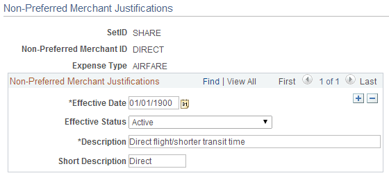

Use the Non-Preferred Merchant Justifications page (EX_NONPREFMRCH) to create justifications for expense users when using non-preferred merchants.
Navigation:
Set Up Financials/Supply Chain, and then Product Related, and then Expenses, and then Purchase, and then Non-Preferred Justification
This example illustrates the fields and controls on the Non-Preferred Merchant Justifications page.
Use this page to setup justification options that are used when creating travel authorizations using PeopleSoft Fluid pages. For additional information see, Creating Travel Authorizations Using PeopleSoft Fluid
Field or Control Description
Expense Type
Select an expense type. Options are limited to those that have expense type edits of AIR, HTL, and RTL.
