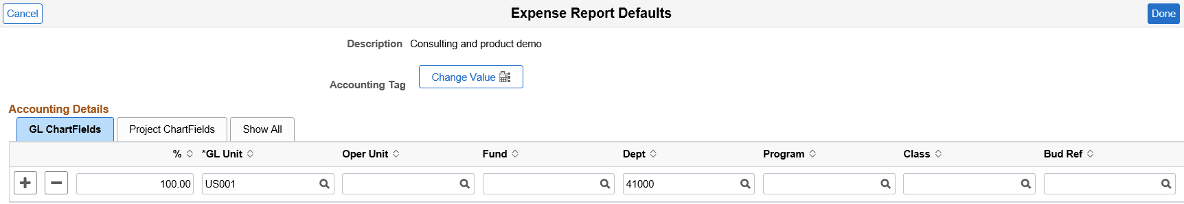

Expense Report Defaults Page
Use the Expense Report Defaults page (EX_SHEET_SPLIT_SCF) to view or edit default accounting for an expense report.
Navigation:
Employee Self Service, and then Expenses tile, and then Create Expense Report tile. Select the Accounting Defaults section on the Expense Report page.
This example illustrates the fields and controls on the Expense Report Defaults page.
The Department, Fund, Project, and Activity fields are only available for a given user if they are established for the role on the Employee Privilege Template Page. If the user does not have the proper privileges, the Accounting Default button does not appear on the Expense Report Page.
  • For Department and Fund Code to appear, the GL ChartFields privilege must be set to Modify or View.
  • For Project and Activity to appear, the PC ChartFields must be set to Modify (only if Project Costing is an installed product; if not, these fields do not appear).
Field or Control Description
Cancel
Select to cancel and not save any changes to the Expense Report Defaults.
Done
Select to save changes and return to the Expense Report page.
Accounting Tag or Change Value
Select to access the Accounting Tag Page.
The ChartFields on the Expense Report Defaults page are displayed based on the CF Display Template Options where you can define whether to display the ChartField Value only, ChartField Description only, or both. Additionally, you can determine if a ChartField is required or not by selecting from the Required Option drop down list. For more information, see Application Fundamentals: ChartField Display Template Page.
ChartFields appear only when selected on the Select GL or PC ChartFields to Display page of the Employee Privilege Template Page

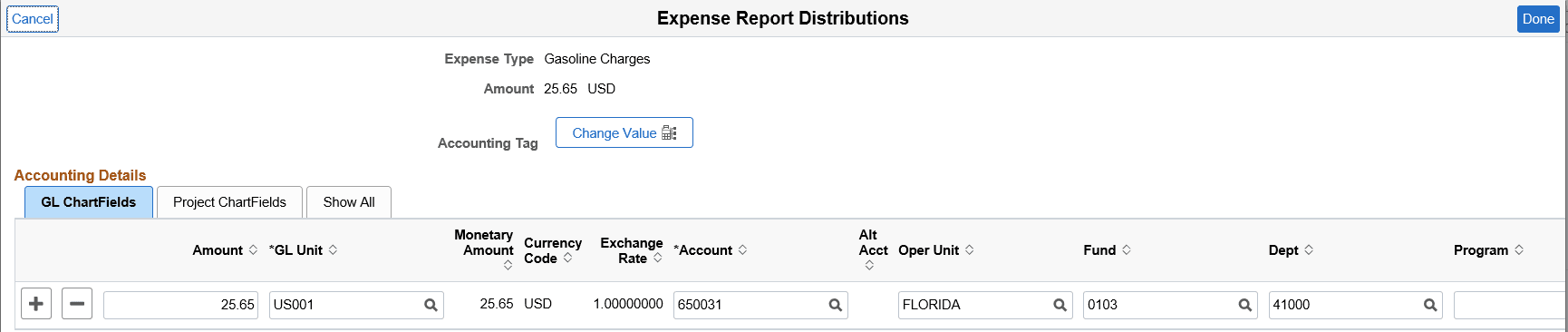

Expense Report Distributions Page
Use the Expense Report Distributions page (EX_SHEET_DIST_SCF) to view or edit accounting distribution information for an expense entry.
Navigation:
Employee Self Service, and then Expenses, and then Create Expense Report, and then Expense Details, and then Expense Entry. Click the Accounting section on the Expense Entry page.
This example illustrates the fields and controls on the Expense Report Distribution page.
The Expense Report Distributions page displays the summary information for each distribution line along with GL ChartFields, PC ChartFields, and the amount distribution.
The ChartFields on the Expense Report Accounting Distributions page are displayed based on the CF Display Template Options where you can define whether to display the ChartField Value only, ChartField Description only, or both. Additionally, you can determine if a ChartField is required or not by selecting from the Required Option drop down list. For more information, see ChartField Display Template Page.
Accounting Tags
Change Value
This button is only available when Expenses is selected on the Application Fundamentals: Accounting Tag Registration Page.
For more information about Accounting Tags, see Application Fundamentals: Setting Up Accounting Tags

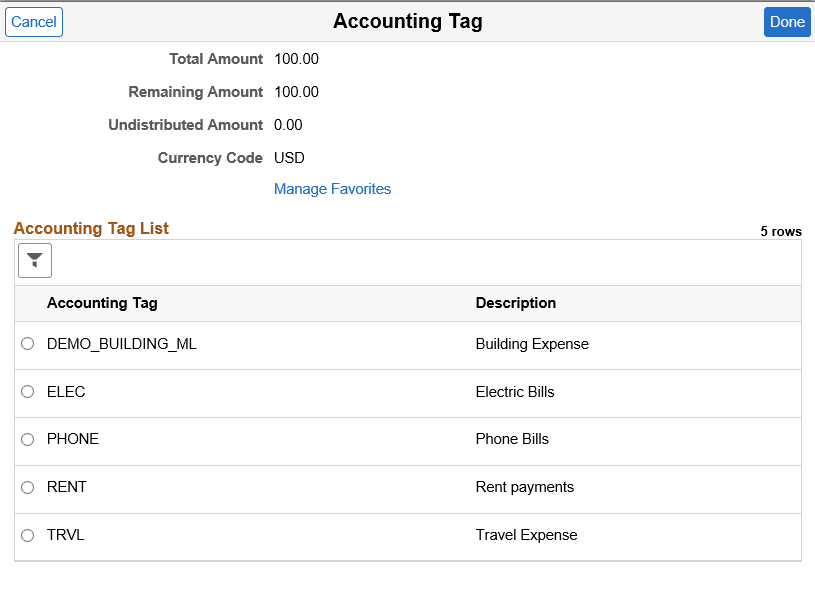

Accounting Tag Page
Use the Accounting Tag (ACCTG_TAG_SEL_SCF) page to select an Accounting Tag to distribute the expense amount and populate ChartFields.
Navigation:
From the Expense Report Distributions page select the Change Value button.
This example illustrates the fields and controls on the Accounting Tag page.
Accounting Tag
Select an accounting tag to distribute the expense amount and populate ChartFields based on the Application Fundamentals: Accounting Tags - ChartFields Page.
Manage Favorites
Select this link to access the Manage Favorites Page.

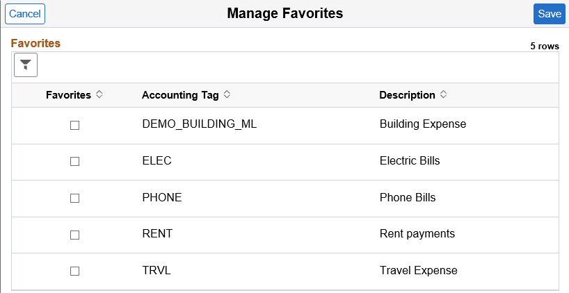

Use the Manage Favorites (TAG_FAV_SEL_SCF) page to select the Accounting Tags that you want to appear on the Accounting Tag page.
Navigation:
From the Accounting Tag page select the Manage Favorites link.
This example illustrates the fields and controls on the Manage Favorites page.
Manage Favorites
