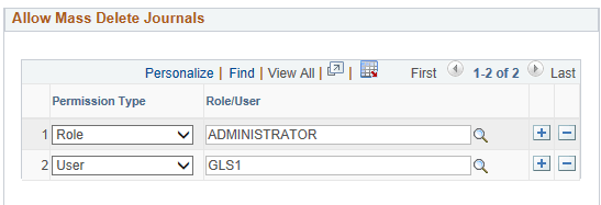

Allow Mass Delete Journals Page
Use the Allow Mass Delete Journals page (WC_JRNL_DEL_ACCESS) to set up security to delete journals in mass by Role and Permission Type.
Navigation:
Set Up Financials/Supply Chain, and then Security, and then Mass Delete Journals Security
This example illustrates the fields and controls on the Allow Mass Delete Journals page.
If a User ID, or a User Role associated with a User ID, has been given access on the Allow Mass Delete Journals page, then when they access the Mass Delete Journals page, they see all journals created by all users and can delete those journals .
If a User ID, or a User Role associated with a User ID, has not been given access on the Allow Mass Delete Journals page, then when the access the Mass Delete Journals page, they only see the journals that they created and can only delete their those journals.
In the page shot above, User GLS1 and Role Administrator have been given access.
  • If user GLS1 logs into the system and accesses the Mass Delete Journals page, then the system displays journals created by all users, such as GLS1, VP1, and so on.
    User GLS1 can delete all of these journals using the Mass Delete Journals page.
  • If user GLS2 logs into the system and accesses the Mass Delete Journals page, then the system displays only journals created by user GLS2.
    User GLS2 can only delete journals they created on the Mass Delete Journals page.
  • If user VP1 logs into the system (VP1 is assigned to the Administrator role) and accesses Mass Delete Journals page, then the system displays journals created by all users, such as GLS1, GLS2, and so on.
    User VP1 can delete all of these journals on the Mass Delete Journals page.

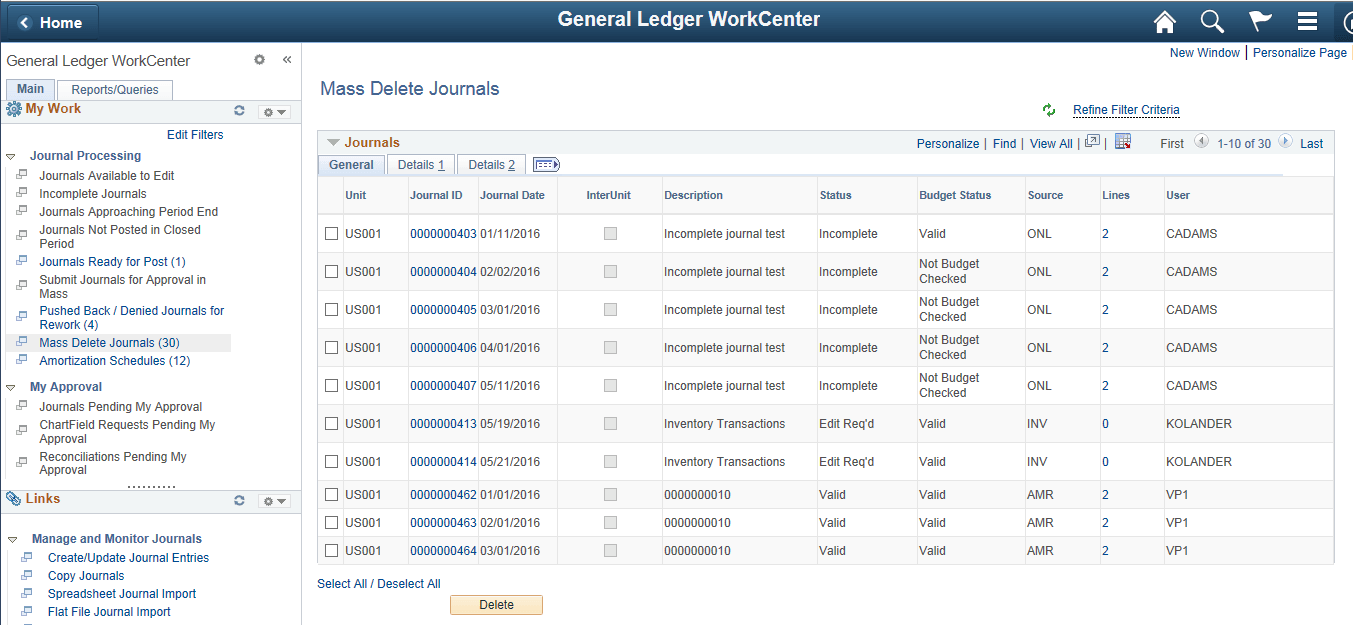

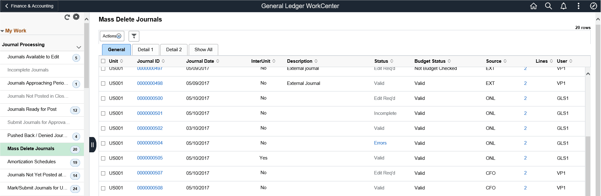

General Ledger WorkCenter - Mass Delete Journals Page (Fluid)
Use the Mass Delete Journals page (Fluid) (GL_WC_JRNLD_FL) to delete anchor journals in mass using the Fluid GL WorkCenter.
Navigation:
GL WorkCenter tile, and then Mass Delete Journals
This example illustrates the fields and controls on the General Ledger WorkCenter - Mass Delete Journals Page (Fluid). You can find definitions for the fields and controls later on this page.
Field or Control Description
Journal ID
Select to open the Journal Entry - Lines window (JOURNAL_ENTRY_IE).
Lines
Select to open Lines window (GLWC_JRNLD_LN_SCF) that displays more detail for each line.
Actions
Select one of the following Actions:
  • Delete — Selected journals will be deleted.
  • Email Notification — Select journals to send email notification to notify intended users about the journal deletion.

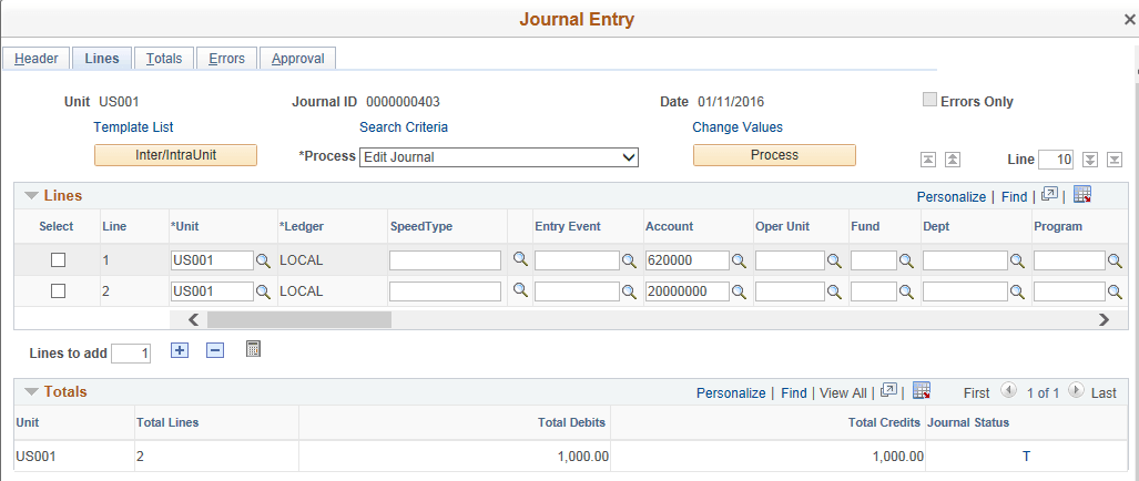

Mass Delete Journals - Journal Entry Page (Fluid)
Use the Mass Delete Journals - Journal Entry page (Fluid) to view line information in the Classic user interface.
This example illustrates the fields and controls on the Mass Delete Journals - Journal Entry page (Fluid).

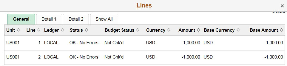

Mass Delete Journals - Lines Page (Fluid)
Use the Mass Delete Journals - Lines page (Fluid) to view line information in the Fluid user interface.
This example illustrates the fields and controls on the Mass Delete Journals - Lines Page (Fluid).

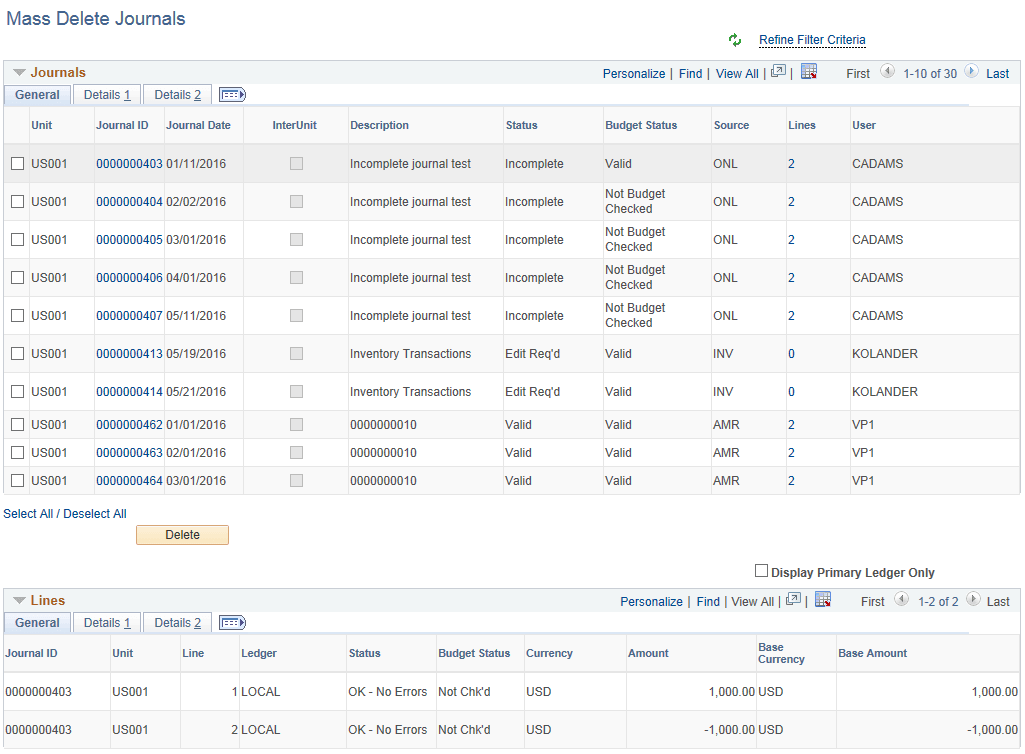

General Ledger WorkCenter - Mass Delete Journals page (Classic)
Use the Mass Delete Journals page (GL_WC_JRNLD) to delete anchor journals in mass using the Classic GL WorkCenter.
Navigation:
General Ledger, and then GL WorkCenter, and then Mass Delete Journals
This example illustrates the fields and controls on the General Ledger WorkCenter - Mass Delete Journals page (Classic).
When an anchor journal is deleted, all journal lines are deleted.
InterUnit
Displays as selected if it is an InterUnit journal. This check box is display only.
Status
Select this link to display journal error information in the Header Error and Line grid. Only lines with errors are displayed in the lines grid. this link is only available when the journal has errors.
Lines
Select this link to access the journal lines. Journal lines appear in the line grid.
Note:The total lines values may not reflect the actual number of lines displayed in the grid. For example, the total lines field might be zero for copied or imported journals that are not edited.
Header Errors Section
The Header Errors section displays when you select an Error link in the Status column. If there are no header errors, the section is hidden.
Lines Section
The Lines section displays below the Journals section when you select a link in the Lines column. It displays all journal line information.
This example illustrates the fields and controls on the Mass Delete Journals and Lines page (Classic).

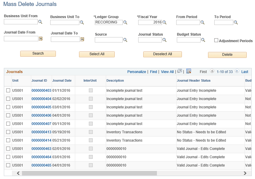

Mass Delete Journals Page (Navigator)
Use the Mass Delete Journals page (GL_MASS_JRNL_DEL) to delete anchor journals in mass from traditional navigation. When accessing the page using the navigator, filter fields are displayed.
Navigation:
General Ledger, and then Journals, and then Process Journals, and then Delete Journals in Mass
This example illustrates the fields and controls on the Mass Delete Journals Page (Navigator).
Mass Delete Journals (using navigation) page
