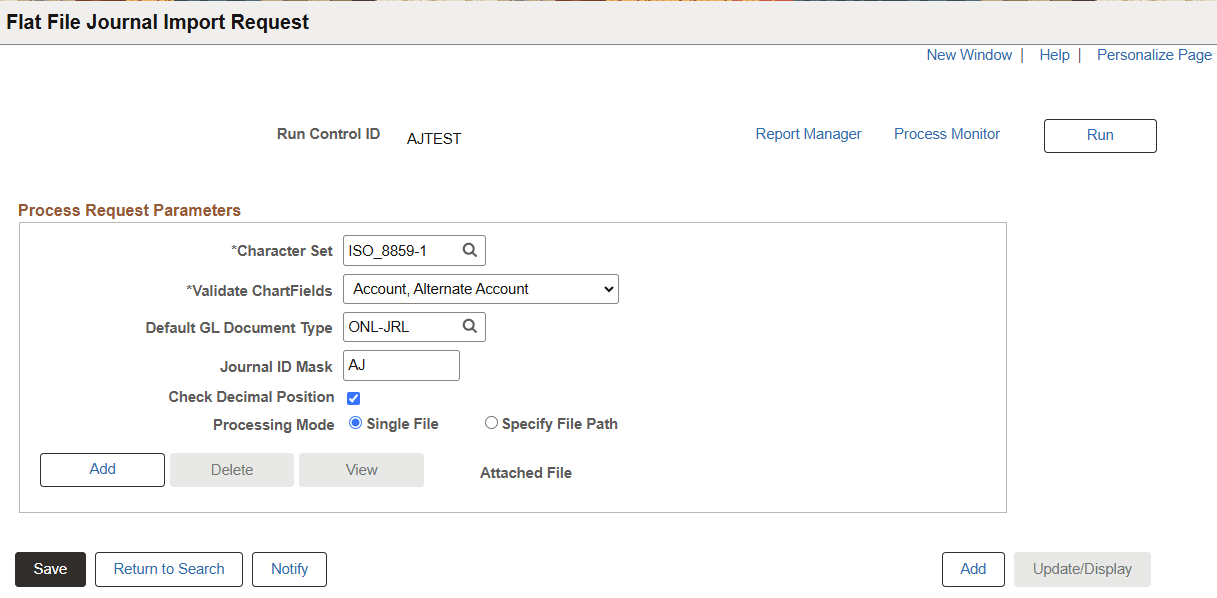

Using the Flat File Journal Import Process
Journal entries loaded to your system using flat file journal import must be edited using batch edit only. This is important because, imported journals do not yet have all journal lines and values populated by the various automatic features associated with batch edit. Imported journals should not be edited online. After importing journals, if you open them online you get a warning message stating that they must be edited first. It is only after the batch edit that the journals display the final entries for such things as interunit journals, separate debit credit reversals, and multibook lines.
Page Used to Import Journals from Flat Files
Flat File Journal Import Request Page
LOAD_JRNL_PNL
Use the Load Journals From a Flat File process (GL_JRNL_IMP) to load data from a flat file into the General Ledger journal tables.
Use the Flat File Journal Import Request page (LOAD_JRNL_PNL) to launch the Load Journals From a Flat File process (GL_JRNL_IMP) ; this process loads data from a flat file into the General Ledger journal tables.
Navigation:
General Ledger, and then Journals, and then Import Journals, and then Import Flat File Journals, and then Flat File Journal Import Request
This example illustrates the fields and controls on the Flat File Journal Import Request page. You can find definitions for the fields and controls later on this page.
When running this process, if the user or user role does not have access to the business unit, source, or both, then the journal is not created for that business unit and source.
See Enabling Journal Source Security.
Field or Control Description
Character Set
Select the appropriate character set for the flat file being processed. When you create a request, the character set changes to the character set that is associated with the default language code of the user that is creating the run control request. You can change this value, but you must have a UNICODE database if the character set of the file being processed requires UNICODE.
UNICODE is important when your database must function in other than the Latin alphabet, such as Japanese Kanji.
Validate ChartFields
Select the level of ChartField validation for the import process:
  • Account, Alternate Account
  • All Common ChartFields
  • None
    Note: When you select None, the process does not check for invalid Account and AltAcct values; however, invalid Control Account and Control AltAcct values will fail.
A lower validation level enables you to run the import process faster and make use of journal suspense processing when Journal Edit revalidates the journal at a later stage.
Note: Selecting All Common ChartFields does not validate PeopleSoft Project Costing specific ChartFields.
Default GL Document Type
If you use document sequencing, specify a default document type to indicate the business purpose for the transaction. You can specify a document type for each journal header in the flat file.
Journal ID Mask
Enter a unique mask or prefix to identify journals created through flat file journal import, if the journal ID is blank or NEXT in the file.
Check Decimal Position
Select this option to validate decimal position. If selected, the Flat File Journal Batch import process checks the decimal position of Amount values for journals to be imported and logs a message that provides details of journals with invalid decimal positions.
Invalid decimal positions can occur when the decimal position for a given currency is set at two positions, for example, but the flat file that is being imported allows up to three or four decimal positions. This option allows you to correct the discrepancy before importing the journal to PeopleSoft General Ledger.
Processing Mode
Select an option for processing:
  • Single File - select to process a single file.
    Selecting this option displays the Add button and the Attached File field. The attached file is uploaded to the system and then processed.
  • Specify File Path - select to process multiple files in batch mode.
    Selecting this option displays the File Location field. The files are not uploaded to the system. Instead, the files are processed from the source file path that matches the file pattern specified on the run control page. After processing, the files are archived in the folder specified in the Archive File URL with a date and time stamp added to the end of the file name.
Select the Add button to attach the file you wish to process. This field is only displayed when Single File is selected in the Processing Mode field.
File Location
Select the path that holds the files you wish to process. Use the * symbol (*.*.txt, filetest*.txt) to use as a wild card. A file pattern with a wildcard can also be used to process the files.
This field is only displayed when Specify File Path is selected in the Processing Mode field.
When the file is imported successfully, the imported files are moved from the source path to the archive path specified on the URL Maintenance page for the GL_JRNL_IMP_ARCHIVE URL Identifier.
The files are processed in parallel. The system creates the same number of jobs on the Process Scheduler as the number of files being processed, which is based on the file pattern specified on the Run Control Page. The parent process status is derived from all jobs created. When all process jobs are complete, all logs are consolidated into the parent instance log.
