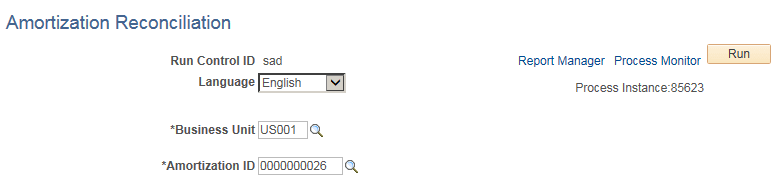

Amortization Reconciliation Report
Amortization Reconciliation reports are generated by specifying the run parameters – Amortization ID and the business unit. The AMR_RECON_REQ component is used to generate the Amortization Reconciliation GLX90001 report while the Process Scheduler manages the processes, tracks the status, and generates the report.

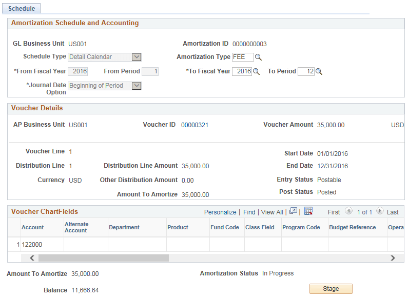

Amortization Schedule Page
Use the Amortization Schedule page (AMR_SCHED_ACT) to validate the values passed from the amortization voucher, create stage journals, review and approve the schedule.
Navigation:
General Ledger, and then Journals, and then Pre-Amortization Journals, and then Amortization Schedule
This example illustrates the fields and controls on the Amortization Schedule page. You can find definitions for the fields and controls later on this page.
Amortization Schedule page 1 of 2
Amortization Schedule page 2 of 2
This page appears as read-only until the voucher is posted. Once the voucher is posted, you can update the following fields:
  • Schedule Type
  • Amortization Type
  • From Fiscal Year
  • From Period
  • To Fiscal Year
  • To Period
  • Journal Date Option
Details that are passed from the payables amortization voucher cannot be modified on this page (GL business unit, Amortization ID, Voucher details and Voucher ChartFields)
Field or Control Description
GL Business Unit
Displays the GL business unit in the amortization voucher distribution line
Amortization ID
Displays the amortization ID that was generated by the system at the time of voucher save in AP.
Schedule Type
Select the type to be used for the amortization schedule:
  • Detail Calendar: You can select the From/To Fiscal Year and periods based on the detail Calendar ID selected for the Journal Generator default ledger group.
  • Quarterly Calendar: You can select the From/To Fiscal Year and periods based on the Quarterly summary calendar selected for the Journal Generator default ledger group.
  • Annual Calendar: You can select the From/To Fiscal Year and periods based on the Annual summary calendar selected for the journal generator default ledger group.
See Application Fundamentals: Ledgers For A Unit - Definition Page
This field is not editable after the first actual journal is created.
Note:The Quarterly Calendar and Annual Calendar options are available only if these values are associated with the Journal Generator default ledger group on the Ledgers For A Unit page.
From Fiscal Year
Enter the starting year to be used for creating the schedules.
From Period
Enter the starting range of the period to be used for creating the schedules. This field is not available when the Schedule Type is Annual Calendar.
To Fiscal Year
Enter the ending year to be used for creating the schedules.
To Period
Enter the ending range of the period to be used for creating the schedules. This field is not available when the Schedule Type is Annual Calendar.
Journal Date Option
Displays the journal date option:
  • Beginning of period
  • End of period
This option changes to display only once the first actual journal is created.
AP Business Unit
Displays the AP business unit used in the amortization distribution line.
Voucher ID
Click the link to open the Voucher component — PeopleSoft Payables: Voucher - Summary Page.
Voucher Amount
Displays the total voucher amount.
Voucher Line
Displays the voucher line number of the amortization voucher.
Distribution Line
Displays the distribution line number the amortization voucher.
Distribution Line Amount
Displays the merchandise amount for the specific distribution line.
Start Date and End Date
Displays the default start and end date passed from the amortization voucher distribution line. The first time when the page is loaded, the From/To Fiscal Year/Period values are derived based on the start and end date. The finance user however can override and change the From/To Fiscal Year/Period.
Note:The calculation of stage journals is based only on the From/To Fiscal Year/Period and NOT on the Start/End date.
Other Distribution Amount
Displays the non-merchandise amount associated to the specific distribution line.
Amount to Amortize
Displays the sum of the distribution line amount and the other distribution amount.
Voucher ChartFields are displayed from the distribution line of the amortization voucher.
Balance
Displays the balance amount yet to be amortized. This field gets updated as the actual journals are created.
Amortization Status
Displays the amortization status values:
  • Pending: Initial status of the amortization
  • In progress: Stage journals are created
  • Completed: All Actual journals are created
  • Cancelled: Amortization schedule is cancelled
Stage
Initiate the stage journal creation process. See Amortization Journal – Stage Journal Page

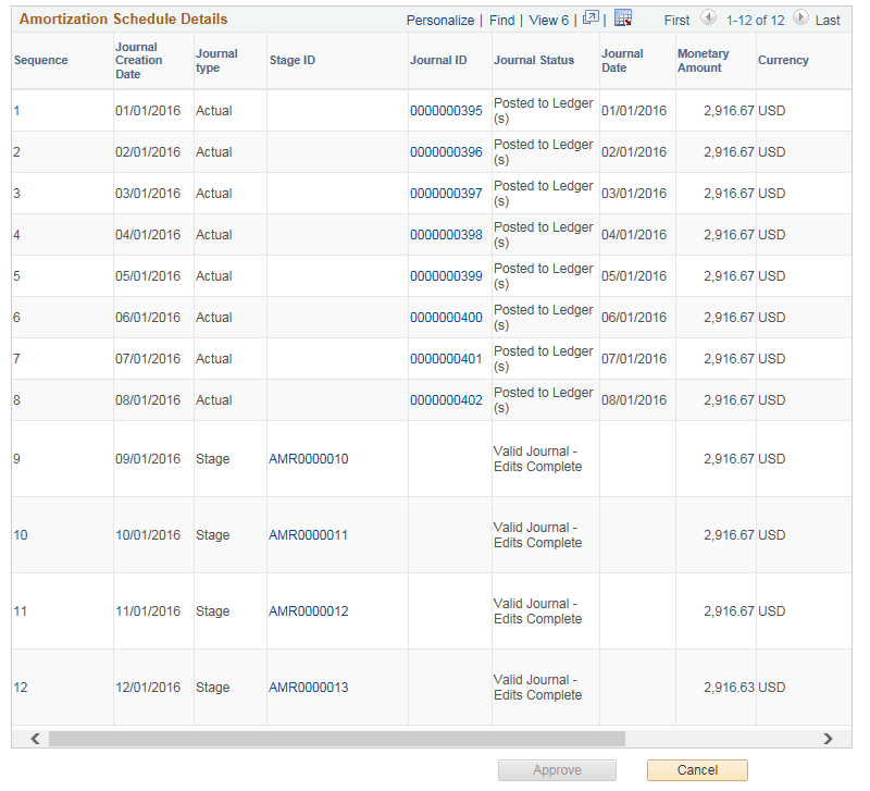

Amortization Schedule Details
Sequence
Displays the sequence in which the journals are created.
Journal Creation Date
Displays the expected date of the Actual journal creation.
Journal Type
Displays the type of journal - Stage Journal or Actual Journal.
Stage ID
Click the link to access the Stage Journal page and update ChartFields .
Note:Only users with the Update Amortization Journal ChartField Values enabled on the Application Fundamentals: User Preferences - General Ledger Page can update ChartFields.
Journal ID
Click the link to access the Journal Entry – Lines page.
Journal Status
Displays the status of the journal based on the journal type - Stage or Actual.
For a Stage journal:
  • Edit Required
  • Valid Journal – Edits Complete
  • Error
For an Actual journal:
  • Edit Required
  • Error
  • Posted to Ledger (s)
Journal Date
Displays the actual journal date.
Monetary Amount
Displays the journal monetary amount calculated based on the number of journals created.
Schedule Status
Displays the schedule status as:
  • Pending: Initial status of the schedule
  • Ready: Schedule is approved
  • Completed: Actual journal is created
Actions
Allows you to initiate related actions based on the type of the journal row. For a Stage journal, the only action available is Edit.
  • Audit Logs: Click to open the GL Audit Log page (available only if auditing in enabled).
  • Edit: Click to edit the journal.
  • Post: Click to post the journal.
There will be no actions available if the journal is in Posted status. If an Actual journal is not posted and its status is Valid then only the Edit and Post actions will be available. In case if the user is not able to run the Post action from the Amortization Schedule page, it is recommended to use the Journal Entry page to run the Post process and correct any related errors.
Approve
Review all the newly created stage journals and click this button to approve all the lines for the schedule. If one of the journals is in error or is in Edit Required status, the schedule approval is not allowed.
Cancel
Click to cancel the amortization schedule. Status of all stage journals changes to Cancelled and are not selected for further processing. Any Actual journals created remain unchanged.

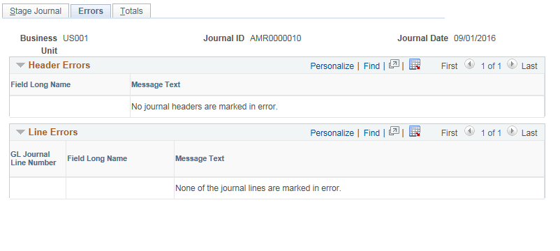

Amortization Journal – Errors Page
Use the Amortization Journal – Errors page (AMR_ENTRY_E_IC) to Review the amortization stage journal header and line errors.
Navigation:
General Ledger, and then Journals, and then Pre-Amortization Journals, and then View Staged Amortization Jrnl. Click the Errors tab.
This example illustrates the fields and controls on the Amortization Journal – Errors page.
Amortization Journal - Errors page

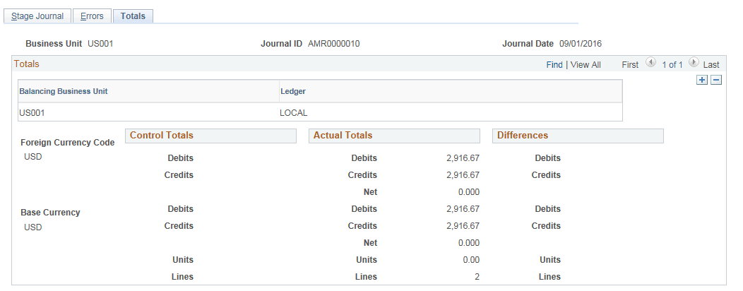

Amortization Journal – Totals Page
Use the Amortization Journal – Totals page (AMR_ENTRY_T_IC) to review the stage journal totals.
Navigation:
General Ledger, and then Journals, and then Pre-Amortization Journals. Click the Totals tab
This example illustrates the fields and controls on the Amortization Journal – Totals page.
Amortization Journal - Totals page

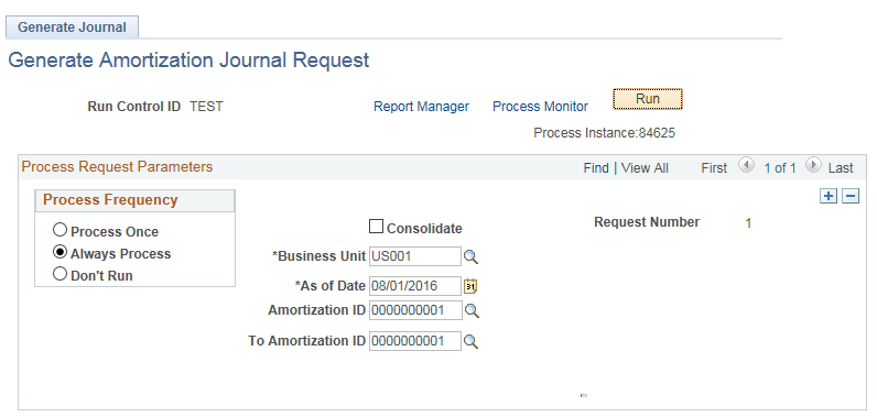

Generate Amortization Journal Request Page
Use the Generate Amortization Journal Request page (AMR_JGEN_REQUEST) to run the Amortization Journal Creation process for a given amortization ID or for a range of amortization IDs. You can also create consolidated journals for a given BU and as of date.
Navigation:
General Ledger, and then Journals, and then Pre-Amortization Journals, and then Generate Amortization Journals.
This example illustrates the fields and controls on the Generate Amortization Journal Request page. You can find definitions for the fields and controls later on this page.
The AMR_JRNL_GEN processes only stage journals with schedule status Ready and journal creation date less than or equal to the As of Date.
Consolidate
Select if you want to consolidate all the stage journals that share a common journal creation date into a single journal for a given GL Business Unit.
Note:Due to the Consolidate option available while creating amortization journals, Unposting of amortization journals is not allowed.
Example 13-1 Consolidation of Stage Journals
Here is an example to show the consolidation of two stage journals into a single journal. Two amortization IDs that have two stage journals sharing the same journal creation date:

Amortization Reconciliation Page
Use the Amortization Reconciliation page (AMR_RECON_REQ) to generate the Amortization Reconciliation report.
Navigation:
General Ledger, and then Journals, and then Pre-Amortization Journals, and then Create Amortization Recon Rpt.
This example illustrates the fields and controls on the Amortization Reconciliation page. You can find definitions for the fields and controls later on this page.
Run
Click to generate the Amortization Reconciliation (GLX9001) containing the specified business unit and amortization ID. This report includes the details of the Amortization ID, Business Unit, Amortization Type, Amount, Voucher details, along with a detailed information of all the amortization schedules.
Click the Process Monitor link to view the process status. Click the Report Manager link to access the completed report.
If Consolidate option is used to create the amortization journals then the report will contain details of the all consolidated amortization IDs. The description column can be used to identify the amortization ID.
