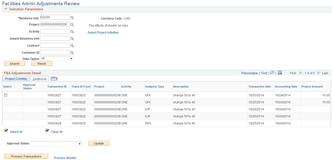

Facilities Admin Adjustments Review Page
GM_RFA_REVIEW
Review generated F&A adjustment transactions and post the approved transactions to the Grants, Contracts, and Project Costing tables.

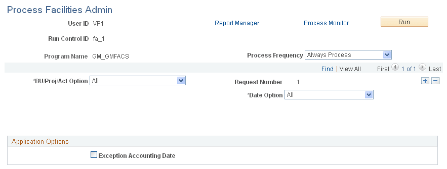

Use the Process Facilities Admin (process facilities administration) page (RUN_GM_FA) to process F&A costs.
Navigation:
Grants, and then Awards, and then Process Facilities Admin
This example illustrates the fields and controls on the Process Facilities Admin page. You can find definitions for the fields and controls later on this page.
Here is how the system processes F&A information from this page:
  • This run control page triggers a PeopleSoft Process Scheduler request. You can process the F&A using the All value in the Date Option field.
  • You can automate this request to run at certain times, such as on the 15th of every month; however, you must coordinate running this process with running other processes in your financials systems.
  • No upper limit is made to F&A amounts in PeopleSoft Grants; the budget checking process ascertains whether you have the funds, and that is the only validation.
  • After you run the F&A process in PeopleSoft Grants, run the Journal Generator to send sponsor F&A, its offsets, and any due to and due from lines to PeopleSoft General Ledger.
  • When the lines are in PeopleSoft General Ledger, you need to edit them and post them to a ledger.
Field or Control Description
Exception Accounting Date
Select to specify an accounting date other than the current date for F&A processing. When you select this option, a field appears in which you can select a date. The system assigns the date that you specify to all F&A lines created from this run control page.

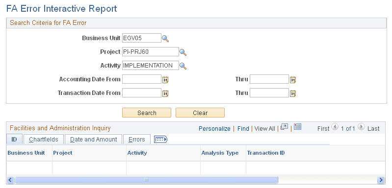

FA Error Interactive Report Page
Use the FA Error Interactive Report (facilities administration error interactive report) page (GM_FA_INQ) to display information about F&A errors.
Navigation:
Grants, and then Awards, and then F&A Error Report
This example illustrates the fields and controls on the FA Error Interactive Report page. You can find definitions for the fields and controls later on this page.
Use the fields appearing in the Search Criteria for FA Error group box to search for errors in the F&A process. Click Search.
If errors occur during the F&A process for a particular business unit, project, or activity, it displays the information in the Facilities and Administration Inquiry group box.
Select the ID tab to view the business unit, project, activity, analysis type, and transaction ID.
Select the Chartfields tab to view the GL business unit, department, account, operating unit, fund, program, class, budget reference, product, affiliate, fund affiliate, and operating unit affiliate where the error occurred.
Select the Date and Amount tab to view the transaction date, accounting date, and amount. To view the budget status and error status, select the Errors tab.
Select the Errors tab to view the status of the error and the process instance to use to research the error that occurred when the Process Facilities Admin process was run.

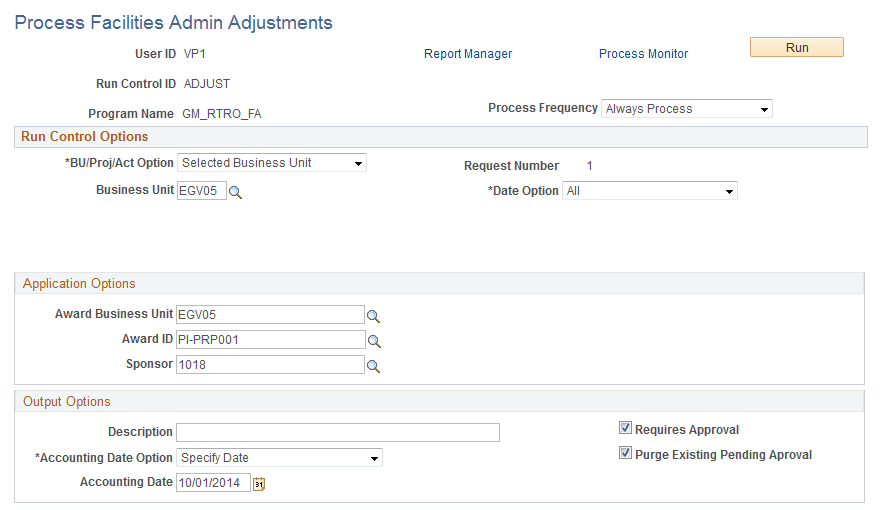

Process Facilities Admin Adjustments Page
Use the Process Facilities Admin Adjustments page (RUN_GM_RTRO_FA) to generate F&A adjustment transactions.
Navigation:
Grants, and then Awards, and then Process Retroactive F&A, and then Process Facilities Admin Adjustments
Use the Run button to automatically generate F&A adjustment transactions based on the selection criteria you define on this page:
  • If you selected the Requires Approval option, the adjustment transactions are sent to the GM_RFA_STAGE_PR staging table for review and approval using the Facilities Admin Adjustments Review page. If you did not select the Requires Approval option, the adjustment transactions post directly to the Grants, Contracts, and Project Costing tables.
  • If you selected the Requires Approval option to load adjustment transactions into the GM_RFA_STAGE_PR staging table, the RUN_GM_RTRO_FA process deletes any matching transactions already stored in the staging table. In other words, the process will not allow duplicate transactions to be generated and deletes any matching transactions from the staging table.
  • Whether the adjustment transactions are posted directly to the permanent tables or the staging table, they are first processed through Commitment Control and checked against control budgets (when Commitment Control is enabled for Grants and Project Costing).
Application Options
Use the fields in the Application Options group box to identify specific transactions for which you want to recalculate F&A costs and generate adjustment transactions.
Output Options
The Description, Accounting Date Option, and Accounting Date fields in the Output Options group box enable you to define display attributes for the adjustment transactions. The values you enter for these fields are stamped on the final adjustment transactions. If you leave these fields empty, the adjustment transactions use the description from the original source transaction.
Select the Requires Approval option to require that the adjustment transactions are sent to the GM_RFA_STAGE_PR staging table for review and approval using the Facilities Admin Adjustments Review page. If you select this option, the transactions will not immediately post to the Grants, Contracts, and Project Costing tables.
Select the Purge Existing Pending Approval option to delete all transactions in the staging table (GM_RFA_STAGE_PR).
Use the Facilities Admin Adjustments Review page (GM_RFA_REVIEW) to review F&A adjustment transactions and post the approved transactions to the Grants, Contracts, and Project Costing tables.
Navigation:
Grants, and then Awards, and then Review Retroactive F&A, and then Facilities Admin Adjustments Review
This page enables you to review generated F&A adjustment transactions stored in the GM_RFA_STAGE_PR staging table, mark transactions as Approved or Delete, and insert approved transactions into permanent Grants, Contracts, and Project Costing tables.
Use the Business Unit, Project, Activity, Award Business Unit, Contract, Customer ID, and Data Option fields to search for specific adjustment transactions. You can also use the Select Project Activities link as a component of your search criteria.
After inputting your search criteria, click the Search button to have search results appear in the F&A Adjustments Detail group box.
Use the Project Costing and Additional tabs in the F&A Adjustments Detail group box to review the F&A adjustment transactions:
  • Only sponsor F&A transactions are selectable, non sponsor transactions cannot be selected.
  • Select a transaction to set its approval status to Approved or Delete.
  • Non sponsor F&A transactions that are related to the sponsor F&A transaction inherit the approval status of the sponsor F&A transaction.
    Related transactions are those that share the same ‘RESOURCE_ID_FROM’ value.
Select an approval status for the F&A adjustment transactions. You can choose from:
  • Approved: Transactions marked approved are eligible for insertion into permanent Grants, Contracts, and Project Costing tables.
  • Delete: Transactions marked ‘delete’ are eligible for deletion from the GM_RFA_STAGE_PR staging table, pending the successful completion of commitment control reversal (when Commitment Control is enabled for Grants and Project Costing). If the transaction fails commitment control reversal, it remains in the staging table with a delete status. In order for the transaction to be deleted, you must first complete the reversal through commitment control. If Commitment Control is not enabled, transactions marked ‘delete’ are immediately deleted from the staging table when you process the transactions.
Use the Update button to apply an approval status to the selected transaction and its related transactions.
Use the Process Transactions button to move approved transactions from the staging table to the permanent tables and delete those transactions marked as such from the staging table. The Process Transactions button calls the GM_RTRO_FA process.
