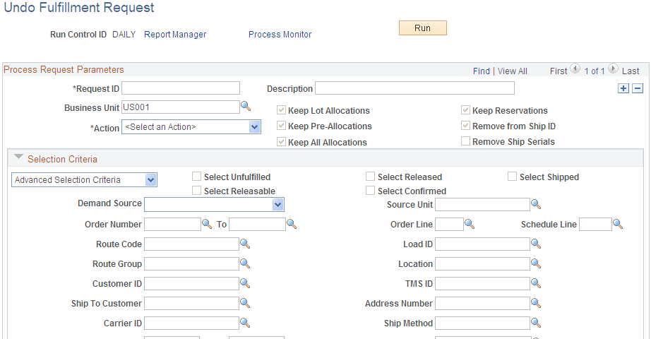

Undo Fulfillment Request Page
Use the Undo Fulfillment Request page (RUN_IN_FULFILL_UND) to use this process to move one or more demand lines to any previous fulfillment state.
Navigation:
Inventory, and then Fulfill Stock Orders, and then Undo Fulfillment Request

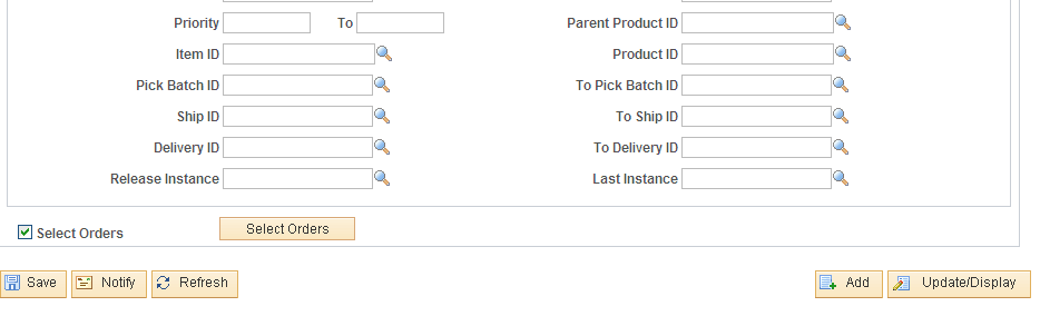

This example illustrates the fields and controls on the Undo Fulfillment Request process page (1 or 2). You can find definitions for the fields and controls later on this page.
This example illustrates the fields and controls on the Undo Fulfillment Request process page (2 or 2). You can find definitions for the fields and controls later on this page.
The Undo Fulfillment Request process page (2 or 2)

Field or Control Description
Business Unit
Enter the PeopleSoft Inventory business unit containing the demand lines that you want to move to an earlier fulfillment state.
Action
Select the action to return demand lines to a previous fulfillment state. The actions include:
  • Return to Unfulfilled: Return the selected demand lines to the Unfulfilled fulfillment state. This action can only be used by demand lines in the Releasable, Released, Confirmed, and Shipped fulfillment states.
  • Return to Releasable: Return the selected demand lines to the Releasable fulfillment state. This action can only be used by demand lines in the Released, Confirmed, and Shipped fulfillment states.
  • Return to Released: Return the selected demand lines to the Released fulfillment state. This action can only be used by demand lines in the Confirmed and Shipped fulfillment states.
  • Return to Confirmed: Return the selected demand lines to the Confirmed fulfillment state. This action can only be used by demand lines in the Shipped fulfillment state.
Keep Lot Allocations
Select this check box to keep the lot allocations, if any, on the demand lines when using the Actions of Return to Releasable or Return to Unfulfilled.
Keep Pre-Allocations
Select this check box to keep the pre-allocations, if any, on the demand lines when using the Actions of Return to Releasable or Return to Unfulfilled.
Keep All Allocations
Select this check box to keep pre-allocations, lot allocations, and standard allocations, if any, on the demand lines when using the Actions of Return to Releasable or Return to Unfulfilled. Standard allocations are changed to pre-allocations in this process.
Keep Reservations
Select this check box to keep the reservation, if any, on the demand lines when using the Action of Return to Unfulfilled.
Remove from Ship ID
Select this check box to remove the demand lines from the shipping ID.
Remove Ship Serials
Select this check box to remove the ship serial ID assigned to the item on the demand line.
Selection Criteria
Use this group box to enter the criteria that this process uses to select the demand lines. A warning message displays if no selection criteria are entered since this can result in a larger group of demand lines that you desire.
Work Orders from PeopleSoft Maintenance Management are not selected by the Undo Fulfillment process.

Select Orders
The Order Release Selection group box can limit your selection to a subset of the orders meeting the selection criteria. Click the Select Orders button to retrieve all orders that match the search criteria entered above on this Undo Fulfillment Request process page, then you can select individual orders to be processed. Click the Order No link to access detailed information for each order displayed in this group box; only demand lines that meet the selection criteria are displayed on this detailed page.
When you save this process page after selecting individual orders in the Order Release Selection group box, the Undo Fulfillment run control will process only the available demand lines of these individual orders. If you do not select individual orders in the Order Release Selection group box, the run control processes all demand lines that meet the selection criteria above.
You have the flexibility to exit and reenter the Undo Fulfillment Request process page without reselecting orders. When you click the Select Orders button, the system retrieves any previously selected orders in addition to those matching the current search criteria.
